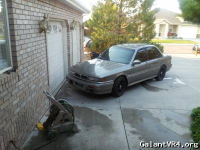

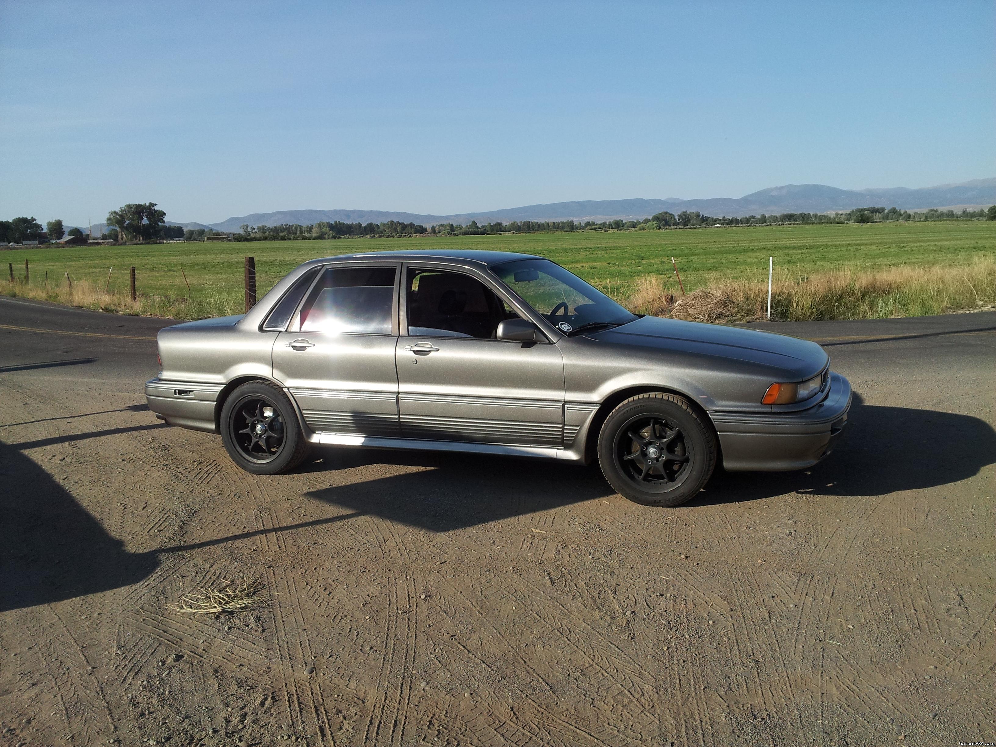

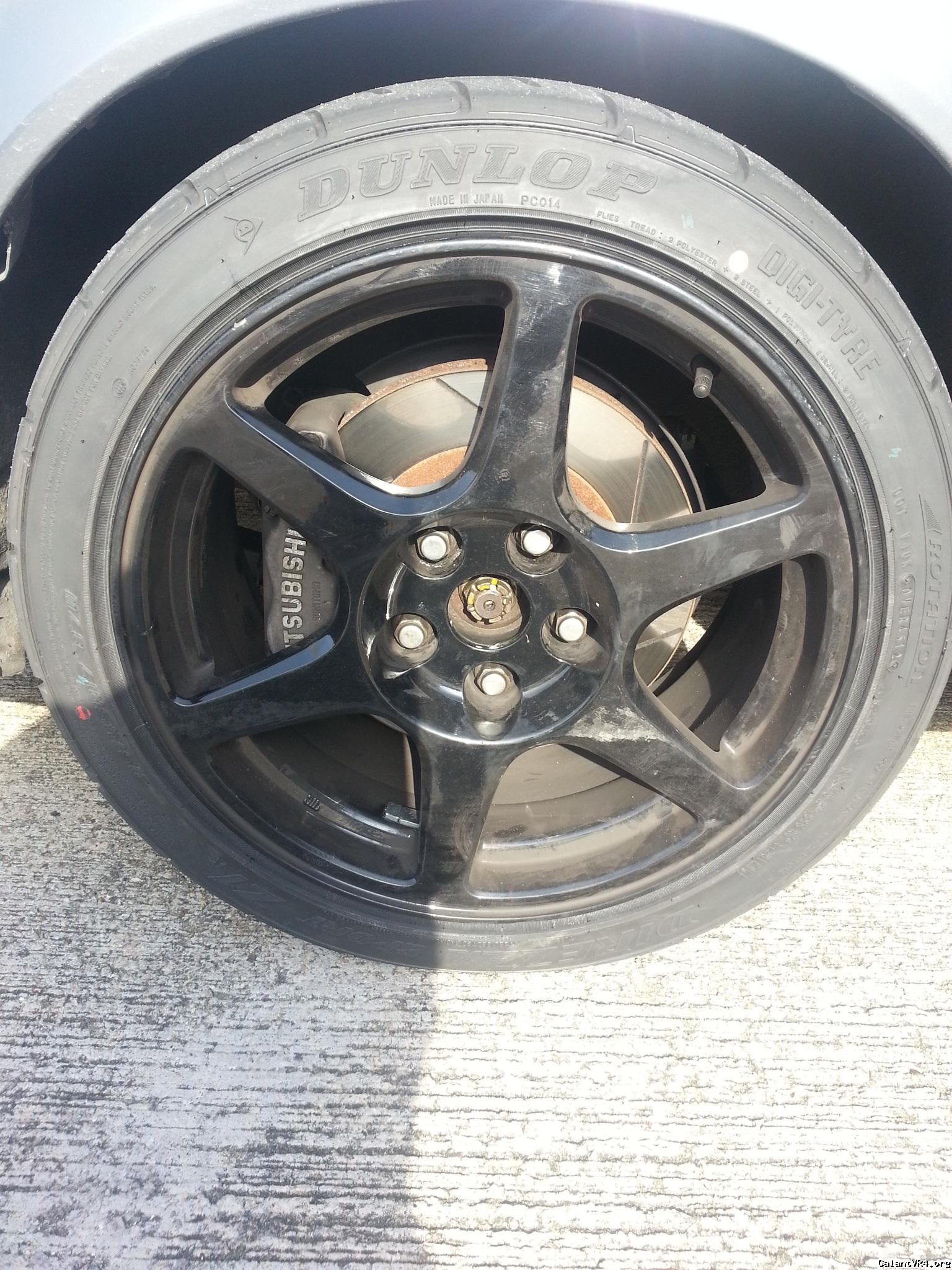

Below is a pic of my car with 17x8 +35 wheels. A +20 would stick out another 15mm. I already have -2.5 degrees of camber in the front, so you can imagine what it would take to fit a +20. I run a 235 width tire. You would need something like a 215 tire, and possibly more negative camber to get it under the fender. And why would you want a narrower tire?

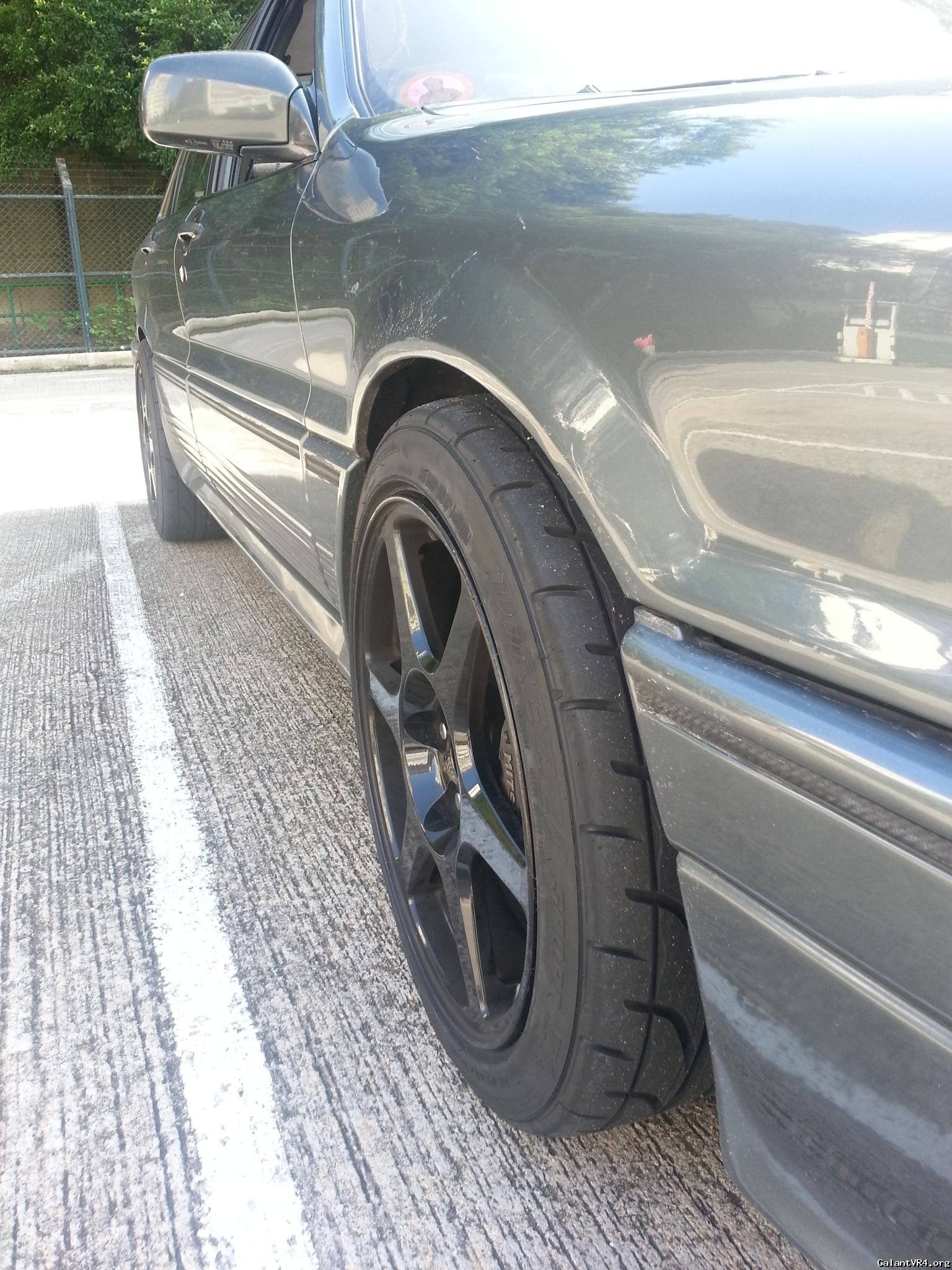

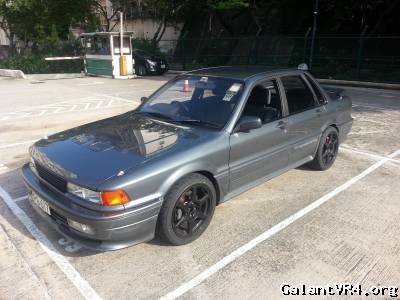

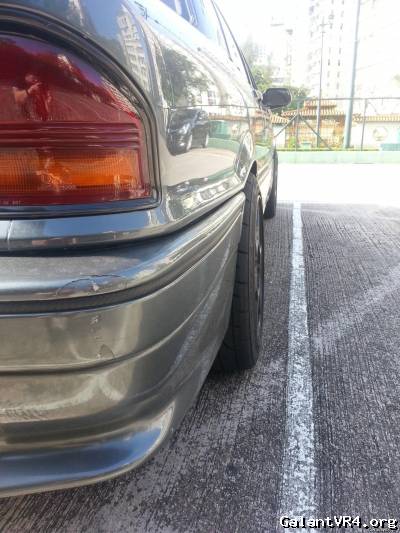

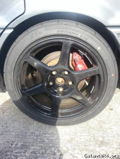

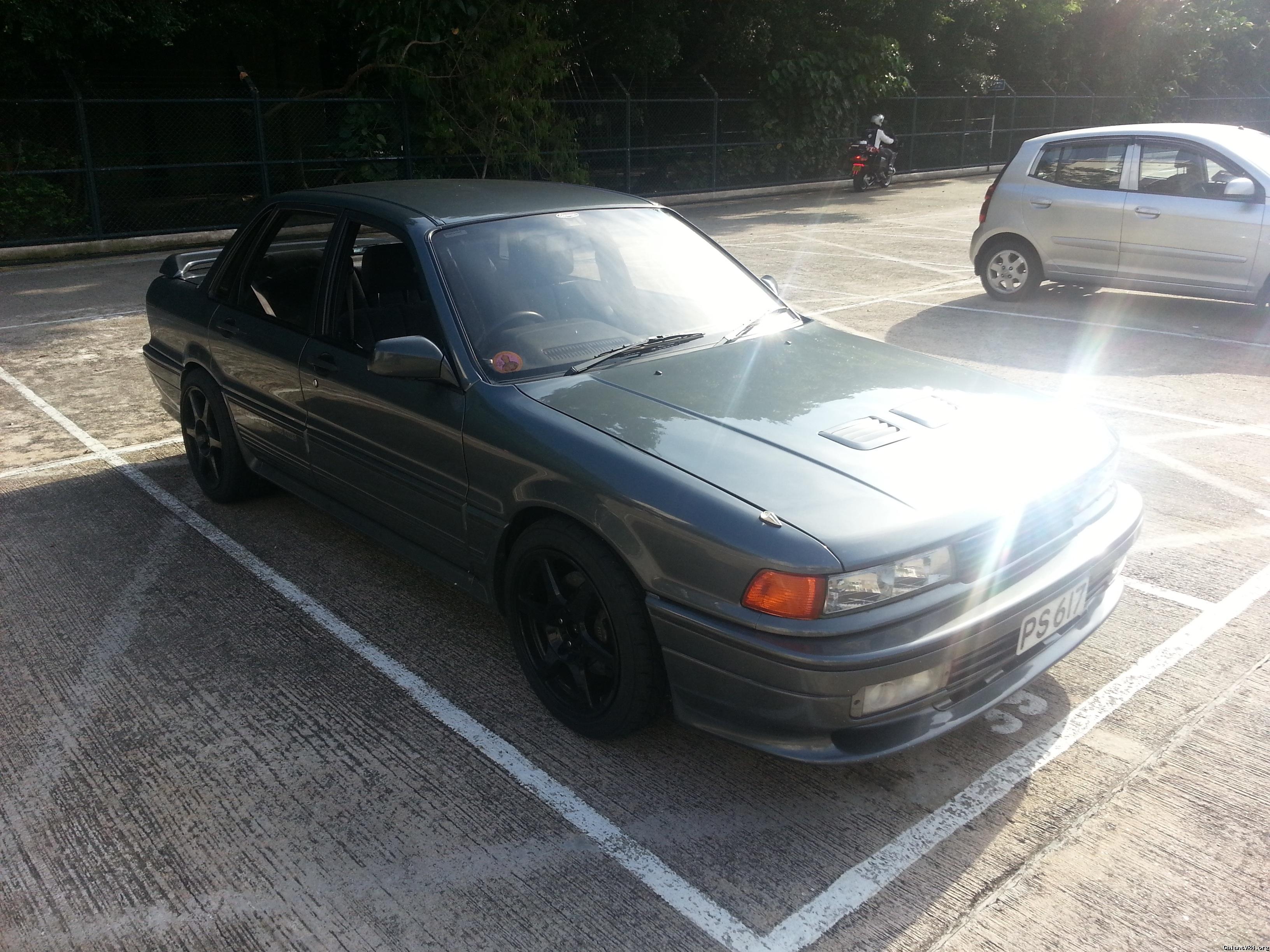

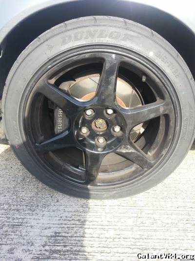

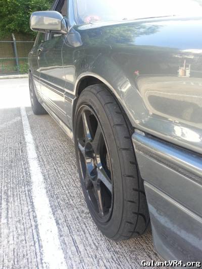

This car is using 3KGT hubs which gives I would estimate about 15mm extra track both front and rear. The wheels are EVO 8 so I believe offset is +38. Tyre size is 215/45/17.
Apples to Oranges I guess but I figure you are looking at a similar situation all said and done with a +20 offset on stock hubs. It is less rubber to the ground, but it isn't as if you start sliding around everywhere. Then again I'm not putting down the sort of power Mark is so maybe I'm less critical of grip. Thing is though, if I could have run a wider tyre, I would have. I really don't see the point in buying a +20 offset if you don't already own the wheels and have the option to get an offset that fits better.

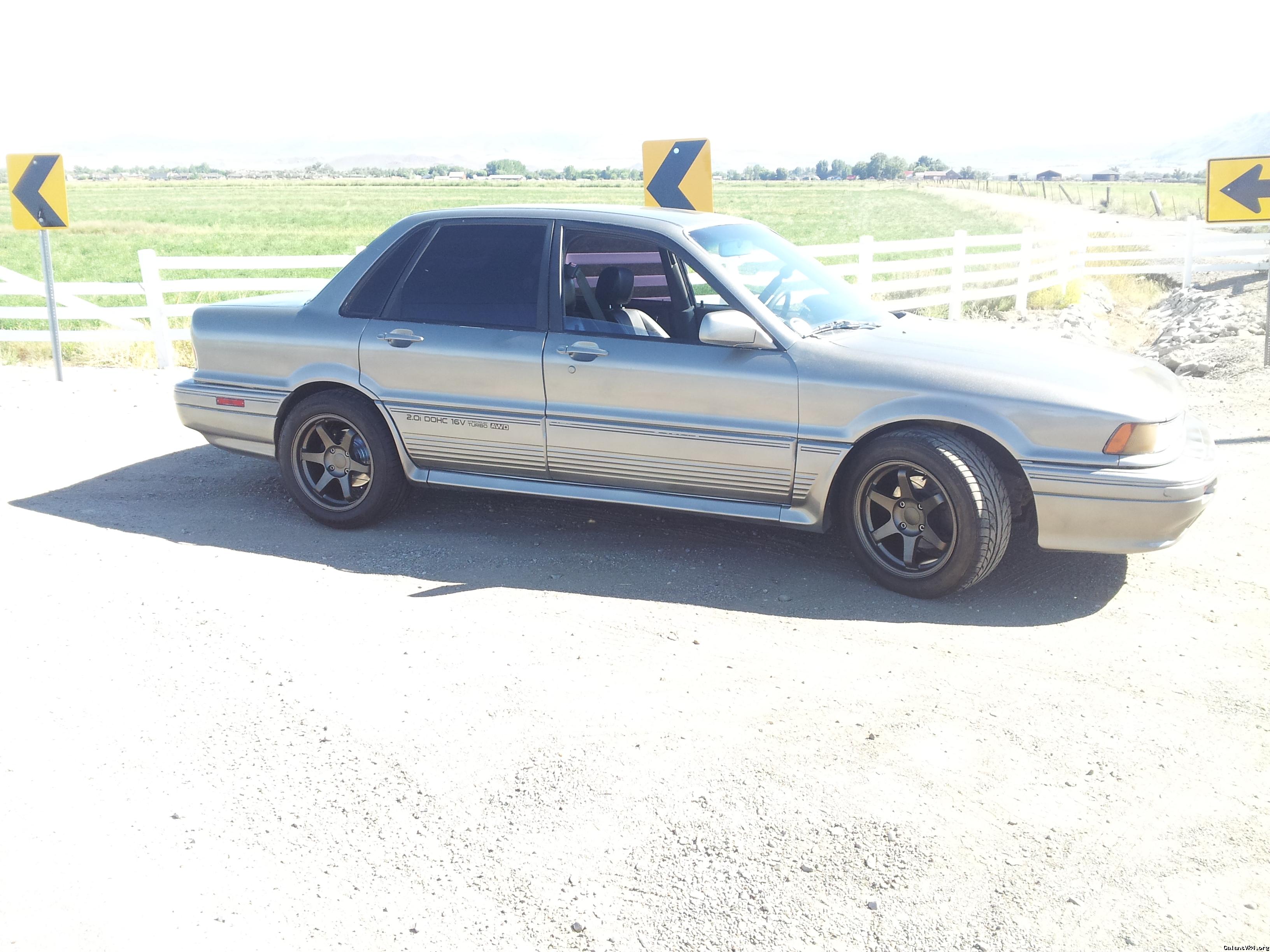

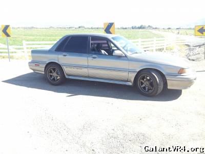

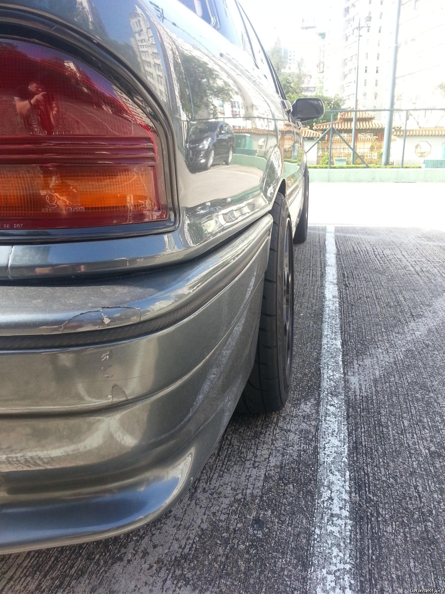

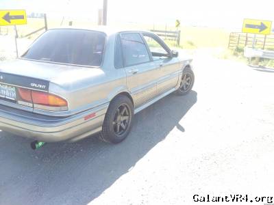

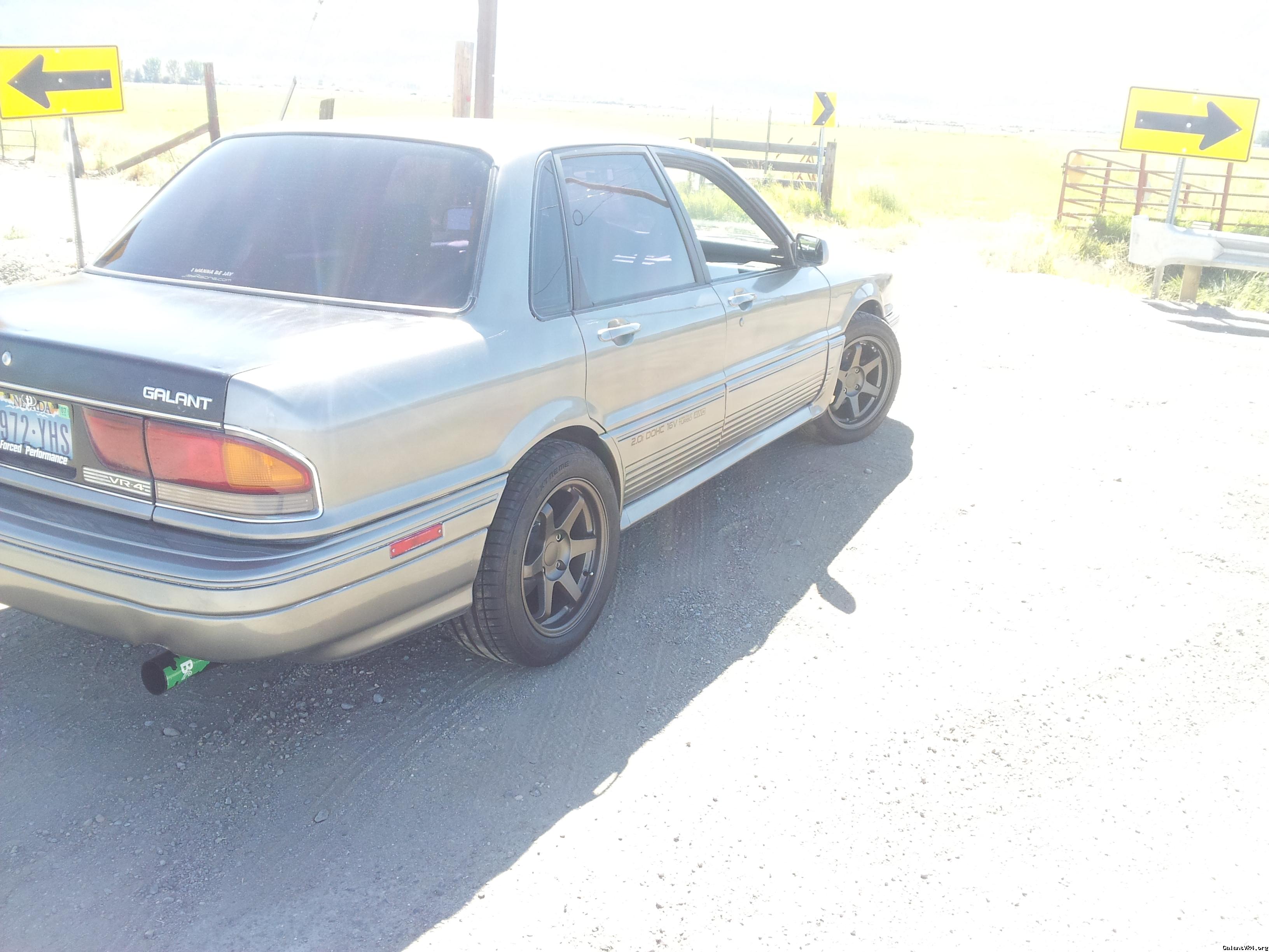

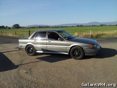

Okay so i got the 20 offset figuring i would have to do some modifying to get them to fit clean in the wheel well. The back isnt to bad but the front kind of sticks out. The back i can adjust Camber more but the front im waiting on my Camber plates and still need to slot out my evo struts some. Even with my old wheels i had like almost zero Camber.
Btw 16x8 with +20 offset on a 225 50 16

What rotors are those? They don't look much, if any larger than stock. How did you get 3k hubs into VR4 front knuckles?
