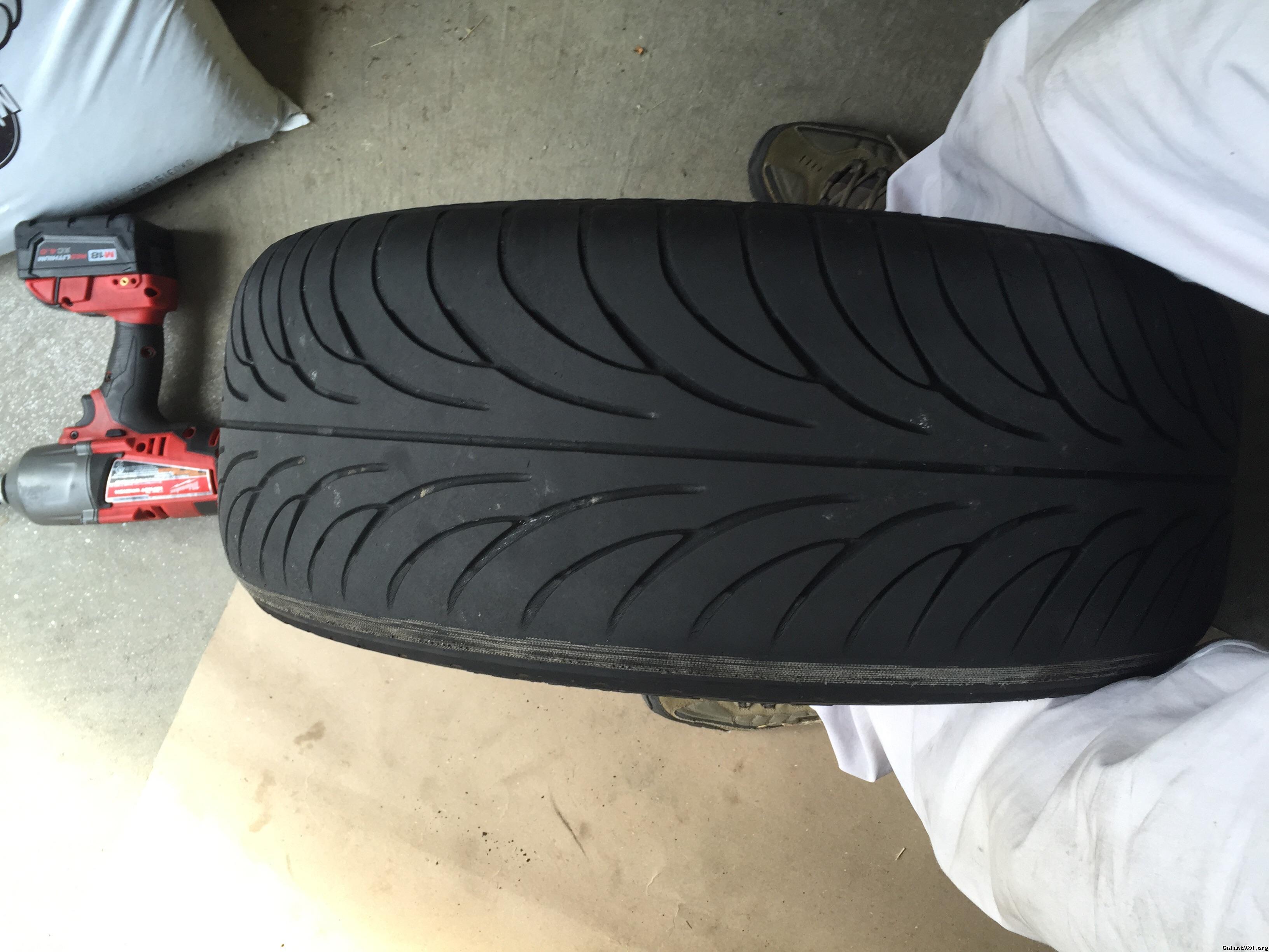

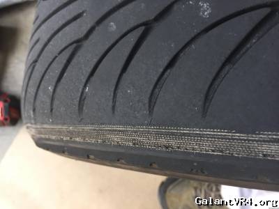

Left rear. The damage is on the inside edge. Only thing i can think of is something getting wedged in there for a few seconds at speed. Not likely, but I did have a caliper sticking on this wheel...that's when I discovered the tire issue.

How long has that tire been on the car? I think you may have a rear toe-out issue.
holeshotmoe
Apr 7, 2005
1,298
VA
I hear you. But here's the history. Had Mrs Tire rotate them to the back a little over a year ago. Had an alignment done at the same time. (Had just replaced front bearings so had them check the back too) Then I swapped to snow tires last December. Then this past March I swapped back to these, putting them on the same corners. These and the snows were fine at every exchange. Checked the snows last night and they're normal. That's why I was thinking maybe i picked up some debris??? Then it got ejected after a minute??

...and wouldn't the rest of the tread show signs of it dragging skewed? The edge is pretty severe. And would this tire pull the RR tire like the front would, or are they independently steered on the back?

It definitely looks like an alignment issue and your tyre is possible underinflated too as I can see wear on the opposite shoulder whereas tread in the middle isn't worn down as much.
Get another wheel alignment and check pressures of all your tyres.
10,992
The alignment is independently set in the rear.
One other thing to consider, and this happened to me so I think about it. If the rear alignment is done without disconnecting and adjusting the rear steer tie rod ends, it can negate the effect of adjustment if the tie rods push the trailing arms back out or pull them in. They are technically supposed to be disengaged from the trailing arms, adjusted and then dropped back into the trailing arm holes after the rear is aligned.
I had an alignment done years ago and the shop did not do this in this way. I has a similar tire wear issue. Not sure why you would not see this on the snows other than possibly the different nature of the tread designs.

Yeah, I guess I'm trying not to remember the ignorant expressions on their faces when I handed them a printout of the tech bulletin specifying the procedure to do it correctly. Likewise I'm not looking forward to the ignorant expressions on their faces when I try to convince them they owe me for at least one new tire. /ubbthreads/images/graemlins/mad.gif /ubbthreads/images/graemlins/frown.gif /ubbthreads/images/graemlins/banghead.gif /ubbthreads/images/graemlins/uhh.gif
