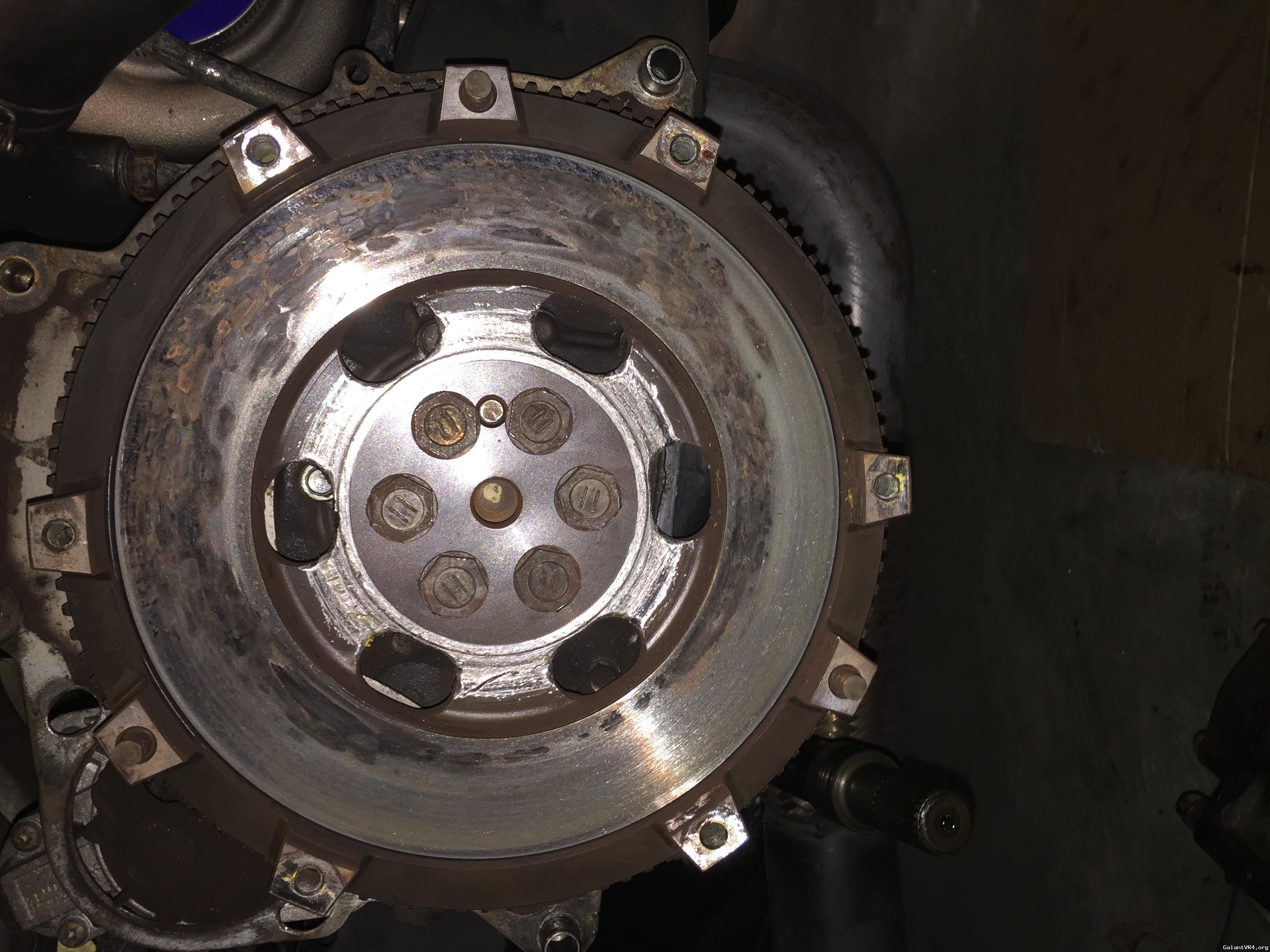

Why do the ACT discs lose springs anyway? If they fixed the "issue", what did they change? Is there a serial number range that identifies the vulnerable discs? What other sprung disc, compatible with the 2600 plate never loses them?

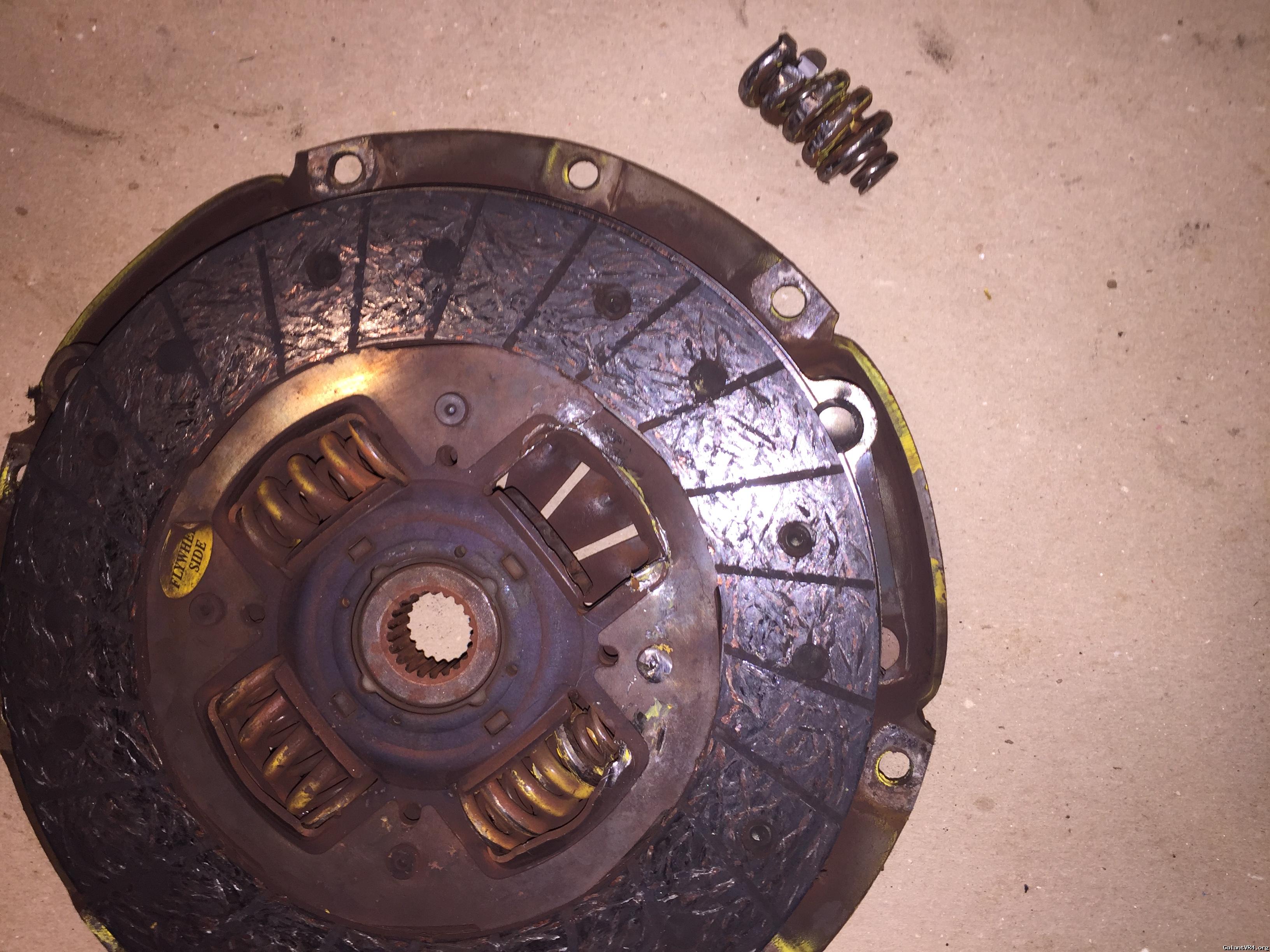

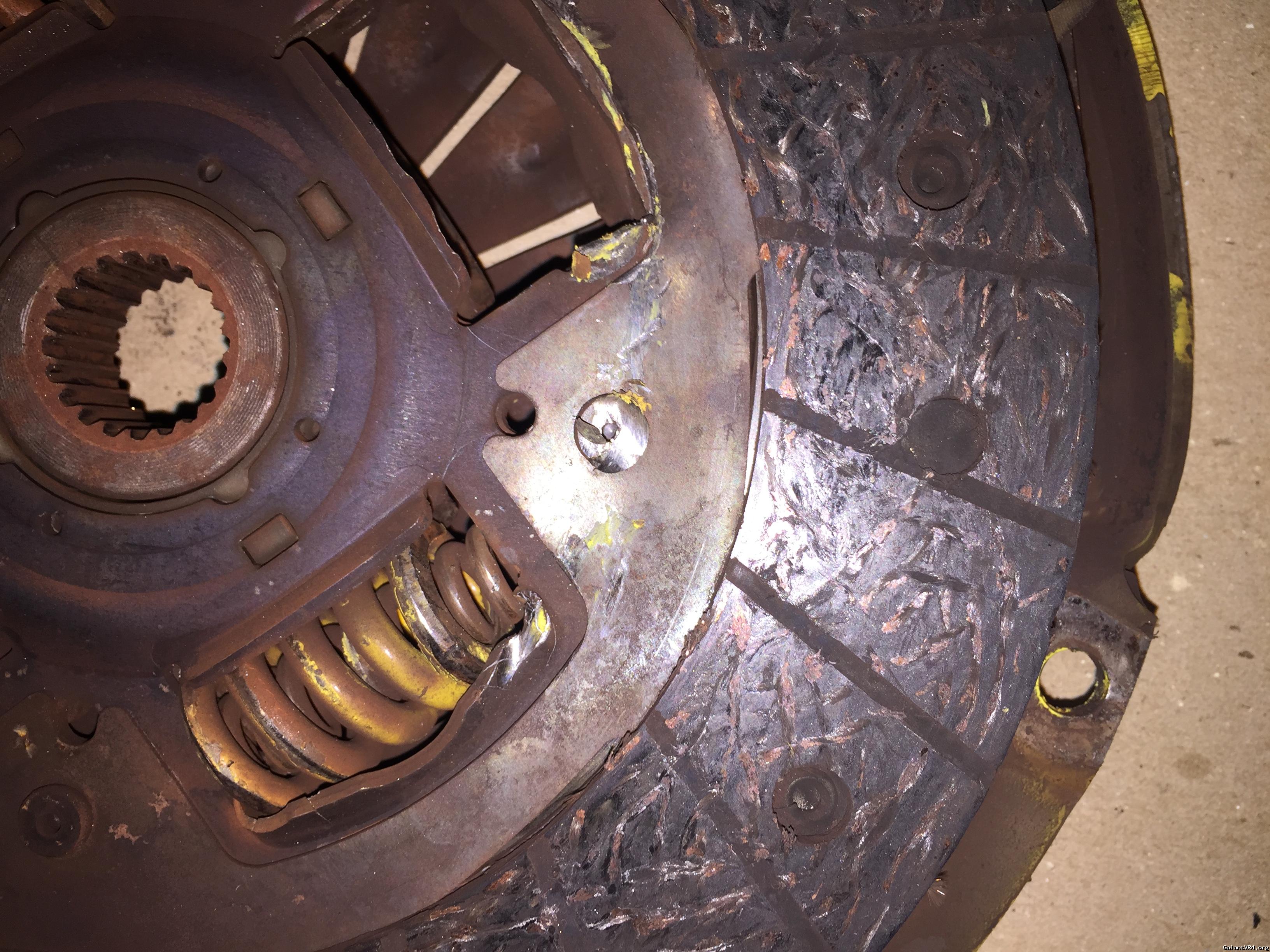

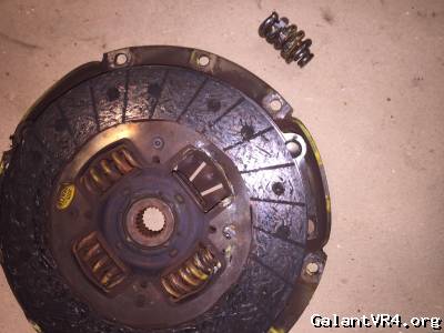

I put this in a couple years ago. Maybe 10K +/- since then. Everything was new - flywheel, TRE trans, ACT 2600 with street disc. No big power (maybe 240), launched every once in a while. Started having trouble disengaging the clutch. Read about the ACT disc throwing springs, and symptoms were similar. So it sat for a few months until tonight when I got the trans out. The tab holding the spring in has broken off.

I have never owned one of these clutches, but have heard the stories. Looks to be unfortunately true in your case.
FlyingEagle
Mar 5, 2005
1,635
THE Ottawa
Contact ACT directly, would be my advice. They cleared up a bunch of info some years back about issues that some were experiencing. It was a whole mixed bag for a while there.
A google search of early stuff here on the board and elsewhere should yield results to this effect. I am not referring to anecdotal type stuff either.
3,473
It seems to be hit or miss. I've had ACT discs last forever, and others that sh*t the springs out. Typically, the 4 spring discs hold up better in my experience. I've got a sprung ACT 6 puck in 1837 right now, and that thing has taken a beating in traffic and at the track. It has heald up pretty well considering the abuse it has taken.
Contrary to popular belief, this isn't a problem exclusive to ACT discs. FWIW, I've seen OEM and other brands do the same thing.
I would second contacting ACT. They may be able to do something for you.

Thanks everyone for the feedback! I have a stock OEM disc I was thinking about using with the 2600 PP. But after considering it has only two springs (versus 4 in the ACT) and four rubber bumpers, I ordered the CC full face sprung disc. I like how the springs are almost completely enclosed, which I hope will reduce the likelihood of their getting loose. I looked around a lot, and found tons of discs where springs had come out...mostly ACTs btw. Won't buy that junk again. [Who has time to yank a transmission out for stupid stuff like that?] /ubbthreads/images/graemlins/frown.gif I've had CF dual friction, zerozone stock replacement no-name and exedy HD setups and never broke anything like that.

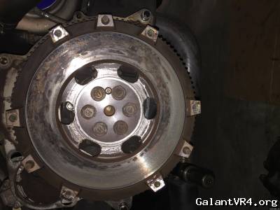

Check out the job it did on the flywheel

Every sprung hub with pucks i've run hard has either tossed a spring or had the hub separate. Puck style discs with springs are particularly susceptible to this due to the harsh engagement. I've seen it happen to full face discs as well, but they seem to be more tolerant. It really doesn't matter who made it, ACT or otherwise.
