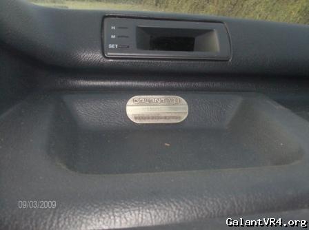

Yeah, thats what they told me. It had to have had a dash swap because the title says 92. I gota check the vin plates.

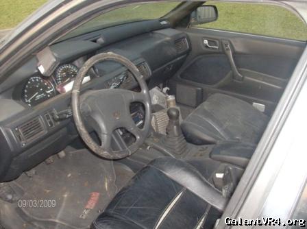

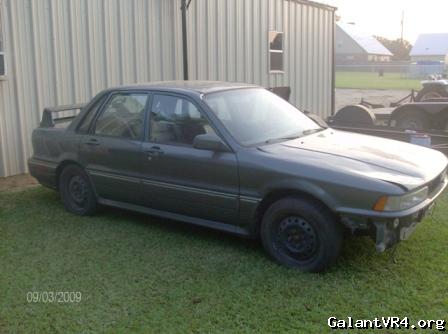

Here are some pics. The interior is acutally in really good condition, its just dusty and dirty at the moment. Car needs new hood, and a stock wing..I dont like the Evo III wing. The front bumper was removed to take off the FMIC.
