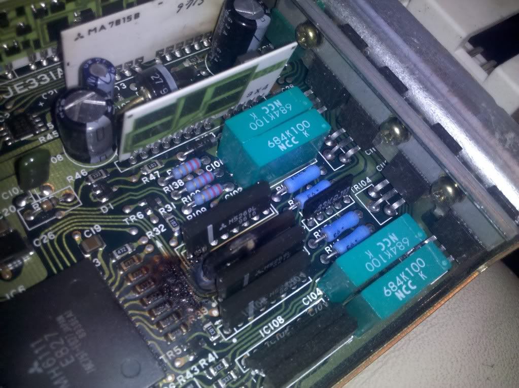

What would cause this (PCM failure):
This doesn't look like the typical failure-mode for these PCMs, any idea what would cause this? I think it's something related to the injector drivers since they weren't pulsing and we found the PCM like this while diagnosing.

I'm no ecu expert but it looks like your ISC motor is shorted and took out your ISC drivers. I've had this happen a few times, and it's a common way that something wrong with your car can take out an ecu. I'm actually about to buy an eprom that has sustained this damage but still works fine with no ISC. Your FSM will tell you which pins to use to check the resistance of the ISC coils.

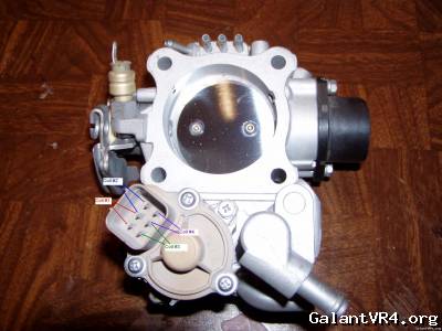

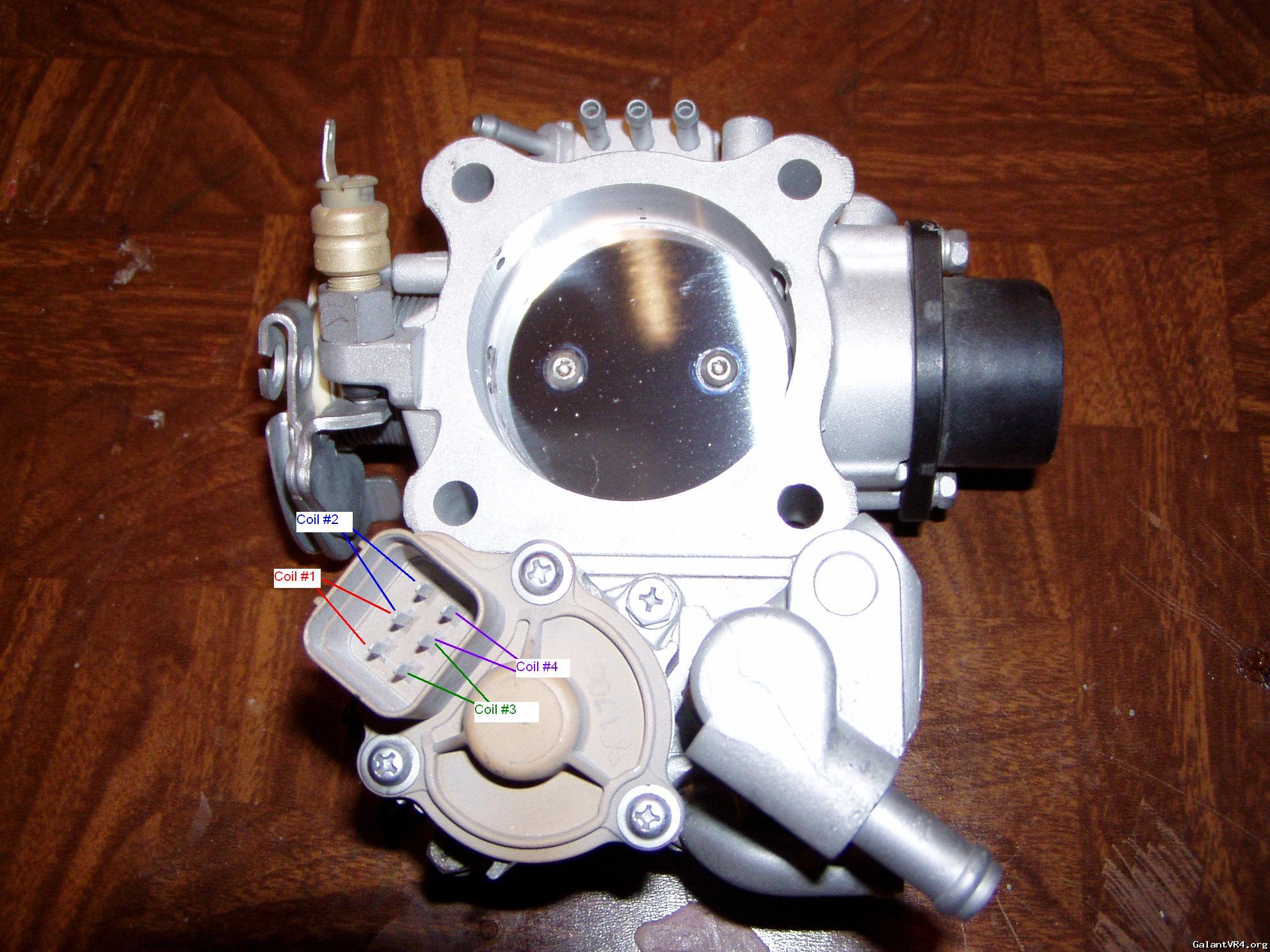

Idle Speed Controller. It is a small motor that is mounted under the Throttle body inlet that has a 6 prong square plug.
Here is a pic that should help you test your unit. If it is bad, you DO NOT want to plug in a new ECU (Engine Control Unit), what you are calling a PCM, without leaving the ISC unplugged until you get a good one.
You should have around 30 ohms of resistance on each coil. An open coil is bad but will not hurt the ESC. A shorted coil is bad and will hurt the ECU.

I think the specs are on VFAQ, although all you need to do is check the resistance of each of the 4 coils in the picture above. They should be all around 25-30 ohms, give or take. It's obvious that one of yours is going to read close to 0 ohms.

IC108 is Purge (pin 1) and EGR solenoids (pin 7)
IC109 is A/C (pin 1) and Fuel pump relays (pin 7)
The pins are the outputs the M5269L driver, matching inputs are 3 and 6
So it does look like IC105 cooked due to a shorted ISC. Had this same issue on one of mine. Also, your picture seems to indicate possible damage to some of the other traces on the board. There's a few guys here that do repairs, and a few may have a spare IC. I've heard of someone salvaging IC108 because they had removed the smog control components from their car, since it wasn't being used. But you had better check with some of the guys that fix these things (e.g., keydiver) first. But if you get one of the chips, a tv repair (are there still such businesses?) shop should be able to solder it in for you, and should be able to repair any broken runs on the board.
