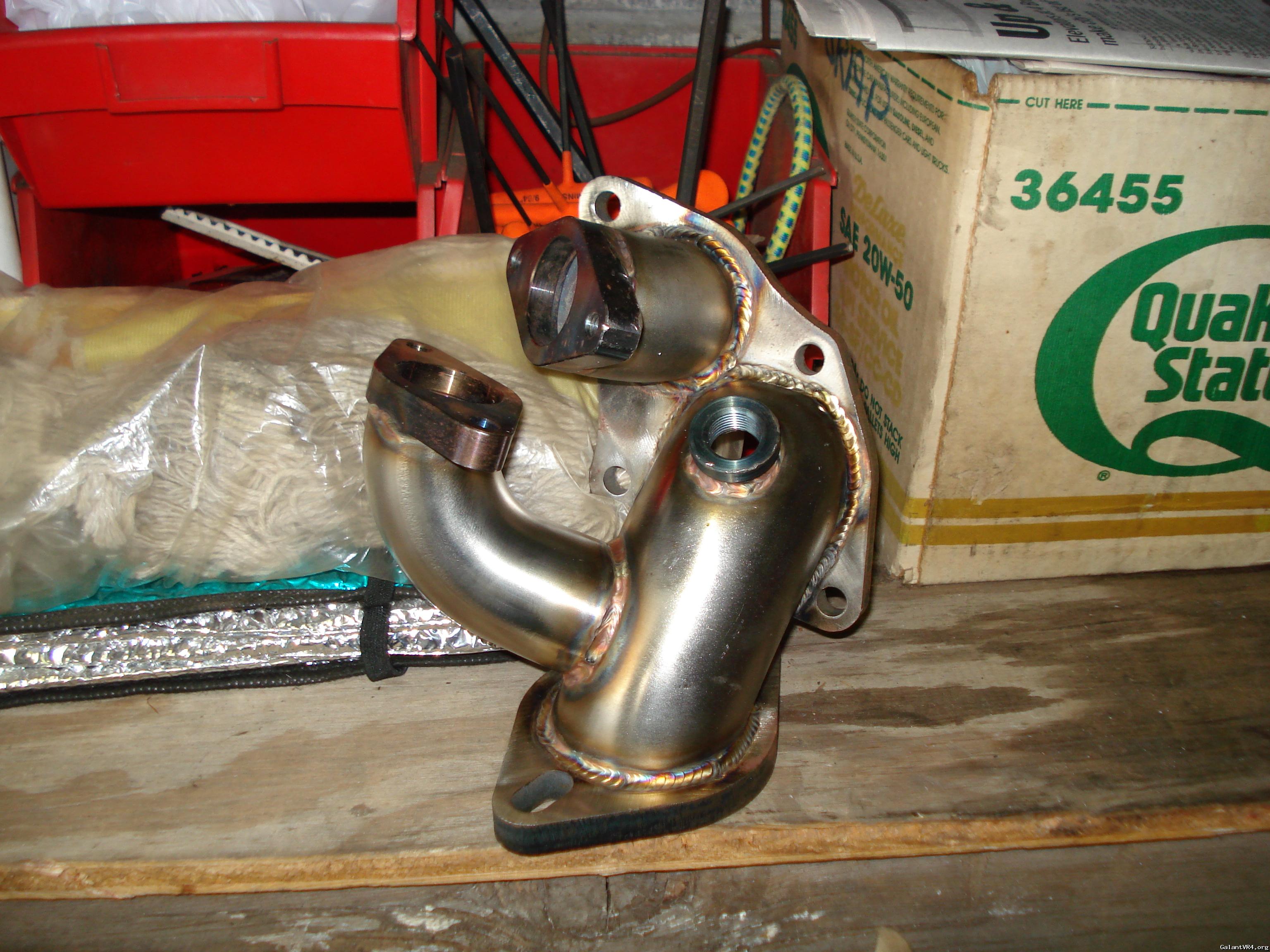

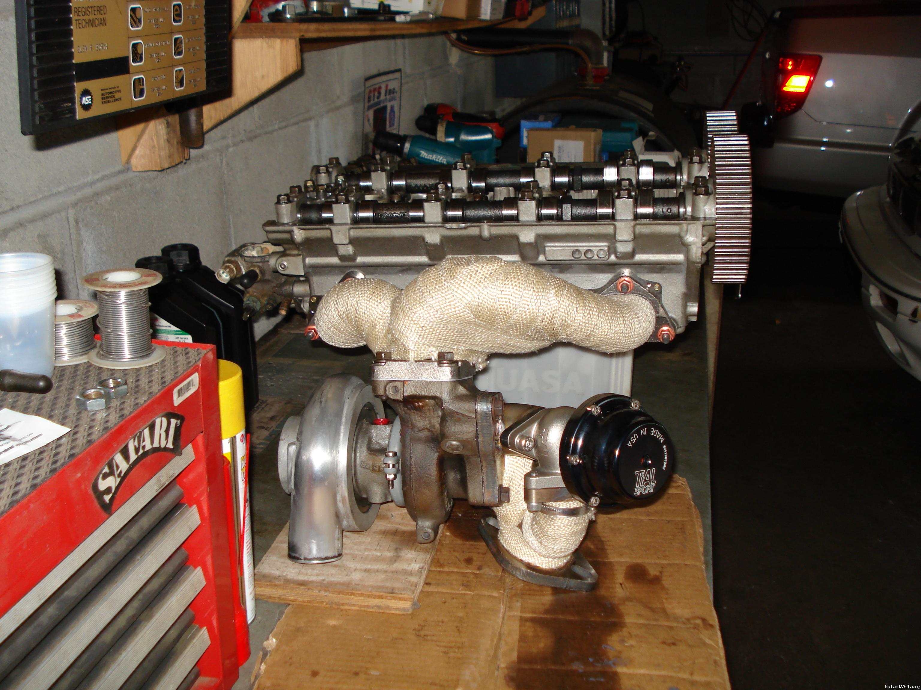

Pretty much any Tial external will do. The new 38mm MVS wastegate from tial is Vband, very small (easy to work around), and relatively inexpensive. Mine held as low as 14psi on spring pressure alone without creep.

I currently have an FP Red setup with an external 38mm Tial waste-gate. The 38mm is good for 2.5 BAR which is equal to 36.75PSI; Which I feel is plenty for this setup. I also purchased a 02 housing that recirculate’s the waste-gate right into the down pipe. I like it because it’s cleaner and not as loud as a dump. I believe that the 38mm is the smallest that Tial provides; but I haven’t had any boost creep with it.
