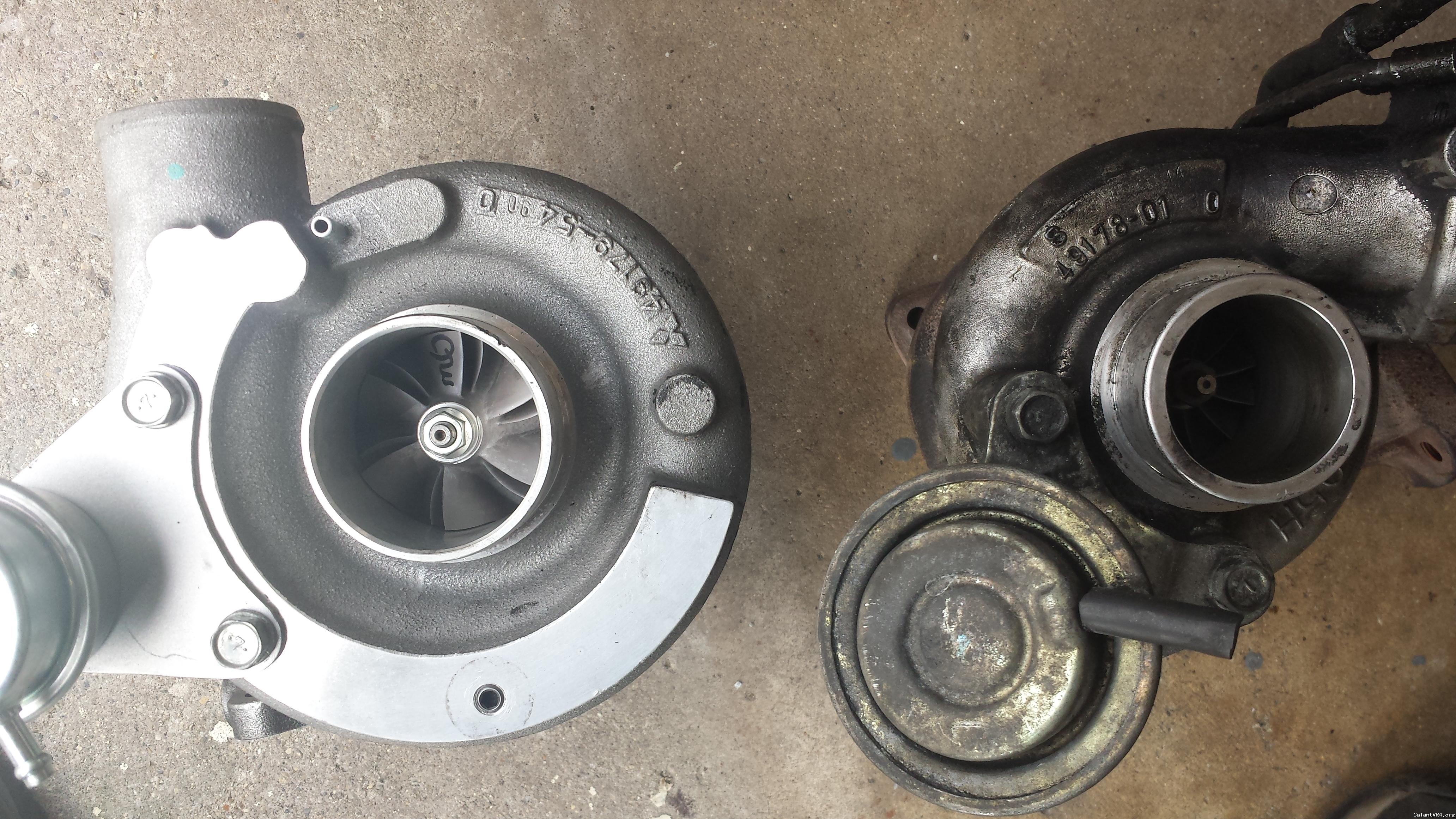

A while back I bought what I assumed and was told is a mhi td05 20g. But now that I am finally able to work on the car it appears much larger than my stock 14b. I tried mocking it up and it won't line up with my 2g exhaust manifold and clear the coolant pipe behind it. I'm wondering if it's a tdo6. Any help would be appreciated. Thanks.

According to my quick search it is a td06. I only paid a really good price for a td05 but I'll gladly take it. But I guess my question then is, won't this turbo still be a direct swap bolt on? Hmmm...

Ugh. I'm such a newb lol. It is a td06, which makes me happy for the price I got it at. Thinking they sent me wrong one. But anyway, it fits fine. My dumbass forgot to move the coolant line. Thanks anyway.

Only way to tell if it's a td06 is to measure the turbine. Td05, td05h, td06, and td06h are turbine sizes, and have nothing to do with compressor covers.

Sorry. Was just showing the size difference. I can snap a picture of the other side tomorrow if you want. I got it ask figured out. Now I just need some free time to get it bolted up and see what lines need to be modified/changed. Also need to get my vrsf front mount mocked up and installed. Someday I'll have the time lol. Have had this stuff sitting in the garage for months.
