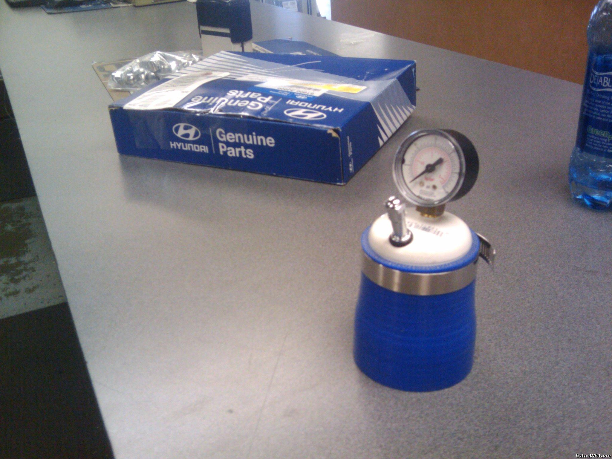

I have this tester and am ready to use it.
if I am understanding this correctly that I disconnect the inlet side of the turbo strap this on
here is my question.
don't I need to plug the end that is no longer connected to the turbo ?

Look under the Intake section at the bottom ( Leak Tester ).

Make sure you regulate the air pressure being applied. Don't allow full compressor shop air to pressurize those poor tiny oil seals in the intake system. Regulate down to 20 PSI and you will be fine.

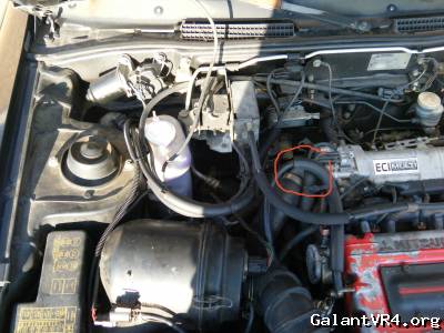

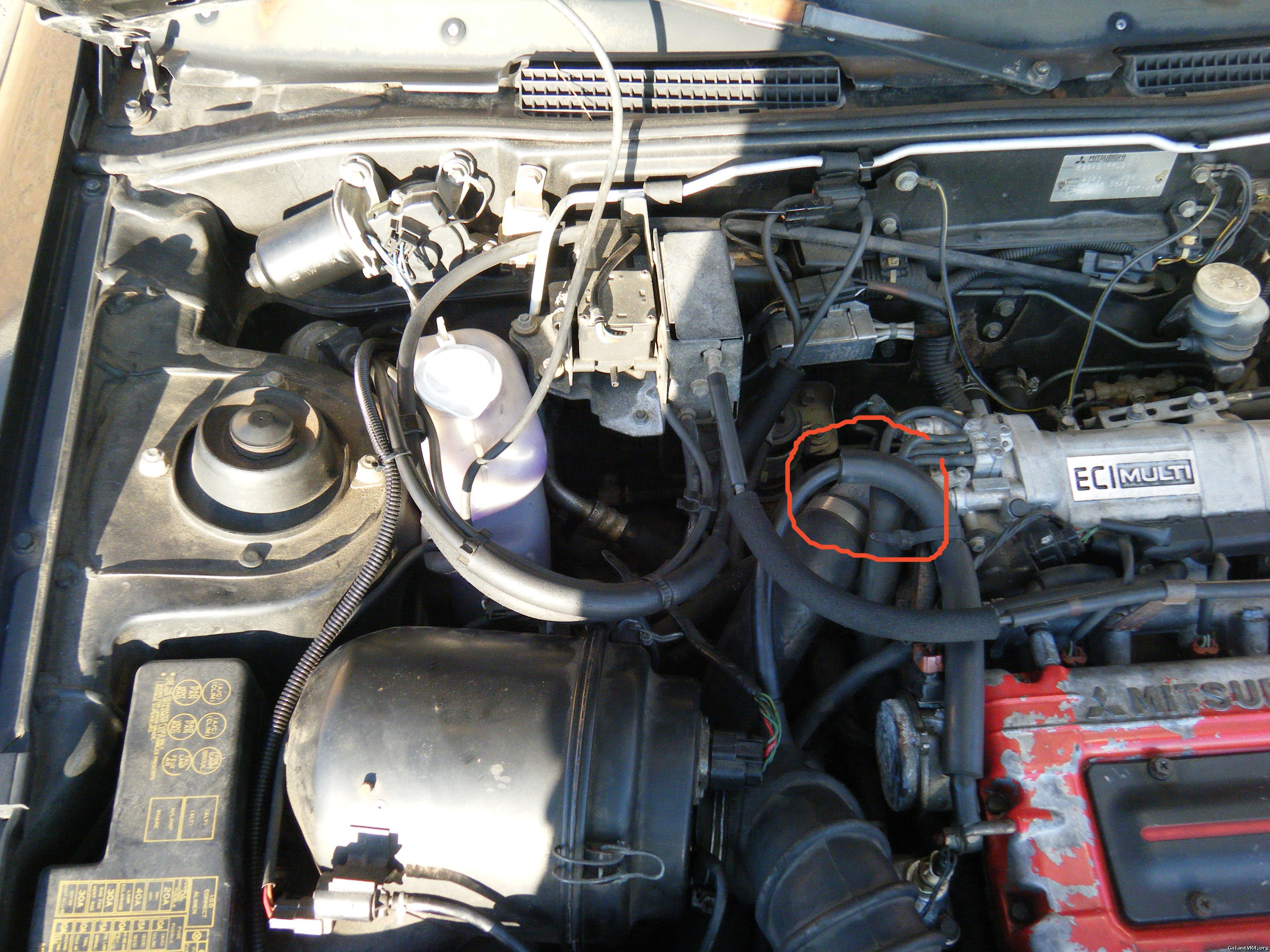

put leak tester on turbo inlet and started with going up to 5 psi needle on the guage went quickly to 5 and dropped steadily back down I would say around one psi a second maybe a little faster but it went up and went down.
definately heard some hissing but it was very faint. spray bottle filled with soapy water sprayed around while.
kept the guage right around the 5 mark, tring to locate the leak. more spraying moved up to between 8 and ten on the guage and found the tiniest of little bubble
right at the top of this tube.
sorry I didn't have my camera to take pictures at the time.
So my question here and the reason for this boost test was that at around 4500 rpm the cars starts to stutter pretty bad. I was told it was a turbo leak. from what I have read and what I can tell the system is holding pressure.
other then that the car runs fine.
any new suggestions?

It looks like you have the breather tube circle. Is the one leaking the large one coming from the valve cover or was it one of the ones on the throtle body? Did you follow the instructions on VFAQ (talking about turning the motor by hand)?
