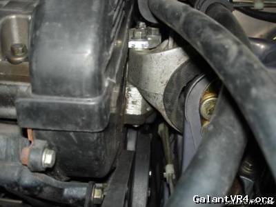

AllanL
Aug 4, 2008
298
NV

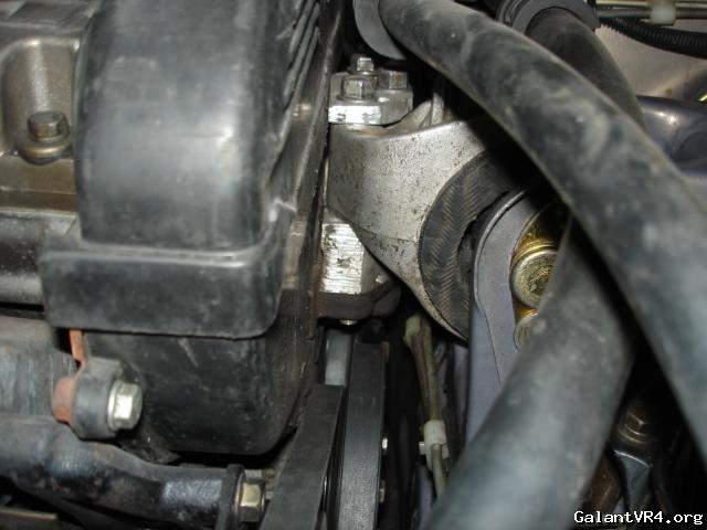

if it is a direct swap, you do without changing the t/belt side mount.
instead install this 40mm spacer between the support and block mount.
i believe the galants with the dohc 4G63 use this support...
for the radiator side bracket mod, i'm looking for the pic...
