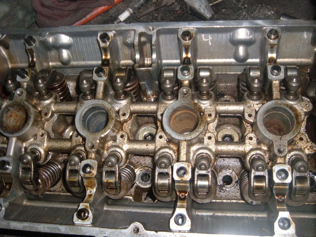

The subject head is a Mitsubishi 4G63 7 Bolt
The first thing that should happen is the machinist looks at the head. Checking for the obvious damage, broken bolts, stripped bolt holes, bent valves, ect.

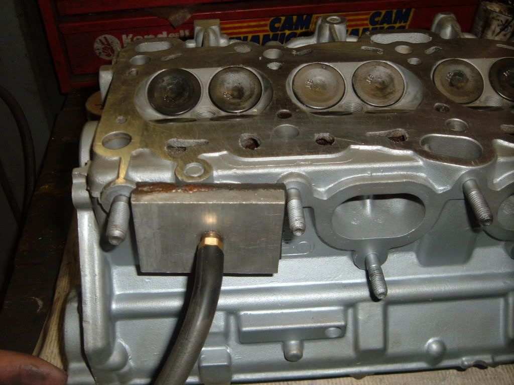

1) Pressure test for cracks

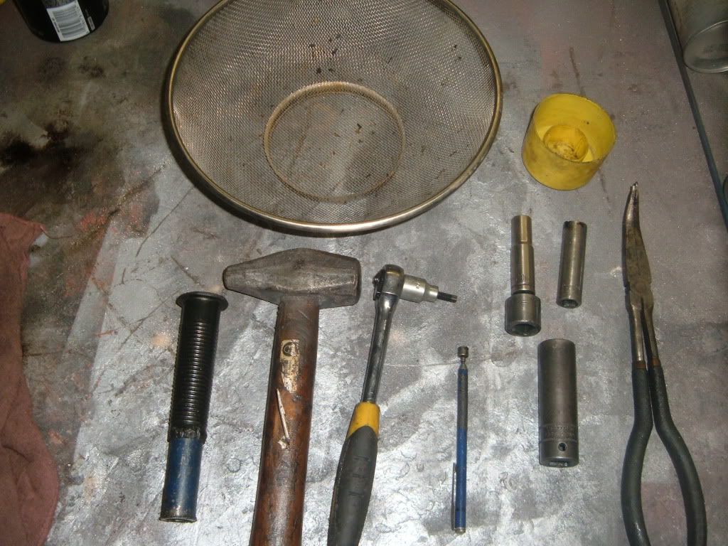

The tools needed are
Wire basket for small parts springs, valves, ect
Small container for valve locks

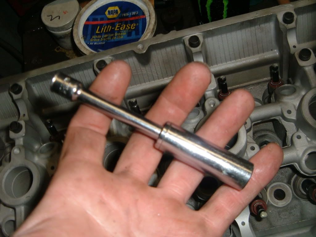

Valve lock release tool (socket method)
Hammer
10mm socket
12mm socket
12mm socket
Ratchet
5.5mm allen bit socket or wrench
Pocket magnet
Long reach needle nose pliers w/45* bend
Impact gun (not pictured)

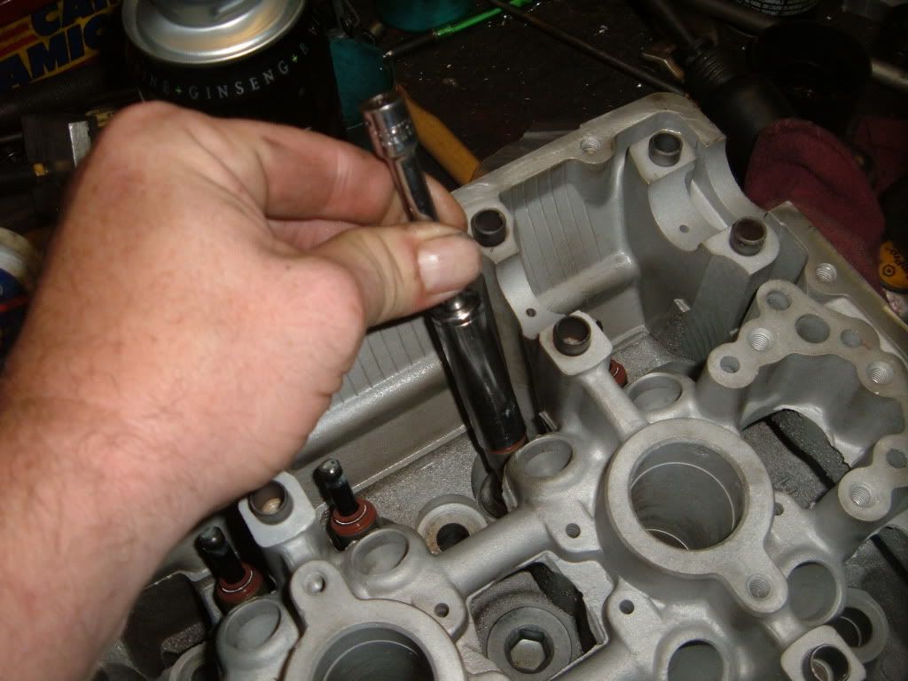

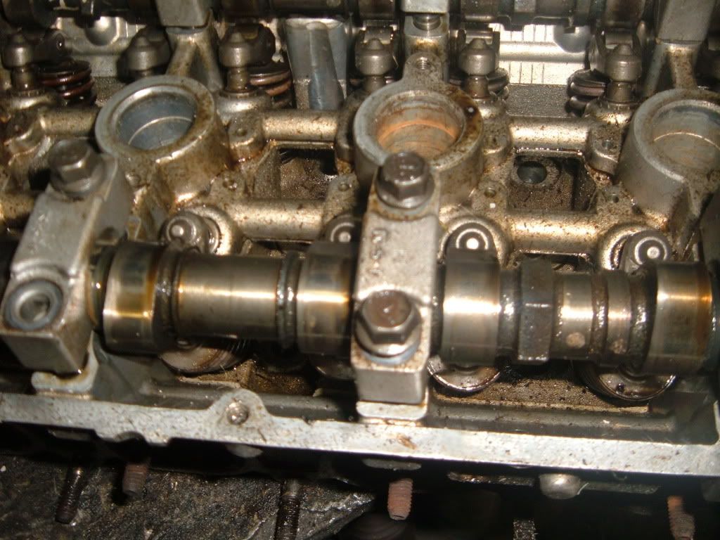

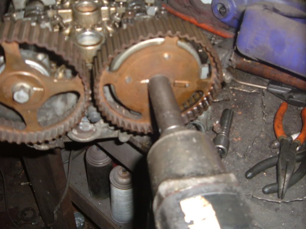

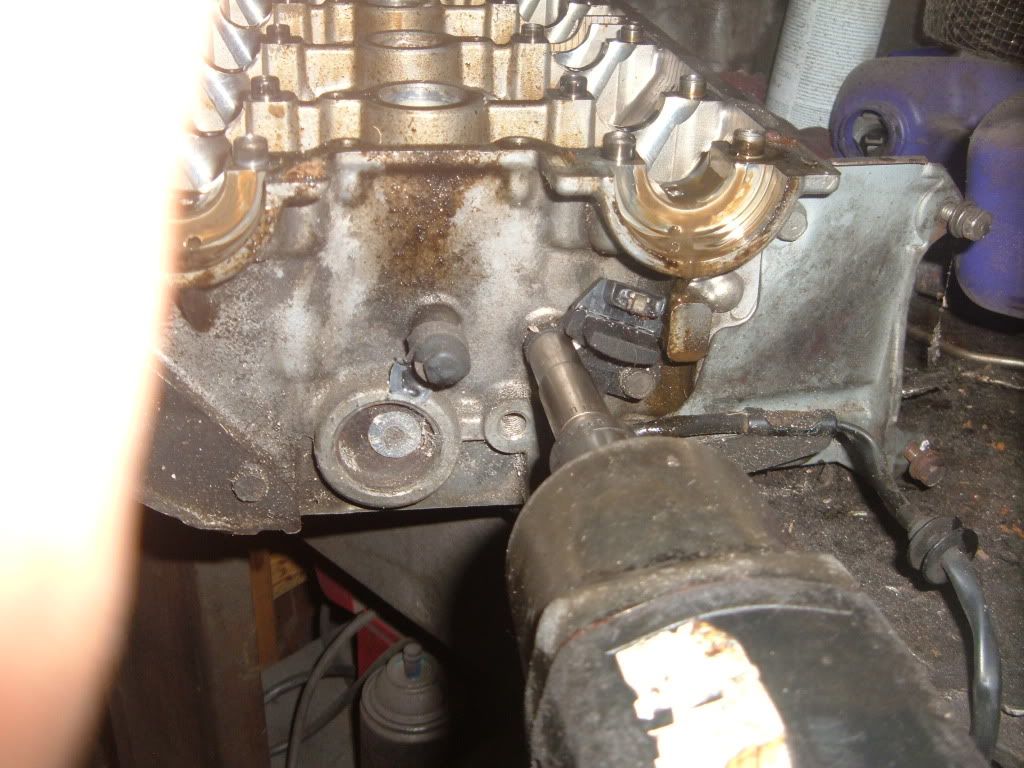

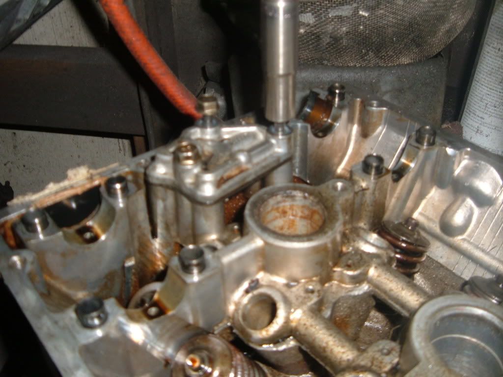

Cam gears come off first, use impact with the 17mm socket
Next remove the cam tower caps, use impact or ratchet w/12mm socket.
Start at the ends working towards the center

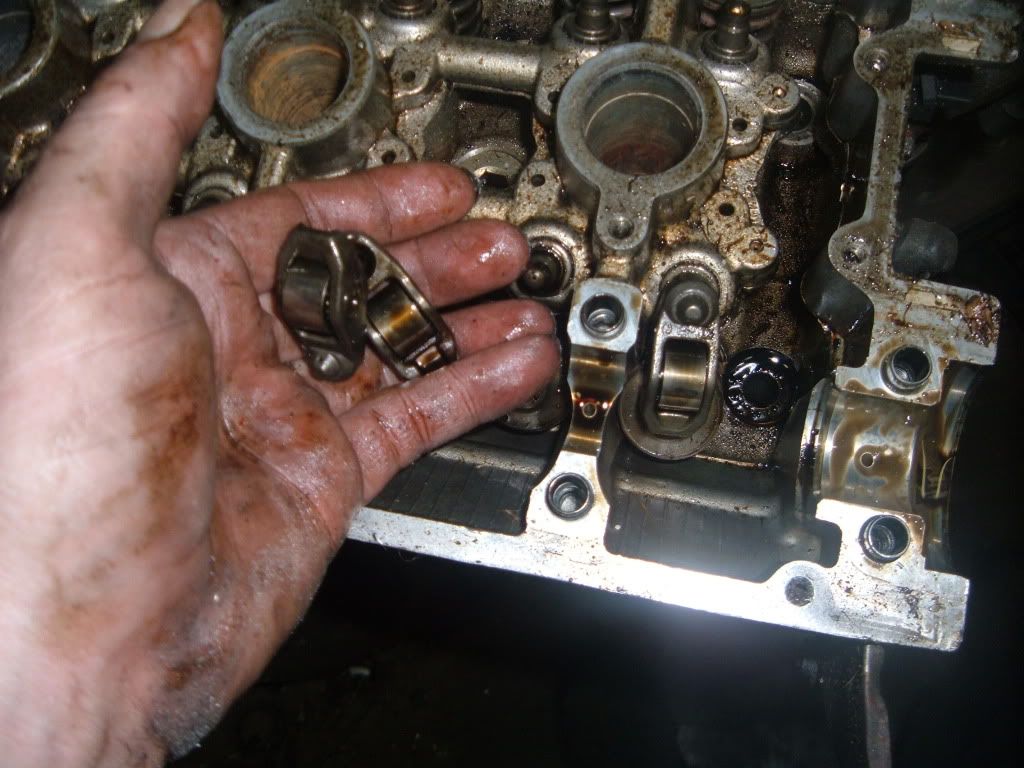

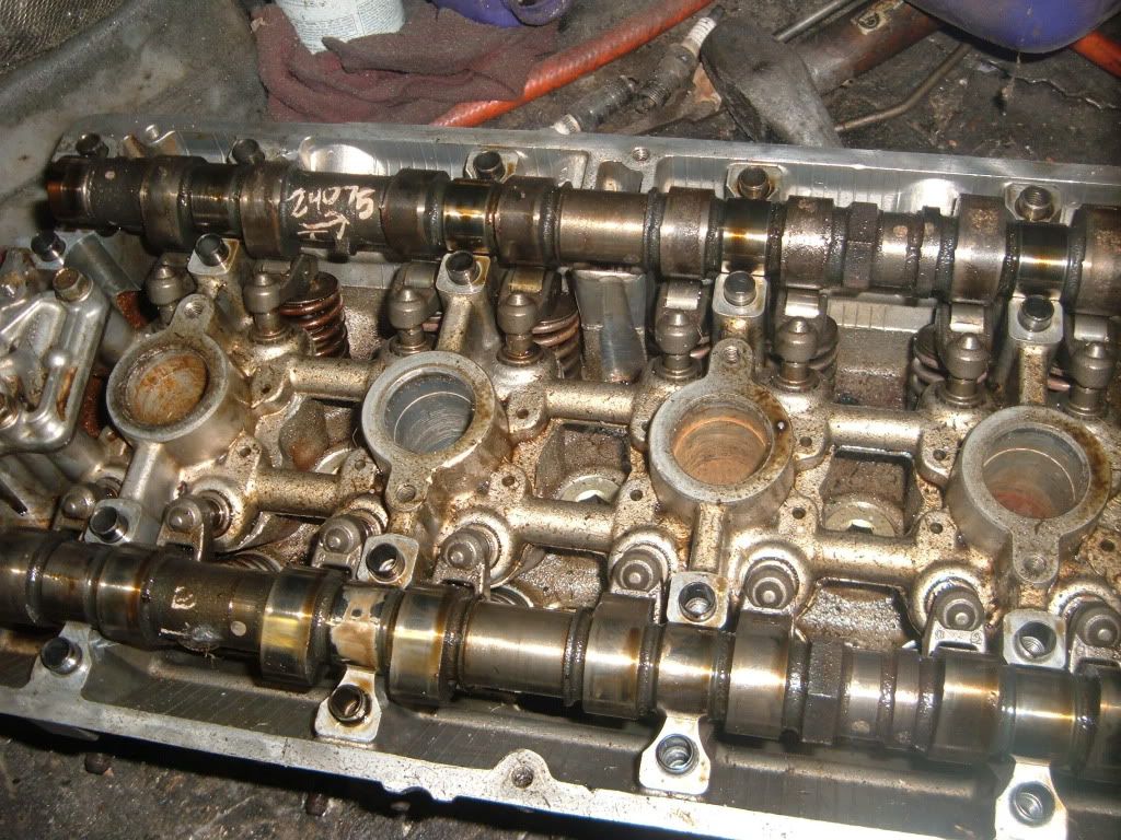

Once the cam caps are removed, lift the cams out.

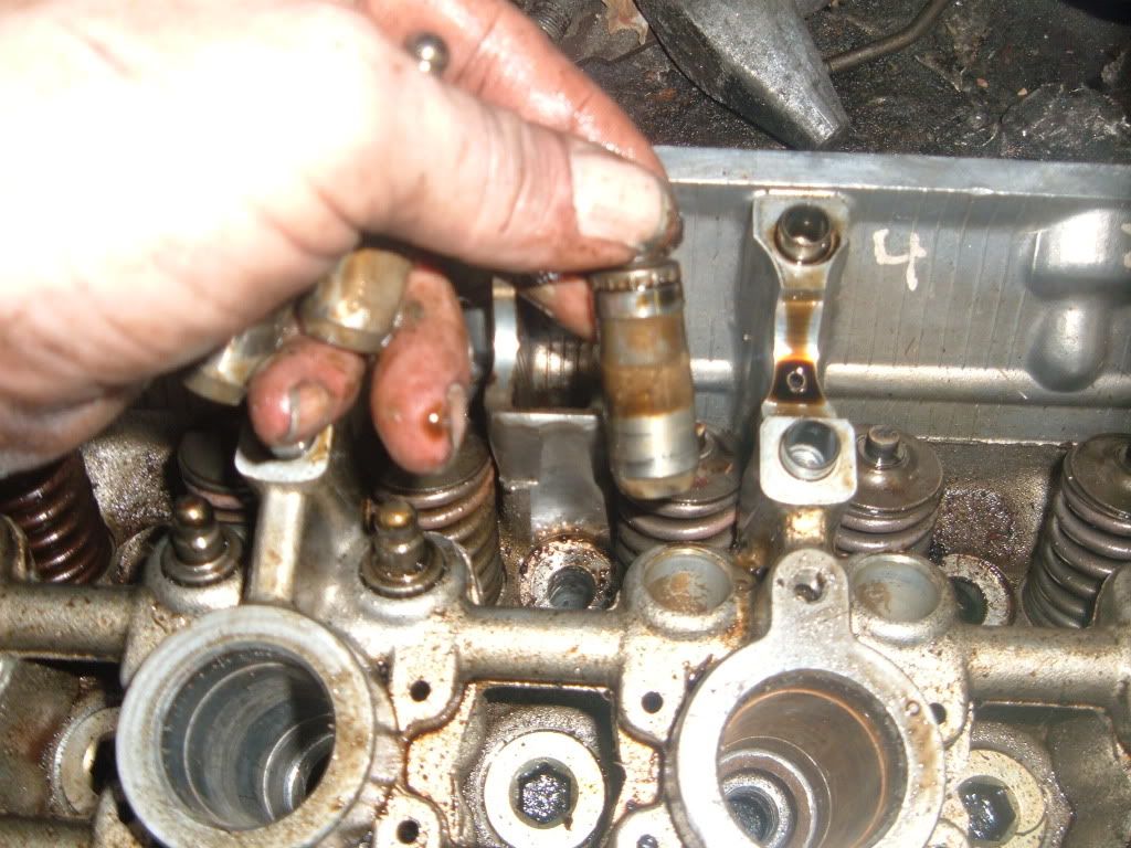

Next lift the roller followers out

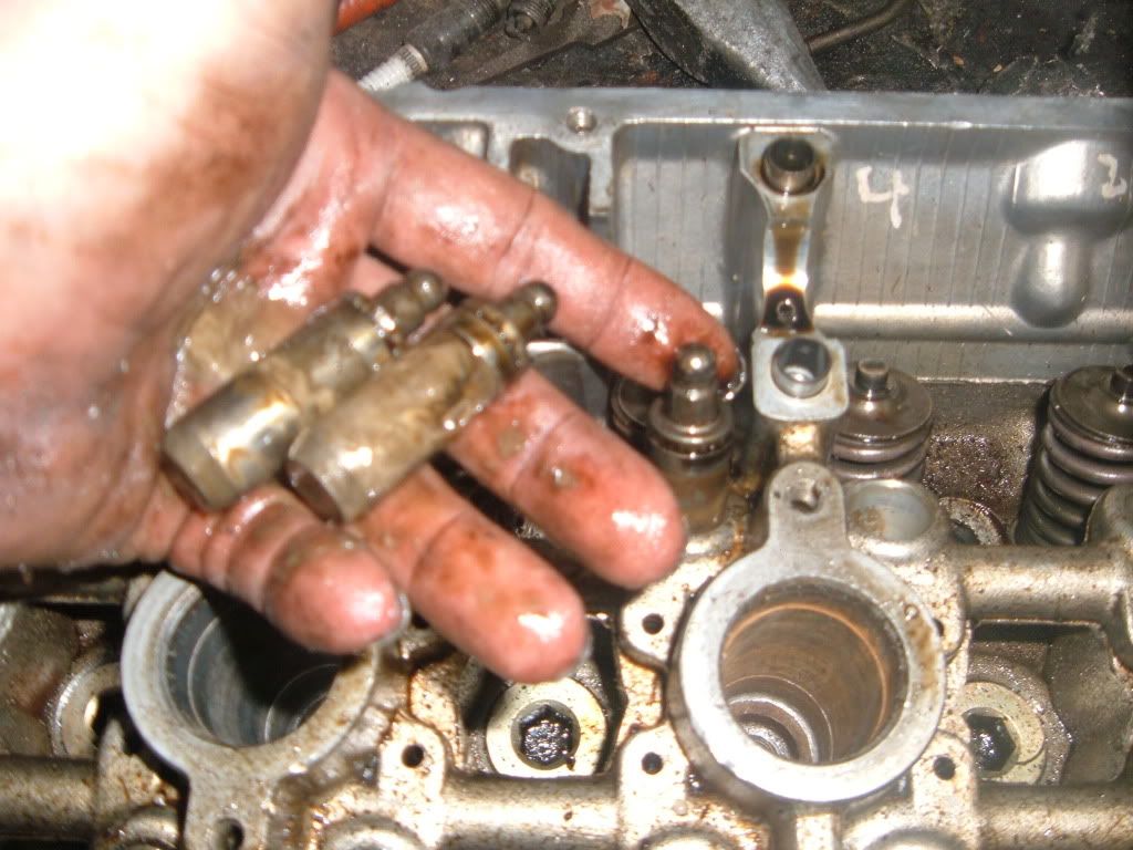

Now you can remove the HLA’s
Now remove the oil spliter
Now remove any other small bolts

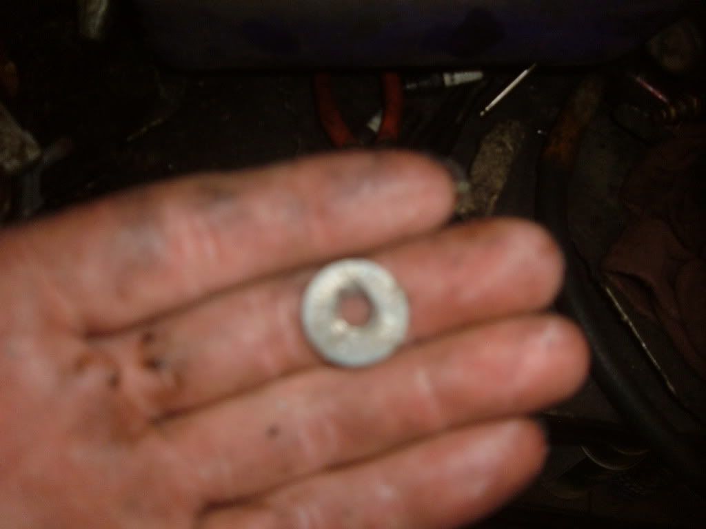

This is a “heat tab” Most machine shops use them.
The center will slide down at 240-250* and totally dissolve at 260*

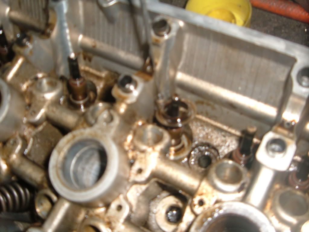

Next is to remove the valve train.

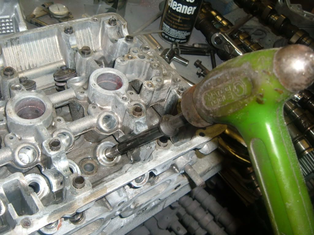

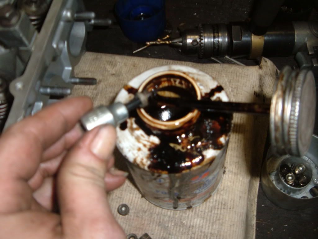

Yes the same method that a lot of DIY people use are used in a machine shop.

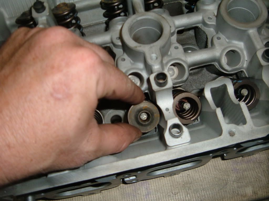

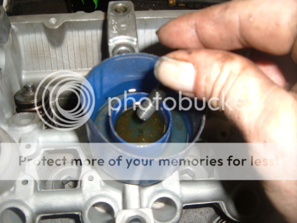

Use a basket and a paint cap, have a pocket magnet handy too.

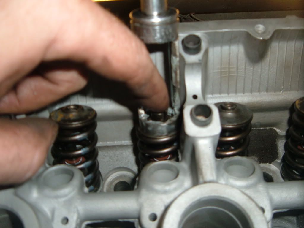

Have your “tool” and hammer ready to go

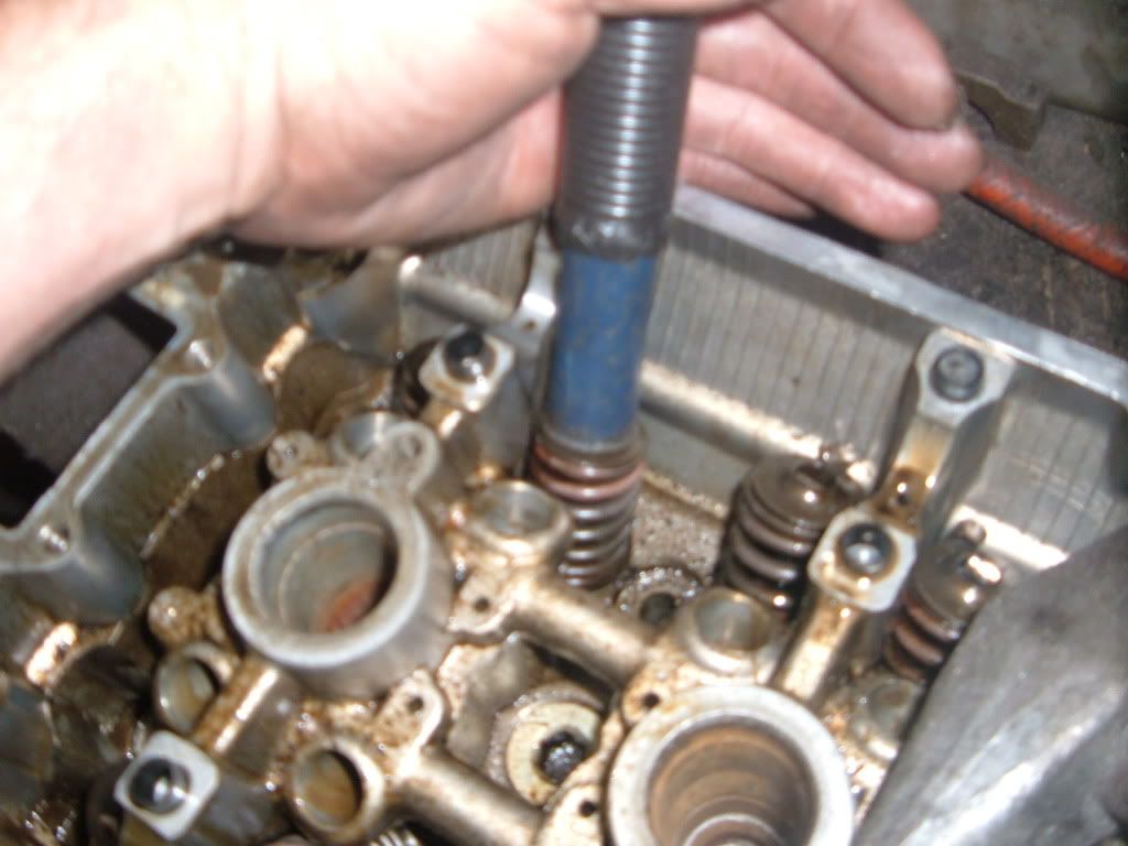

Place the tool on the spring retainer and give it a firm whack.
The locks will stay in the tool and release the retainer and spring.

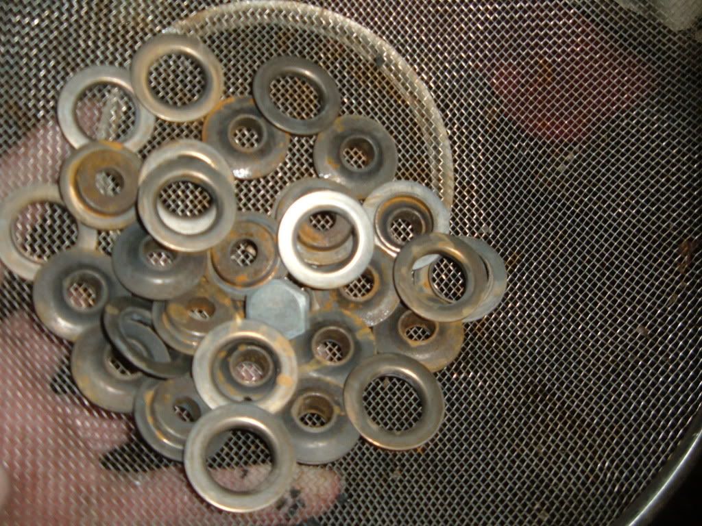

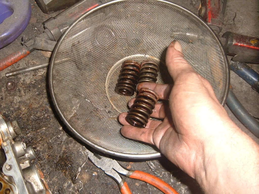

Place the retainers and spring in the basket

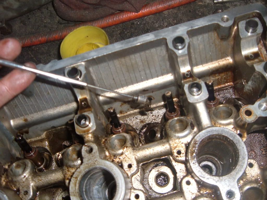

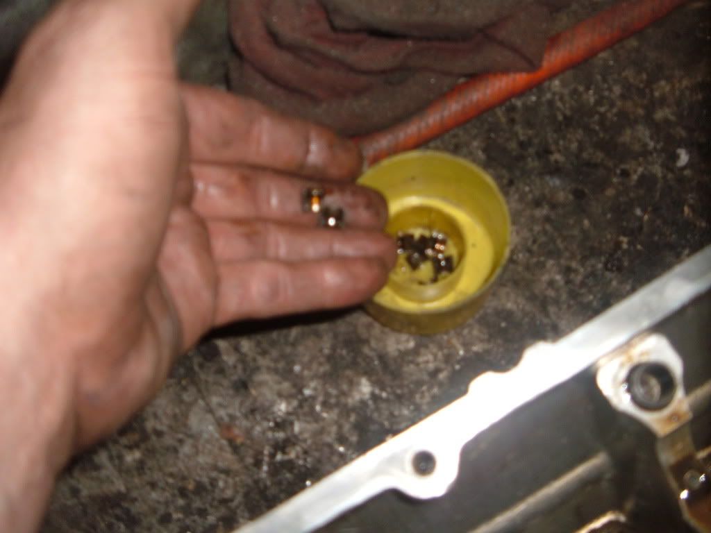

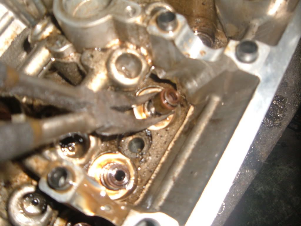

Fish the valve locks out of the head casting with the pocket magnet.
Place the valve locks in the paint can cap.

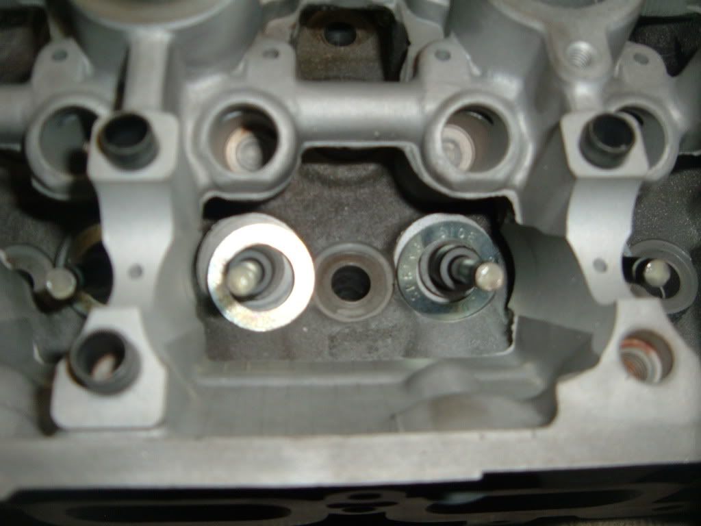

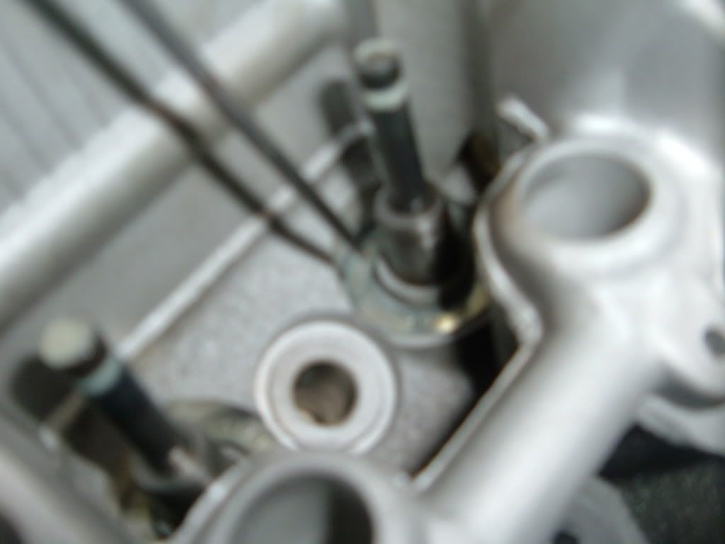

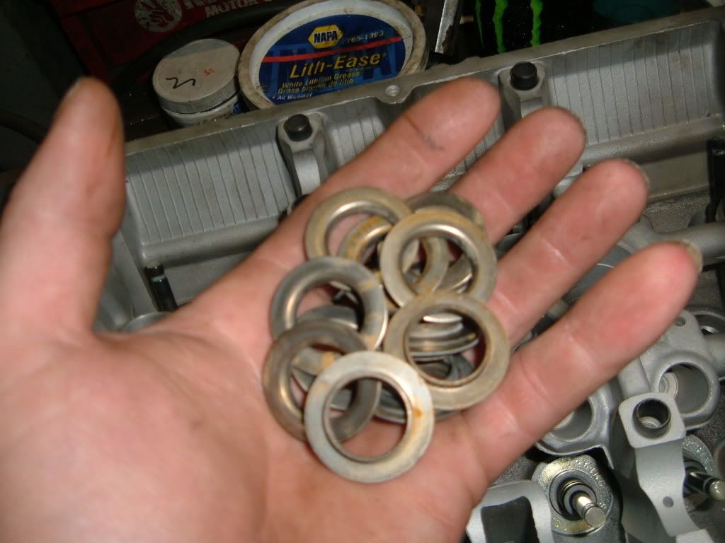

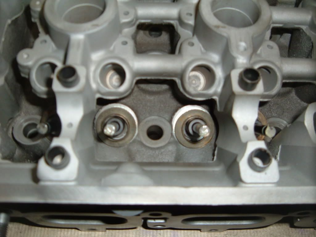

Now remove the spring seats with the pocket magnet and place in the spring basket to be cleaned.
Next roll the head over and remove the valves and place in the basket.
This head was rebuilt once before, it must have had bent valves.So I will change the valve guides.

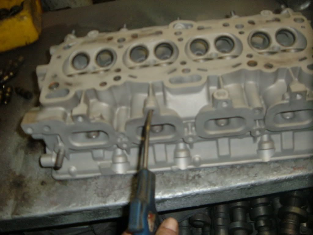

Now roll the head back over and remove the valve stem seals, throw these in the trash.

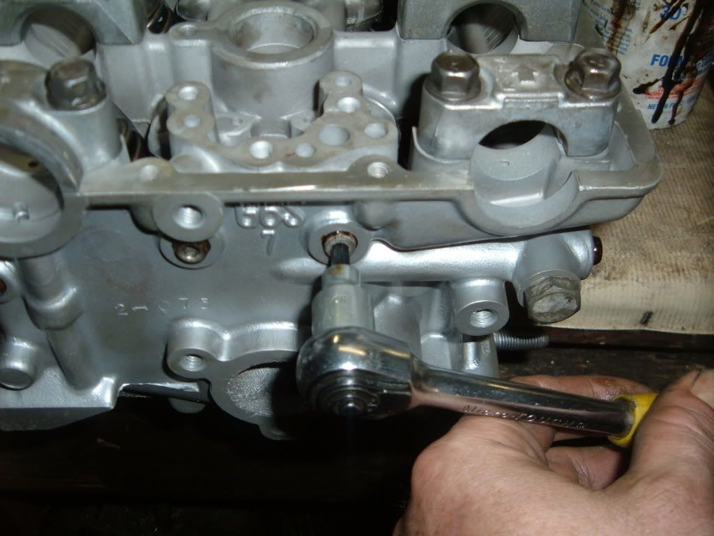

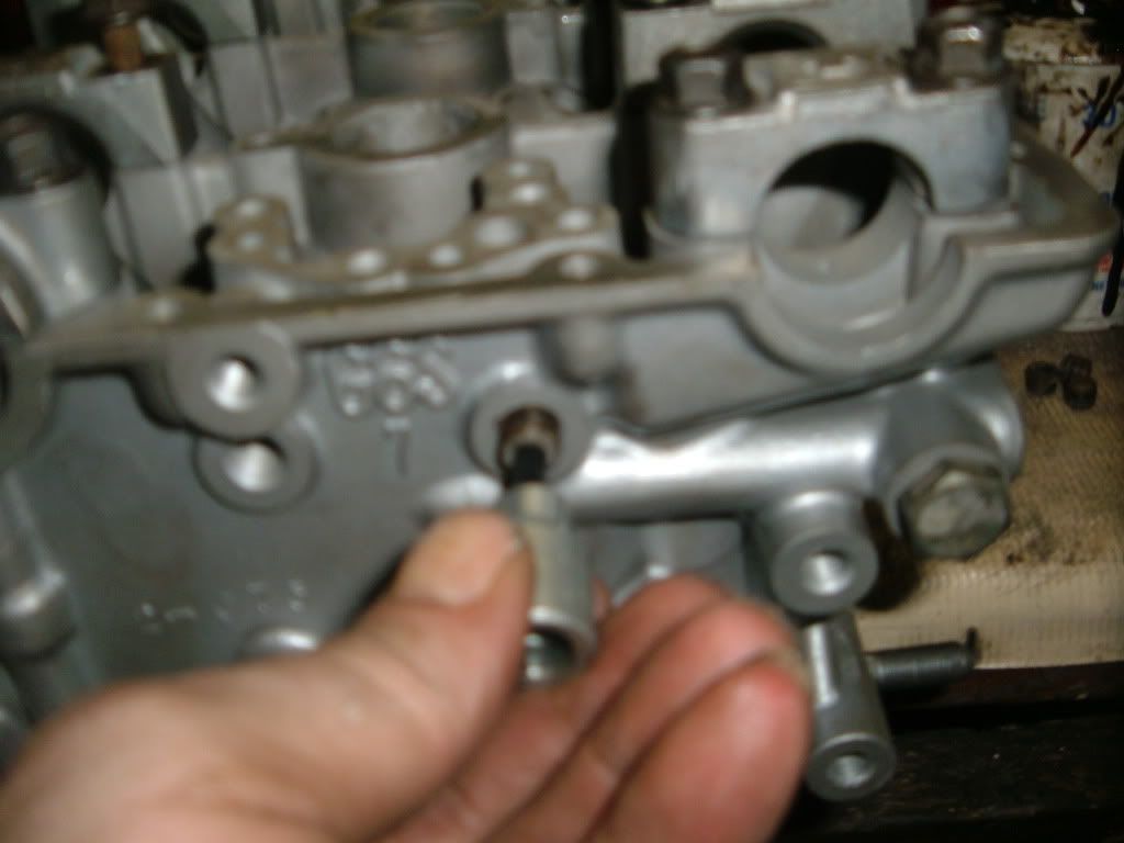

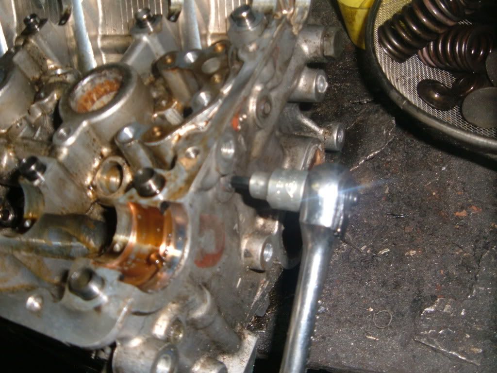

Next grab the 5mm allen bit and remove all the oil galley plugs. Keep these to be installed later, place in the paint cap with the valve locks.

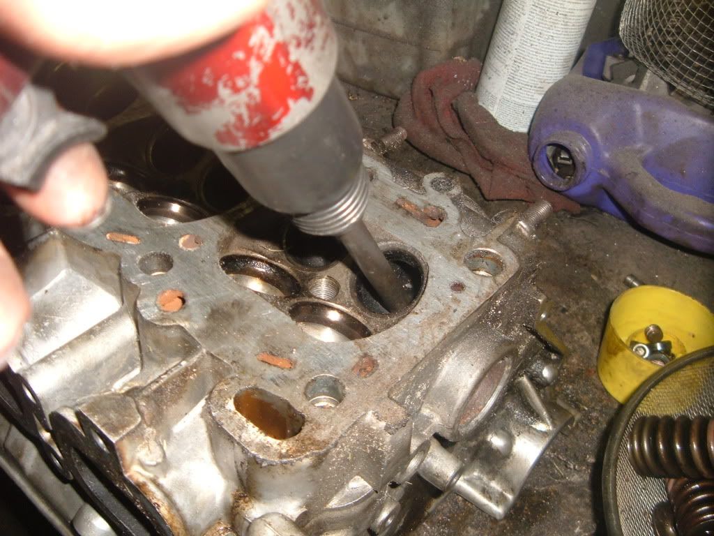

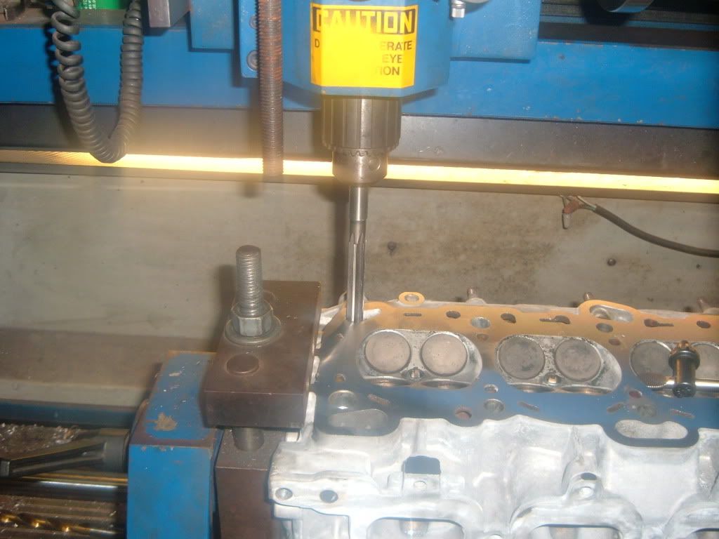

The last thing done is to remove the cracked valve guides.

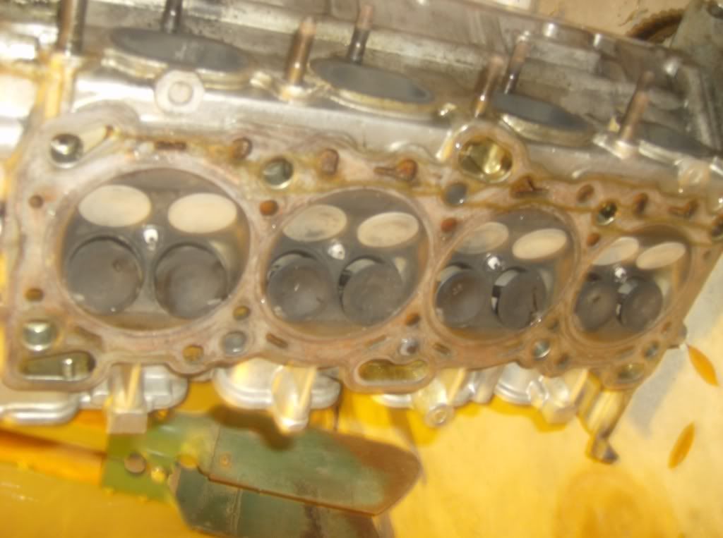

Now that the head is fully stripped, it can be tech’ed

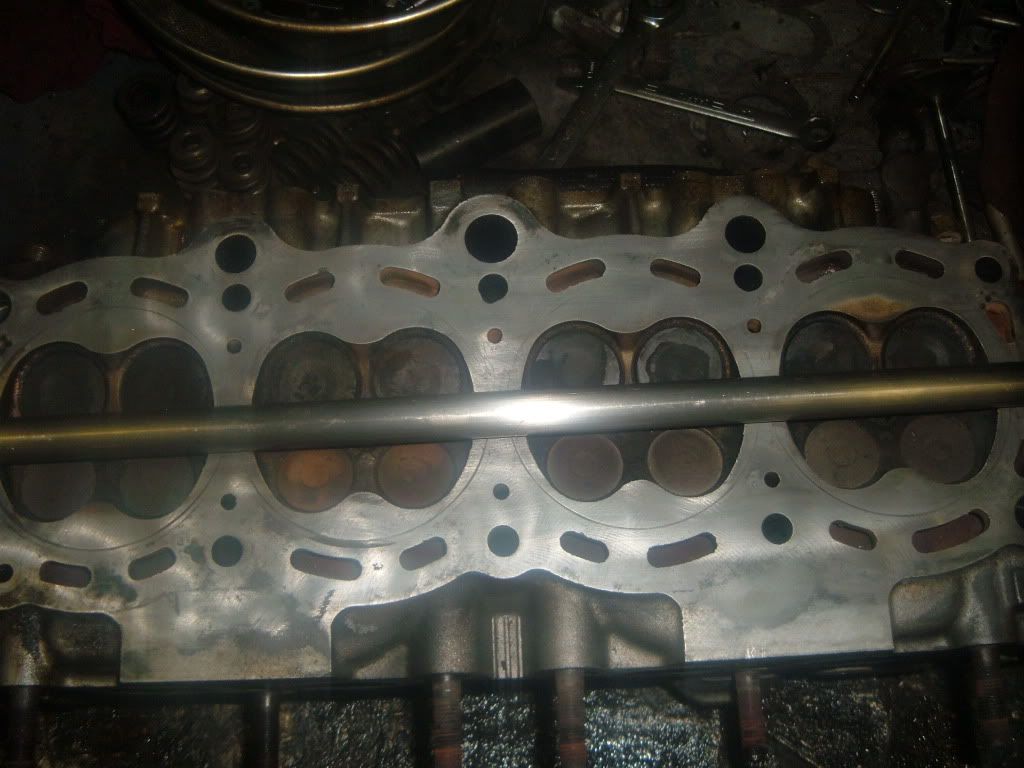

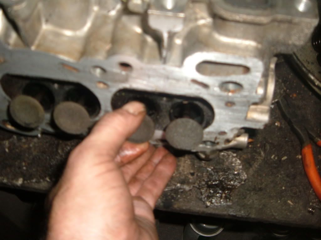

First thing is to do a quick clean on the head gasket surface.

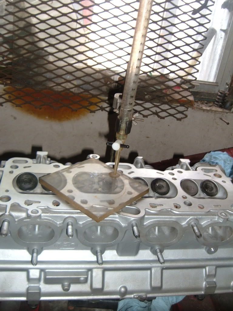

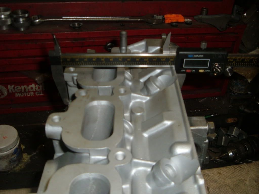

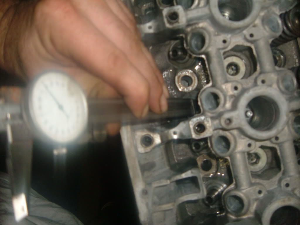

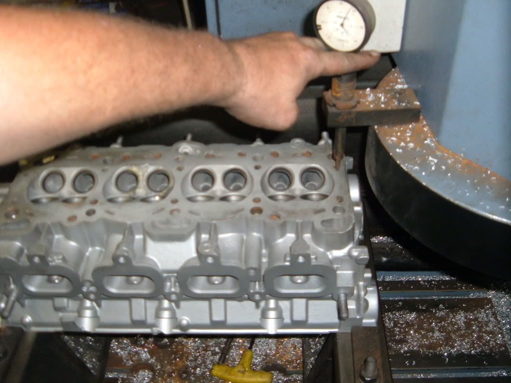

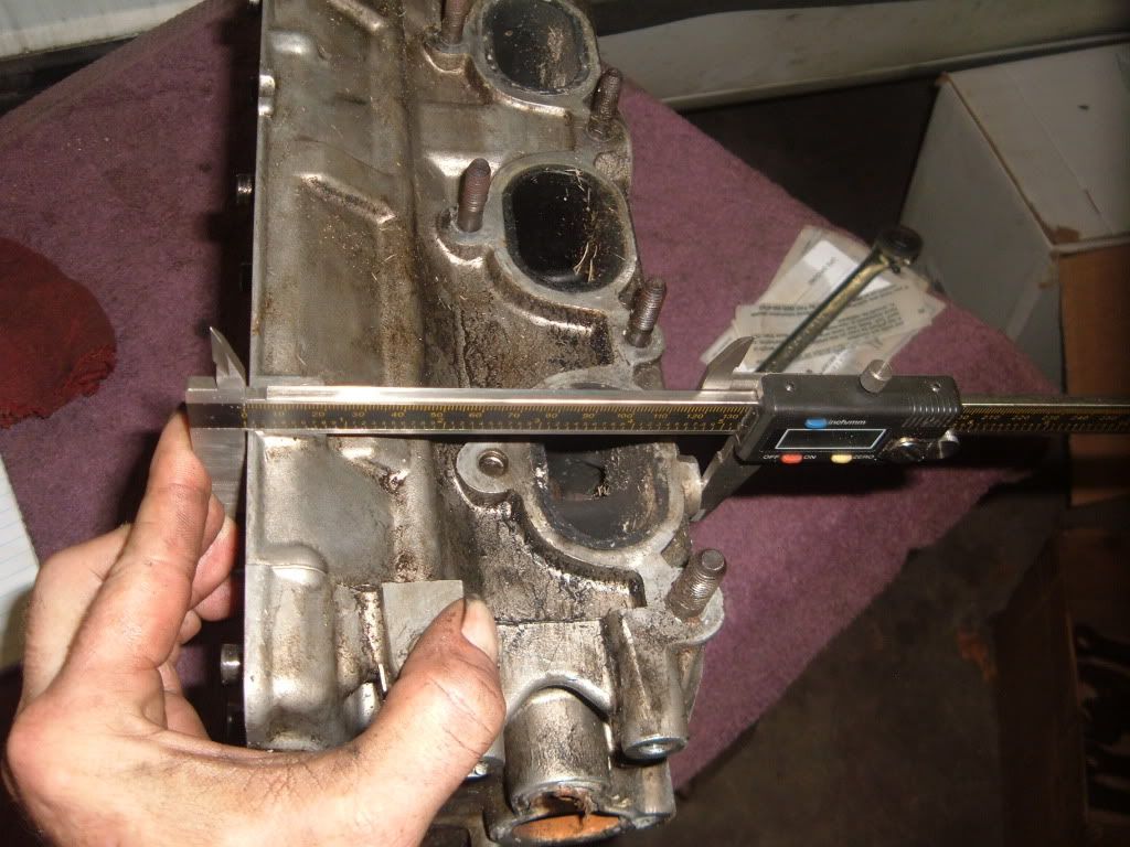

Next is to measure head thickness.
Now to check to see how bad the head is warped.
Notes are taken to reference back too.
If it all checks out, it goes to cleaning.

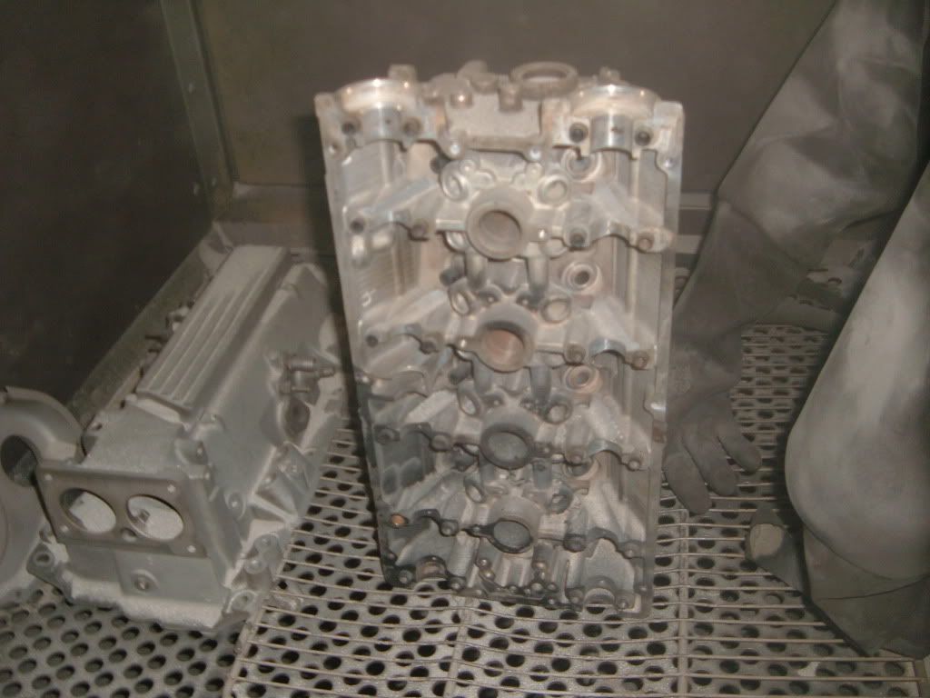

It gets thermal cleaning, then glass beaded.

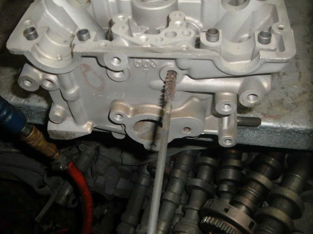

Next all the oil galleys get gun brushed
Now the entire head will be blown off with compressed air, including every bolt hole to make sure there is no glass bead media is left in or on the casting.

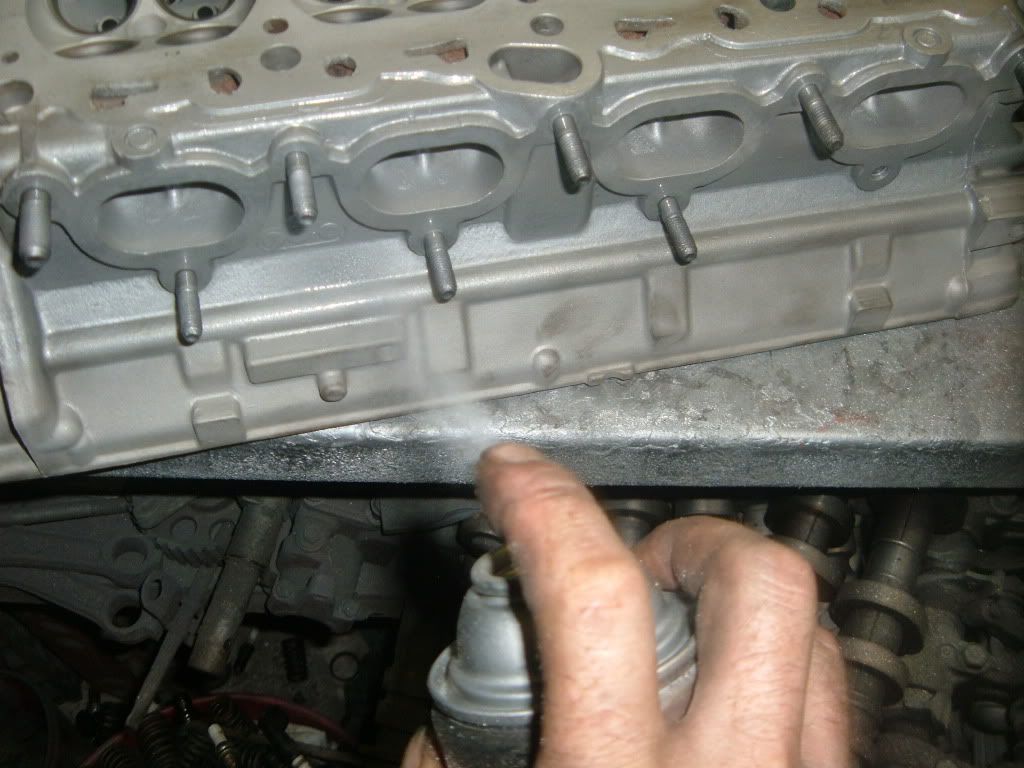

next is a coat of spray paint to seal the casting.

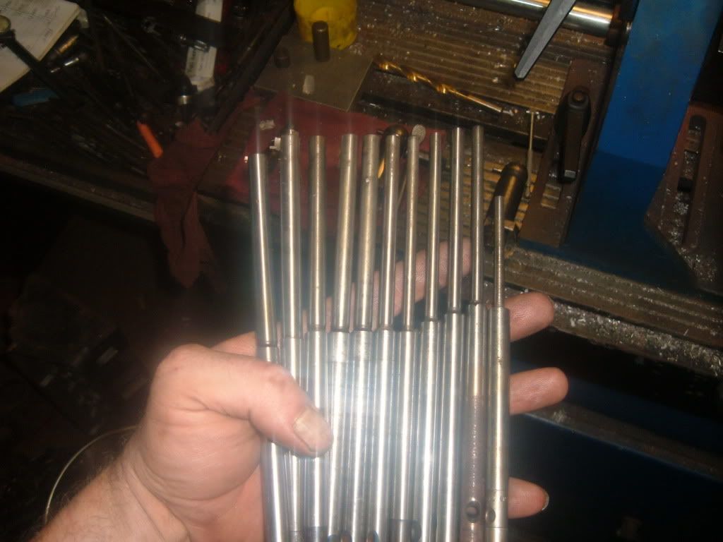

Now new guides can be installed.
They are set to height.

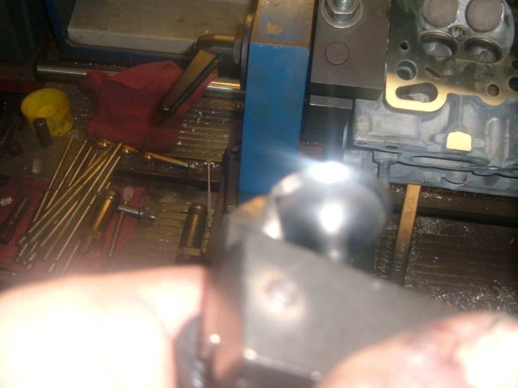

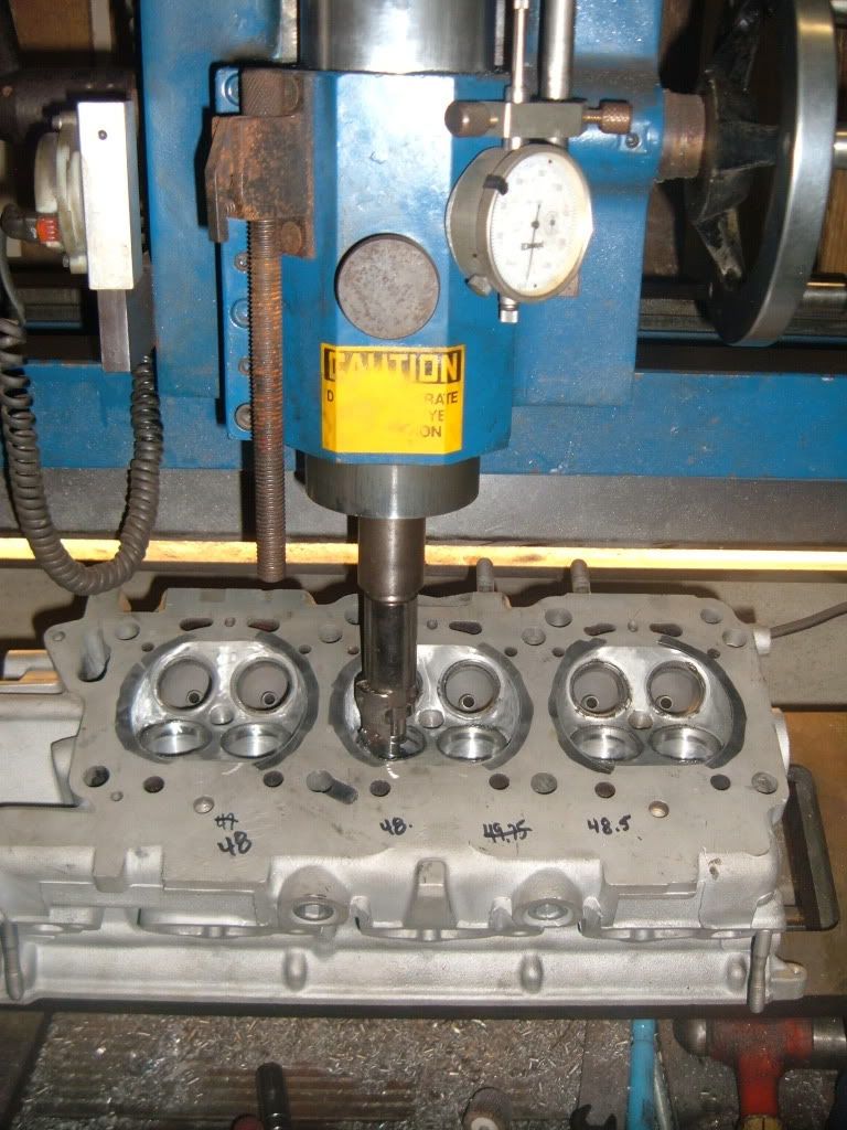

Now the valve seats can be cut.
Fist is to set the head in the machine and secure it properly.
The proper sized pilot is selected.
The head is now leveled in the machine.
Now to set up the seat cutter.
First is to find where the seat is to make contact on the valve.
Now the cutter bit can be set.
The seats are cut.

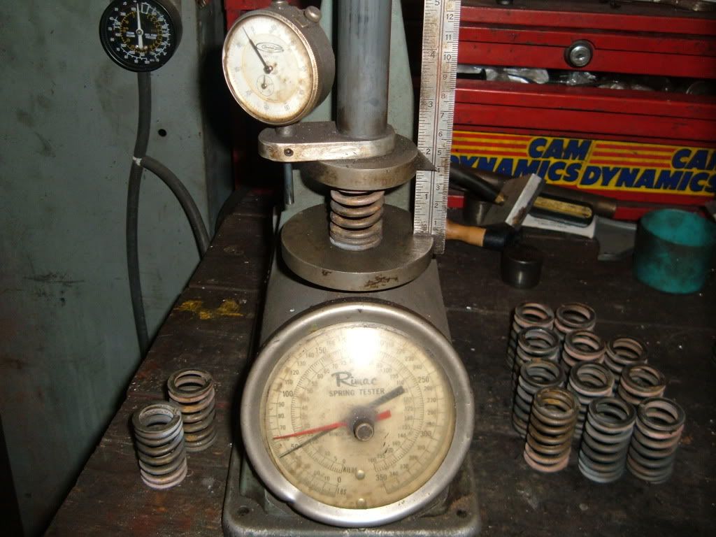

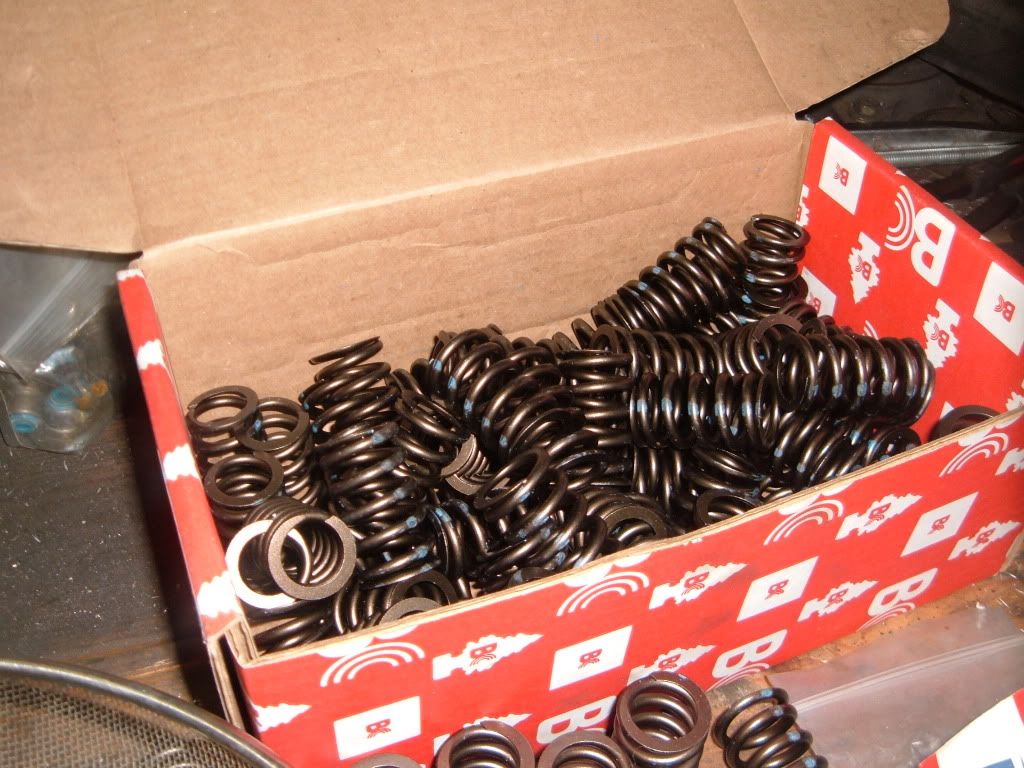

Valve springs are tested.

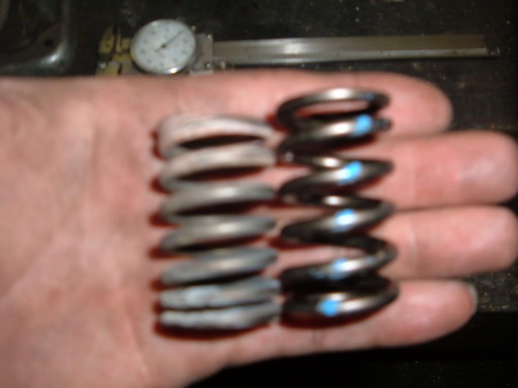

Most valve springs have been found weak, so New BC1100 springs will be installed
(stock spring on left, BC spring on right)

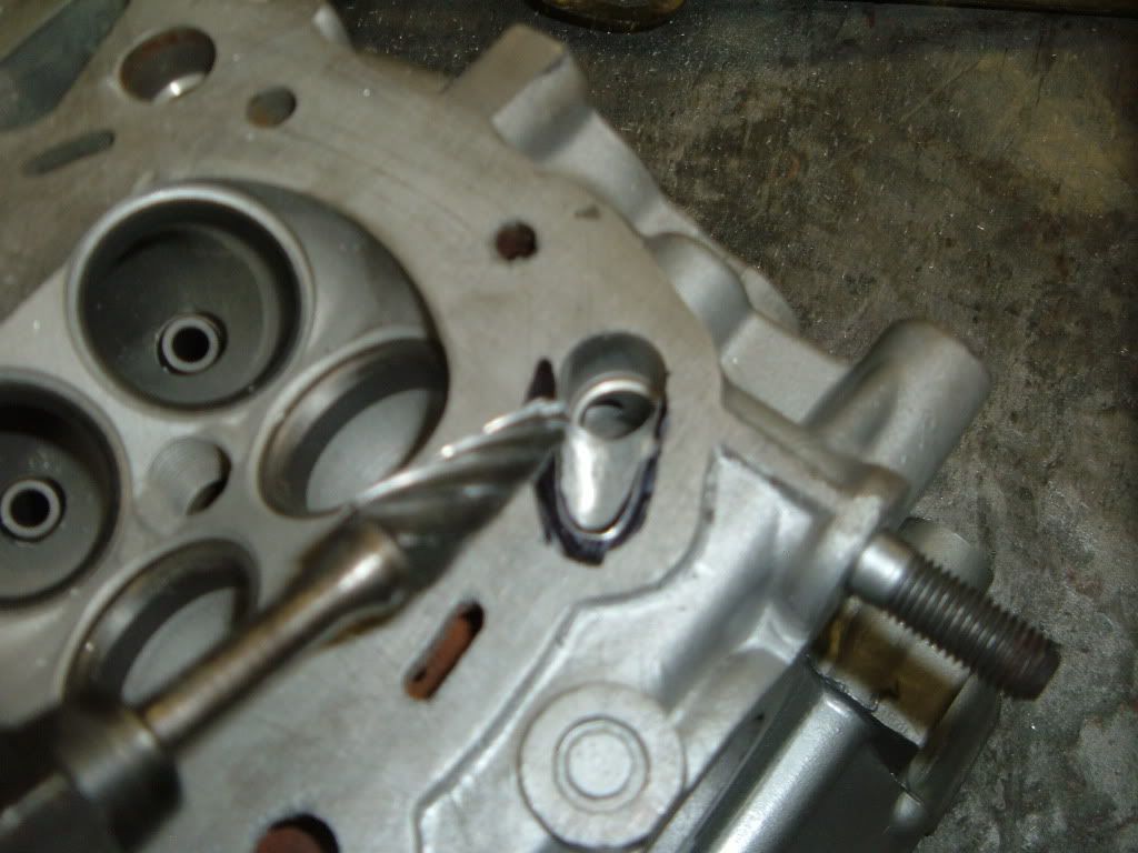

A broken exhaust stud was found and removed.

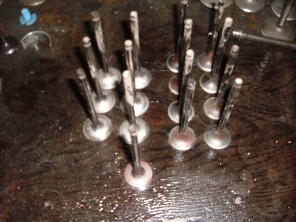

The valves are ground.
Ground and ready to be installed.

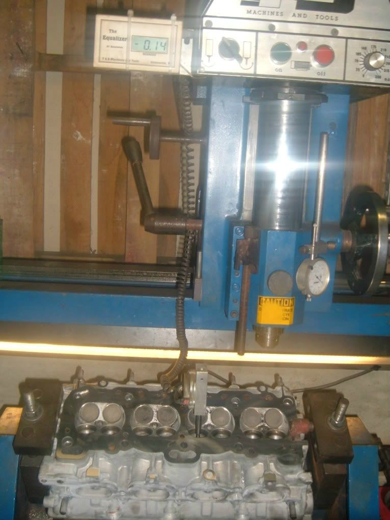

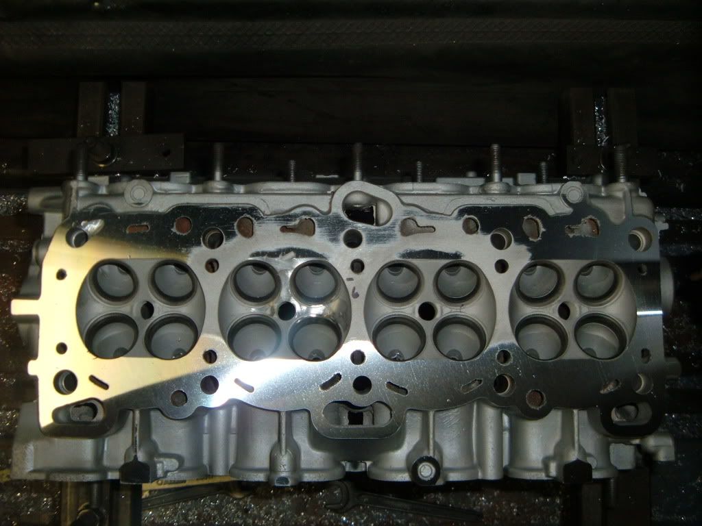

Now the head can be surfaced.
The head is set up and secured to the milling machine.
The proper surface finish is milled for the head gasket to be used.
(a composite for this one) You can see that this head was belt surfaced before.

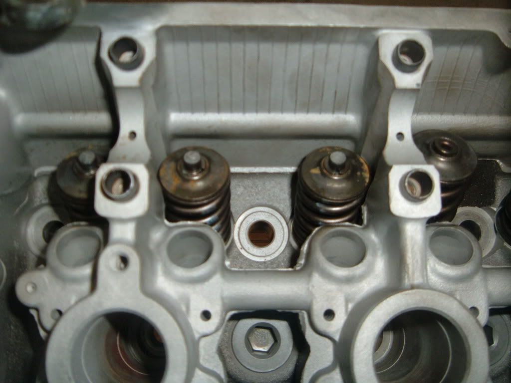

Valve tip height is checked to make sure it is in spec.
The valves are removed, lubed up and slid back into the same hole they came from.

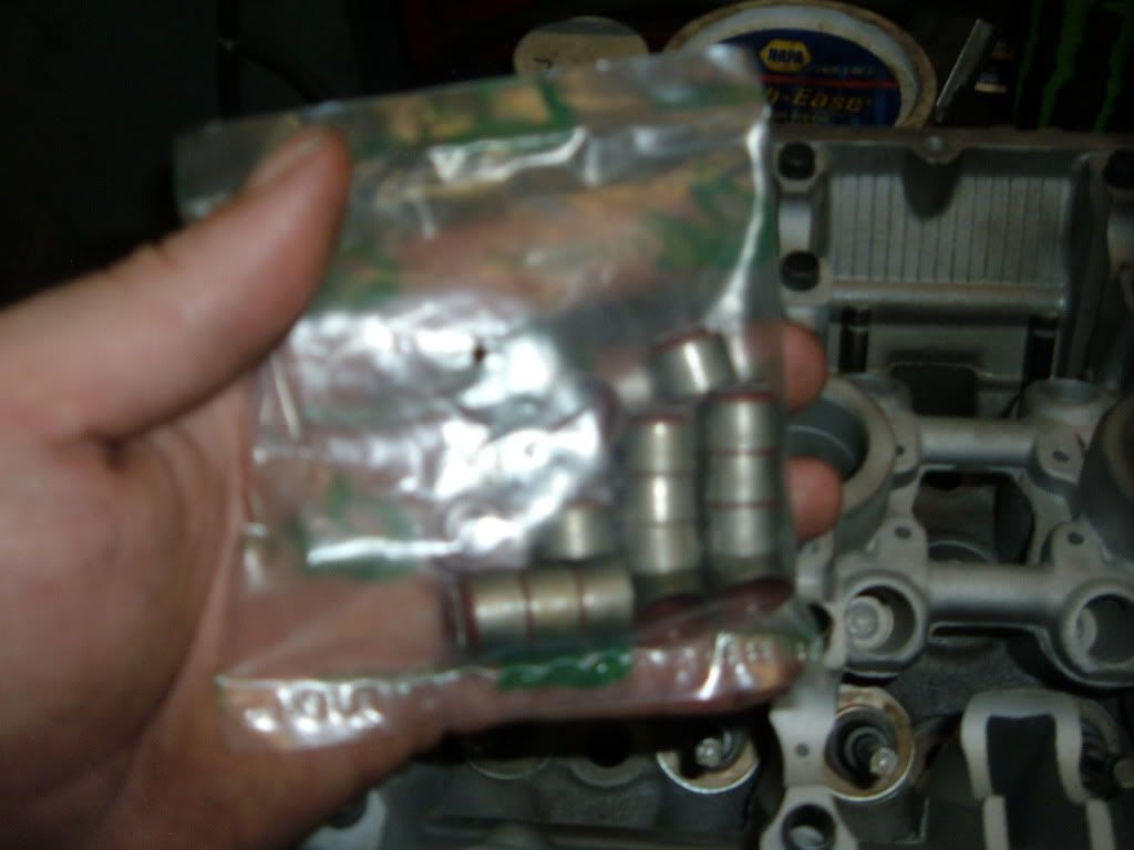

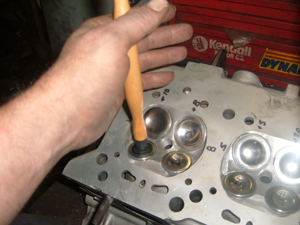

A package of valve seals found in a head gasket set.
Now the seals are pushed on by hand
Now seals can be installed, this is my “hi-Tech” seal installer.
Now the seals are tapped into place securely.

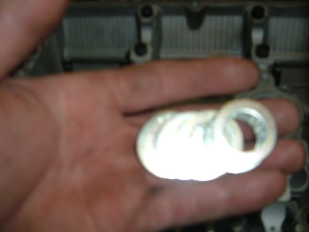

Now spring shims are installed if needed.
The spring shim goes on before the spring seat.

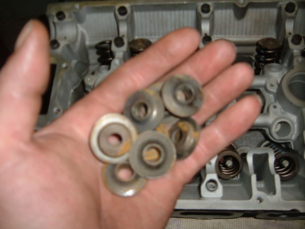

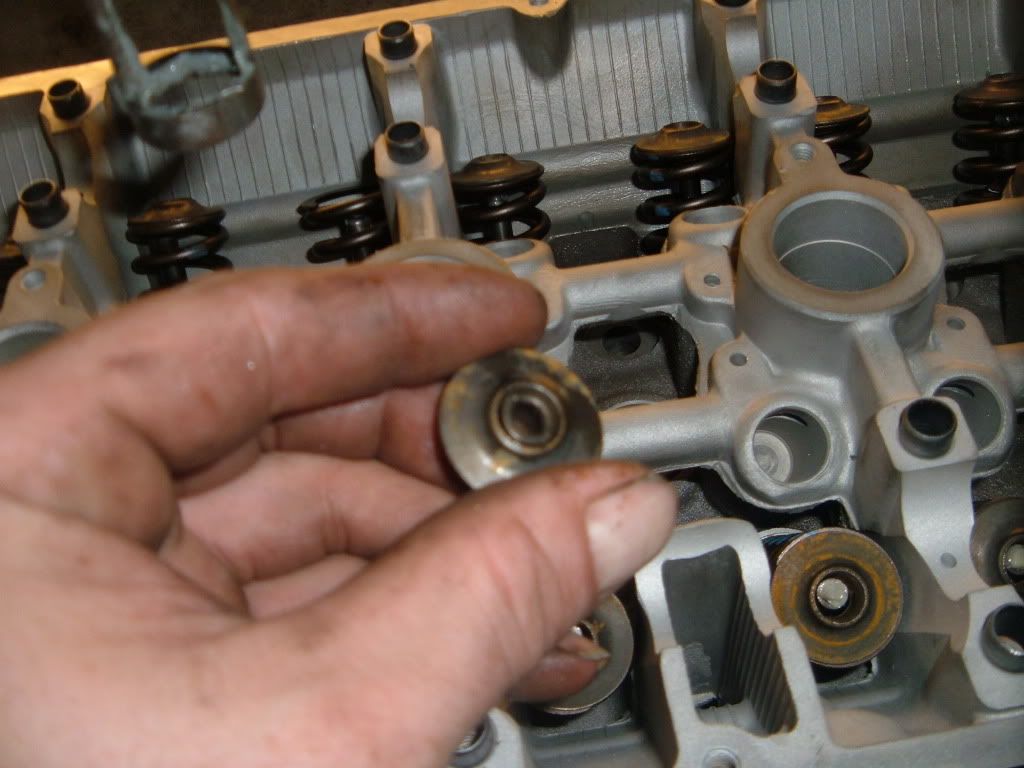

Now the cleaned spring seats are installed.
On top of the spring shims.

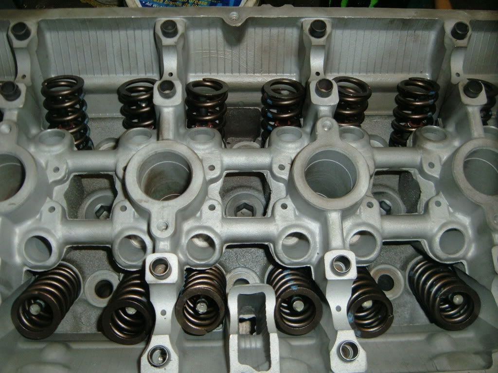

The new valve springs, BC1100
Now the new BC1100 springs are placed in the head, on the spring seat.

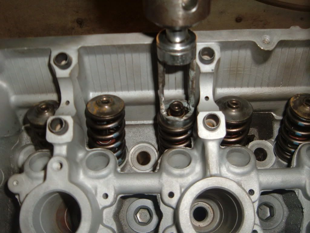

I will set the head back in the TnS 2000 Seat and guide machine, Using this adapter I will compress the valve springs.
Now before I compress the spring, I will take the valve spring retainer.
Install the valve locks,
Then place it on top of the spring.
Now with the spring and retainer compressed,
I can push the valve locks into place.
Repeat the process till all the springs and locks are seated properly.

3) Using an air wrench to remove the Cam gears. Have you ever sheared a Cam knock pin? I'm sure there will be some that are stepped because of this. On a 4G63 Use a spanner and soft block to lock the cam. then I use in addition a motorcycle clutch boss locking tool to steady the gear and a good size wrench to 'feel' the nut loose.

5) ALWAYS hand lap the valves in.. just to conform the evenness of the valve seats.
6) Rusty spring retainers. Now you could use a bung to guard the collet surface and blast them.

Great job man! Quick question though. I know if you even mention a blast cabinet around some people with a valve cover or something you will hear that it's impossible to get every last bit out after it's blasted. What is different with a cylinder head? I would think down in the hidden passages where old oil was would attract the glass bead. Is there a thorough way to get this out?
Edit: Seems Rich beat me to it. /ubbthreads/images/graemlins/grin.gif

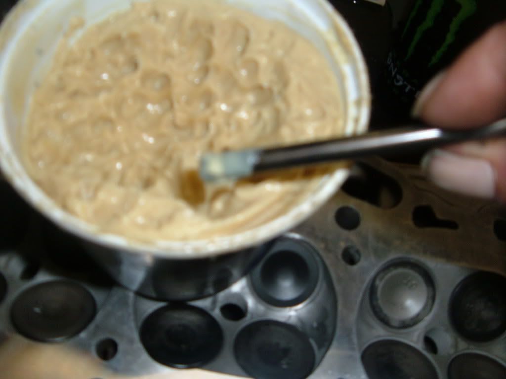

Yes the tear down area is a horrid area to even attempt to keep clean. By the time to you tear down two to 10 heads, loose oil and grime gets every where I will agree.
There is a step missing between tear down and glass beading, that is the thermal cleaning of the head, When a part is thermal cleaned, it is cooked so all liquid is burnt dry and turns to a powder.
On some heads there will be blind oil galleys, but a .22/.25 cal copper gun brush works best to insure the galleys are clean. If there is a hole I feel that may have an issue I do flush with brake clean. Now I will agree if a head is washed in a vat or spray cabinet that it should never be inside a glass beader.
In 20 years of burning heads and glass beading them, I have not had a head come back or get cussed out over leaving grit in any oil passage and locking up a cam or causing a cam journal issue. So I am comfortable with the cleaning procedures I have in place.
As far as shearing a dowel pin on a cam, I can not recall a single one ever shearing off. Not just on the 4g engine, but even on the divit style cam gears such as the dodge 4.7 SOHC.
Yes that paint cap was nasty, they normally get pitched every 2 or 3 days, the cap is only used to lube cam tower bolts, not cams, cam journals, or buckets. I have a pistol grip oiler I use for that.

The reason for the flash rust was I had a sales rep come in and demo'ed a new cleaner for my spray cabinet, come to find out it did not have the rust inhibitors in it, so I went back to my old product, so that is not a issues except on 2 or 3 heads, and the rust wiped off with a basic red shop towel.

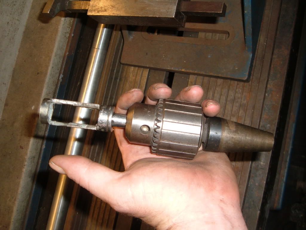

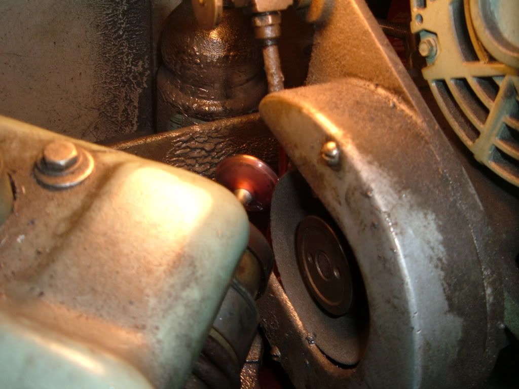

3) Maybe you wax the slides but the rust on the wheel shafts on the seat cutter and the threaded stops etc says there isn't alot of maintenance there.
4) Maybe you don't lap the seats, but you cannot use the same cutter to do the seats and the valves together, and the wheel you do the valves with is only as good as the dressing it's recieved and the prep you do. Therefore they cannot be spot on. Again I have issue with the evidence I see. I sir would be lapping for surity.
5) I mentioned the cam pins as I've acutially had them shear on me,

7) Even if it was a lapse in the hot tank, you are still installing rusty parts in the photos you chose to post.
