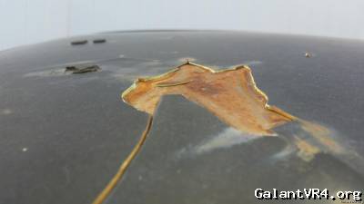

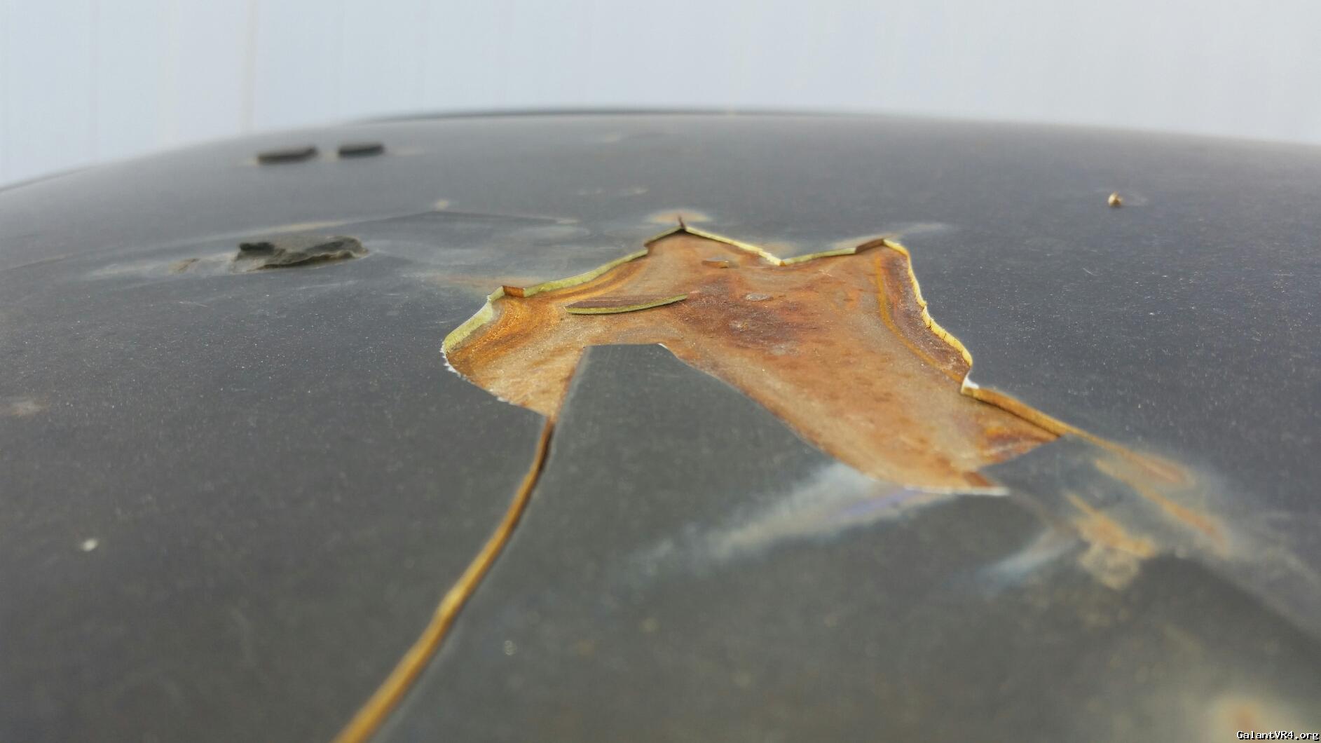

Its like a thick material??? Anyways i haven't been on in quite awhile. Car is still jsb and outside forces have kept me from getting the car running again. I do however want to keep/slow things down from getting worse. Just wanted to know the best route to go. Thanks

So just a really thick coat of paint? The stuff chipping off is like 1/16" thick, probably thicker.
Pics??
Sounds like plastic body filler, if it is anything other than a "skin" film coming off the paint.

Yeah, it’s just steel with primer, base coat, and clear. If you’re seeing anything else it would have to be shoddy repair work unfortunately.

That is a cracked and broken skim coat on the roof. My son has the same on 100/2000. Looked perfect until the PO got mad and dented the roof. Big piece broke off.

So best route would be remove it all, do the por fix, apply a new skim coat and paint?

You don't really need POR if that is what you are suggesting. You will likely need some serious dent removal before removing any rust and priming/painting properly.
