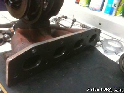

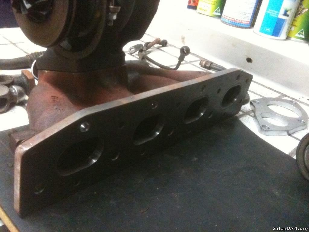

really didnt know were to put this in but here it goes, Im looking at a old school colt like 70's and would like to build one with a 4g63 motor and while searching ran into this build thread about some aussie dudes car, he used a stock manifold with an adapter plate to make it a top mount turbo setup. Anyone know were this can be bought or made?

Really doesn't look that complicated. Maybe a couple hours of measurements, CAD work (if you want to replicate it) and some help from a machine shop could easily get this done.

yeah I thought so too, get a 1/2" of steel and mill or cnc it, then countersink one side to mount the manifold and the other to the head but wondering if anyone has done it or seen this before thats all
I wonder what was the idea behind moving the stock manifold slightly forward? Is 4g63 port/bolt spacing symmetrical? If shifting the manifold isn't necessary it seems like an easy enough job for a drill press and some rotary files.

Ummm...just cut the flange off the stock exhaust manifold and flip it upside down, reweld, profit /ubbthreads/images/graemlins/dunno.gif
Quoting grocery_getter:
The bracket in the picture is for flipping the manifold upside down. Not for moving it forward.
The bolt holes *look* offset, maybe it's the angle the picture was taken at though.

That particular guy made his own.
here they talk about how/what to make it of: click
looks like this:

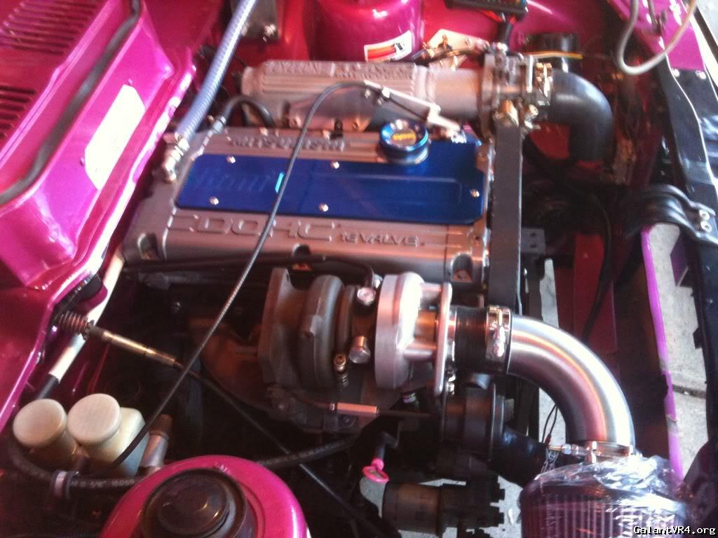

fuel
Feb 23, 2009
2,166
Toronto, ON, Canada
no but it would make the turbo point the right way in RWD applications with using the VR-4/Evo1-3 engine in RWD application, while still being low mounted. This wont work with RHD oldschool Mitsus though, because the steering box will be in the way.
