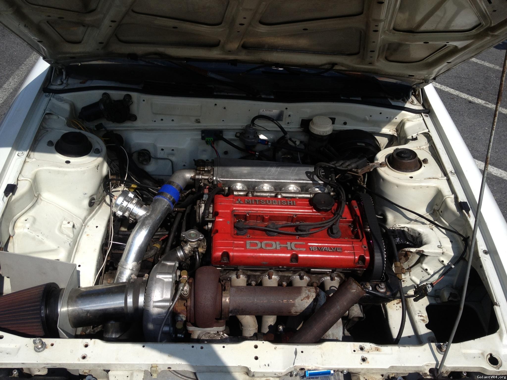

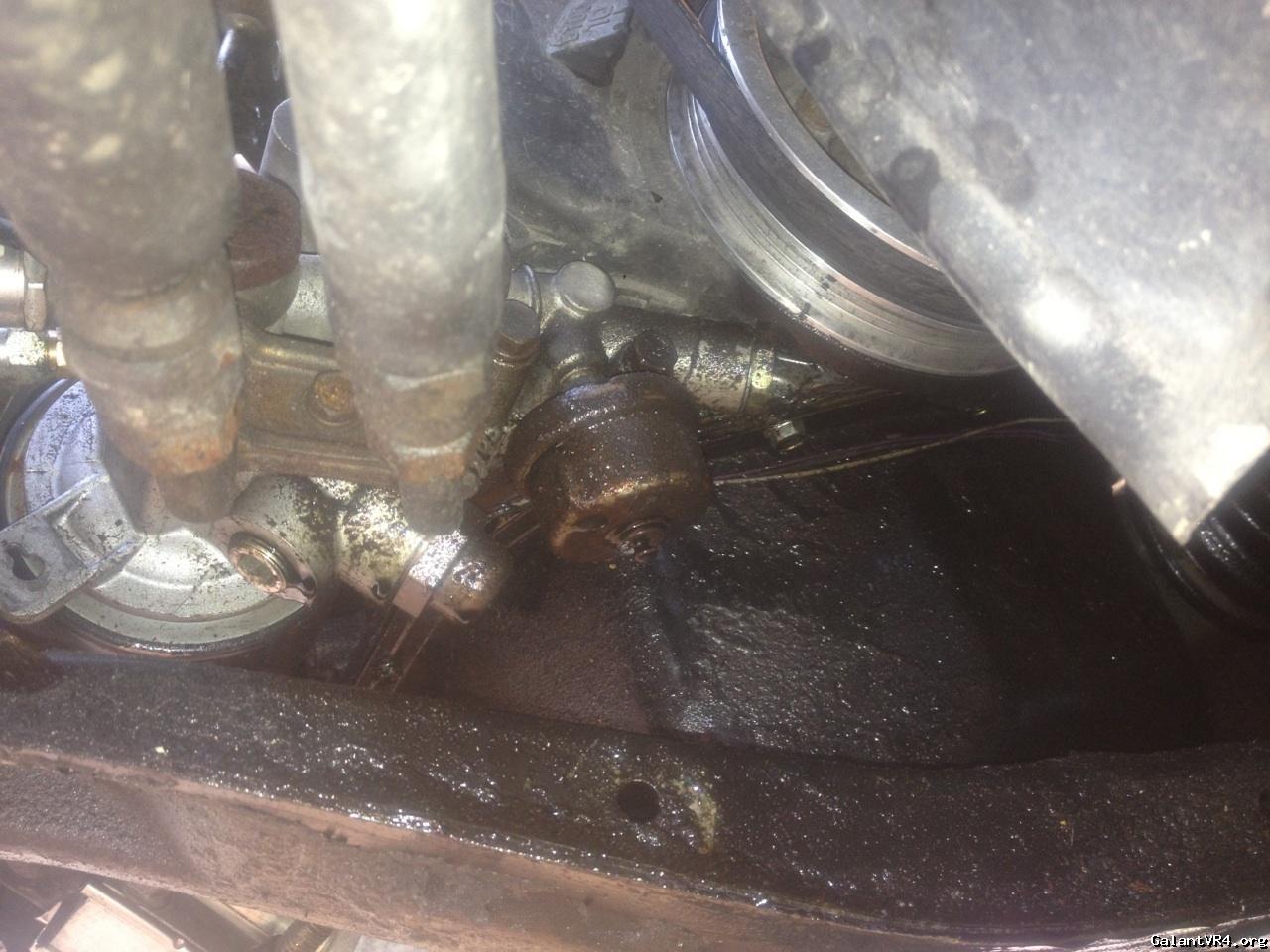

My friend is limited to phone so I am uploading and doing this for him he will be on the forum. Purchased over weekend

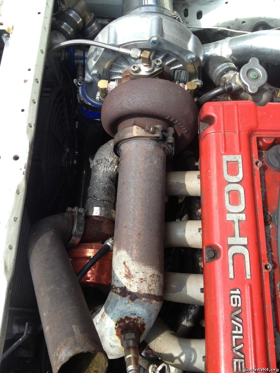

Needs help rerouting the dump tube and how to go about doing it. and appears some oil behind the cam gears. And back side of head.Needs a tune as well.

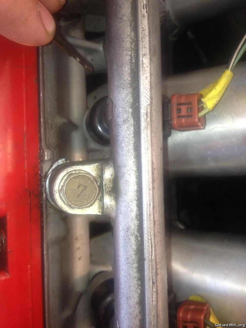

sorry cutlass this is all the pics I have right now there looked like gas build up something. I can provide better pictures soon...yea its a hell of a hood. needs a little love.

If that is gas you are pointing out in the pic, you should pull your injector out and make sure the rubber o-ring is in there tightly or even consider replacing them all. Leaking injector rings is not a good thing at all.

Quoting manikbastrd:
That is the most awesome hood ever.
Yeah note where the dump tube from that "interesting" exhaust setup is pointing to in relation to that dark spot... /ubbthreads/images/graemlins/jawdrop.gif

From the pics it looks like a timing belt failure waiting to happen!
