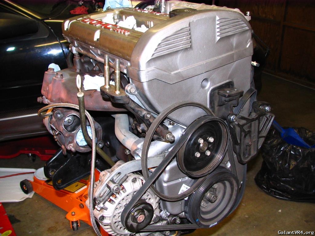

Have you checked the weep hole on the bottom of the pump shaft? I had a leak just like this, and suspected the alt. arm bolt, but it turned out to be the weep hole (pump was worn out). It's designed to leak at the weep hole as a warning.
The water runs down the side of the front case. If the timing cover is still on, you may notice water in the recessed area just below the pump.
As an answer to your question about the bolt, it looks like the water pump pulley does not block access to it:
Hope this helps /ubbthreads/images/graemlins/smile.gif
