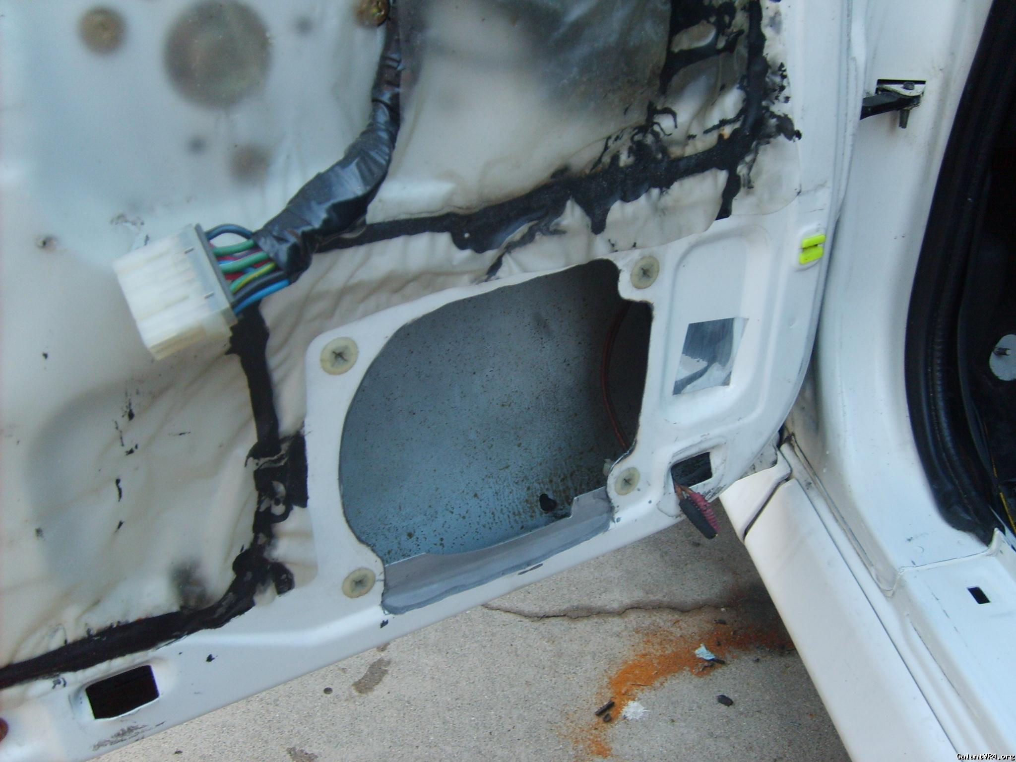

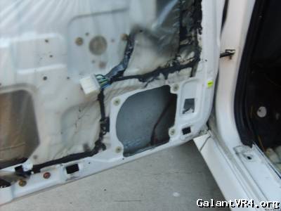

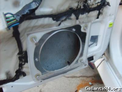

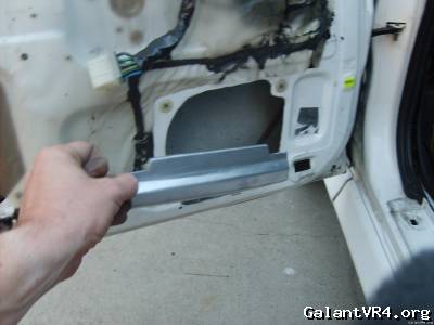

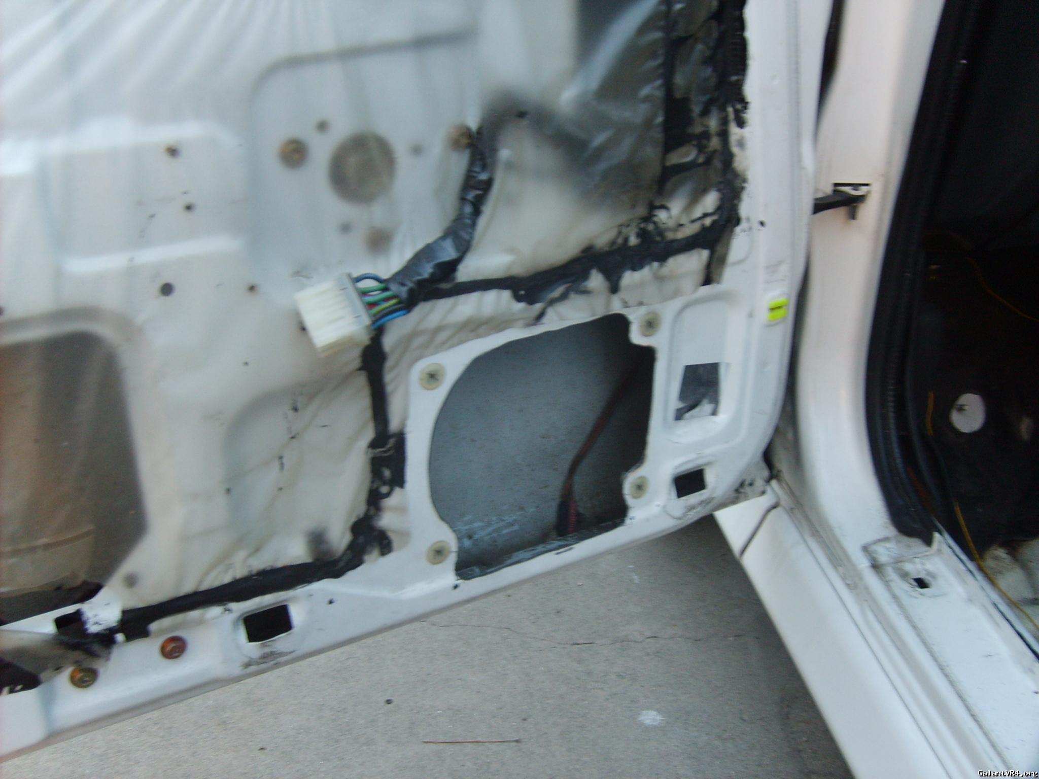

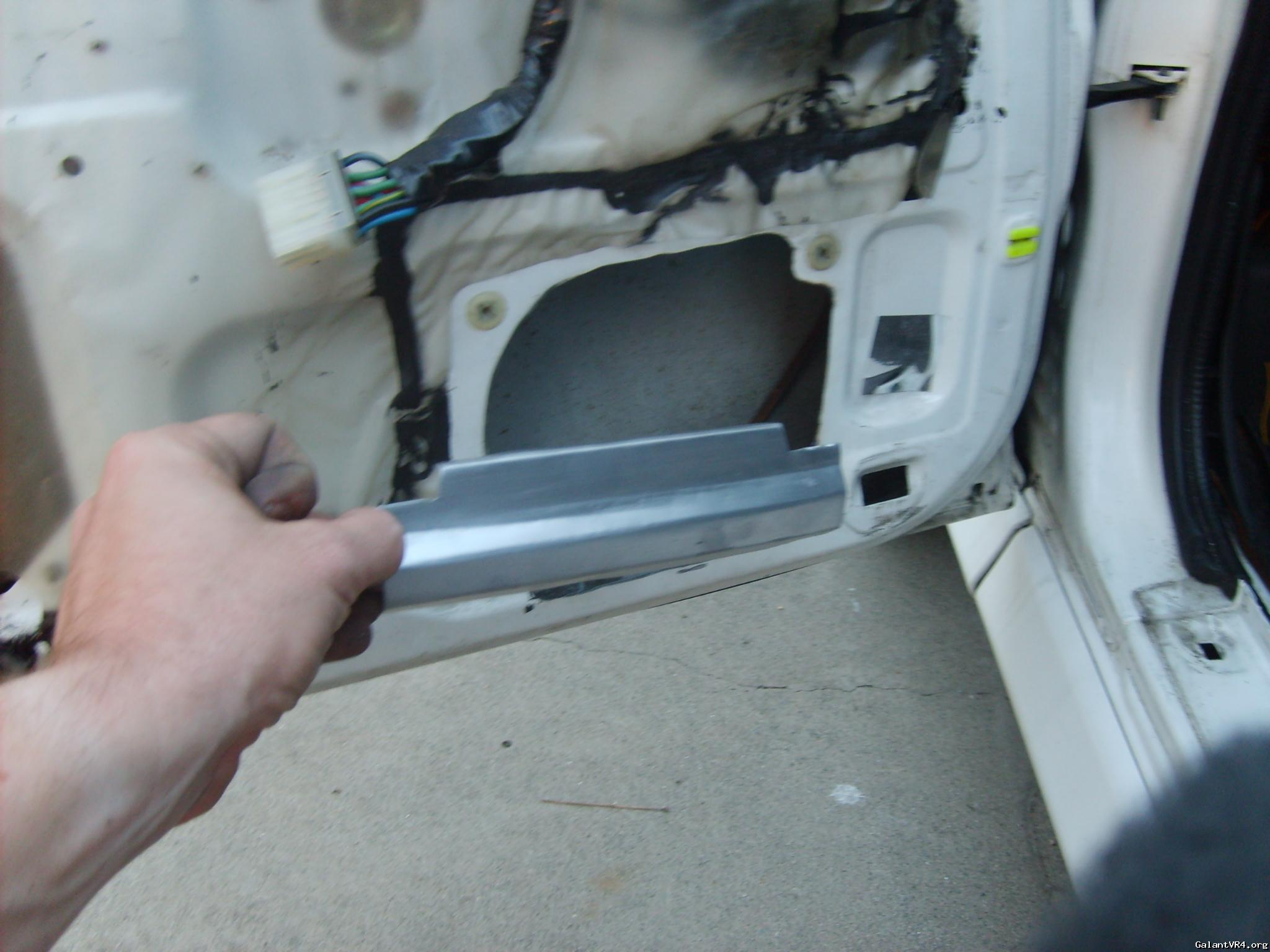

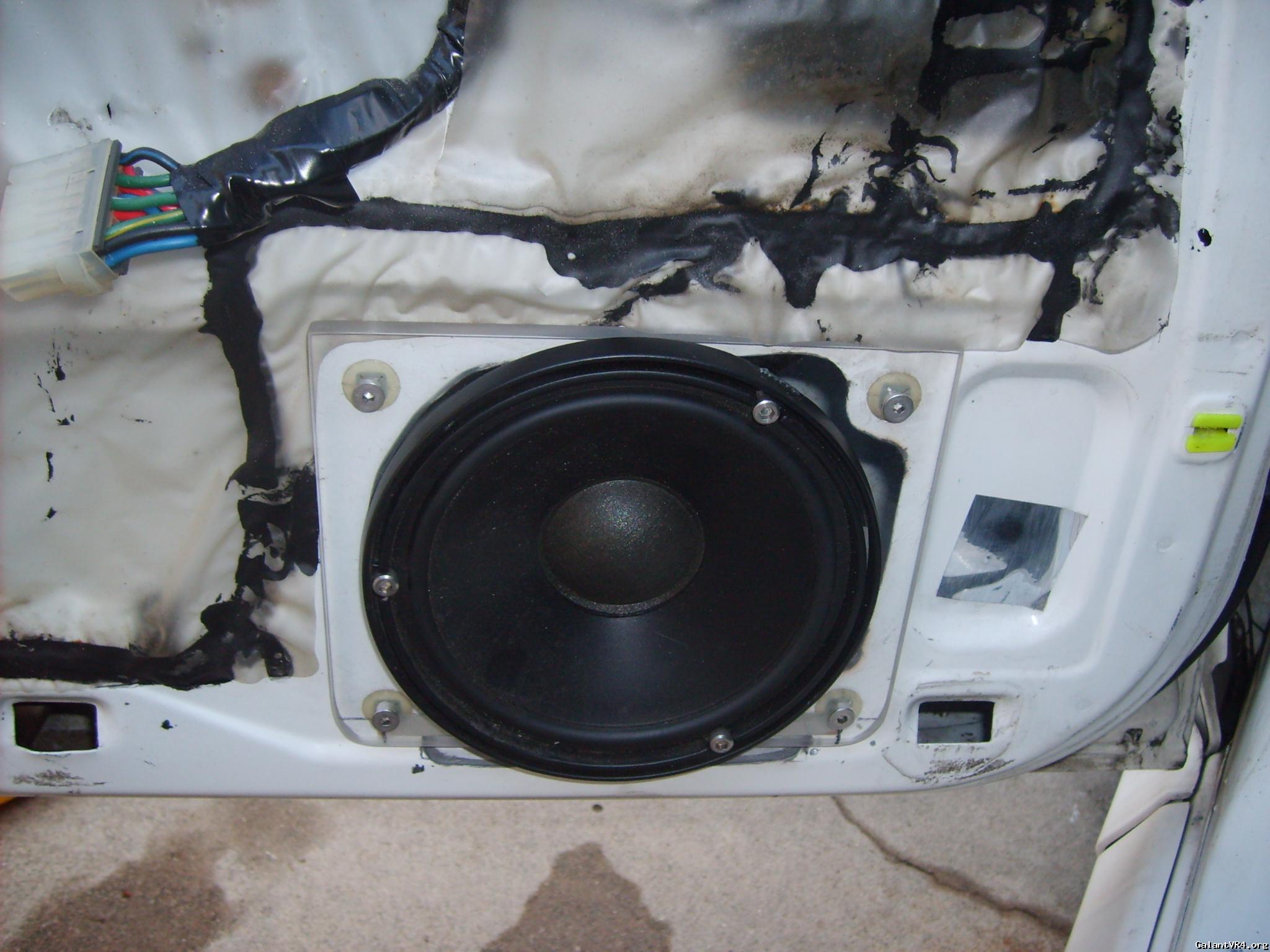

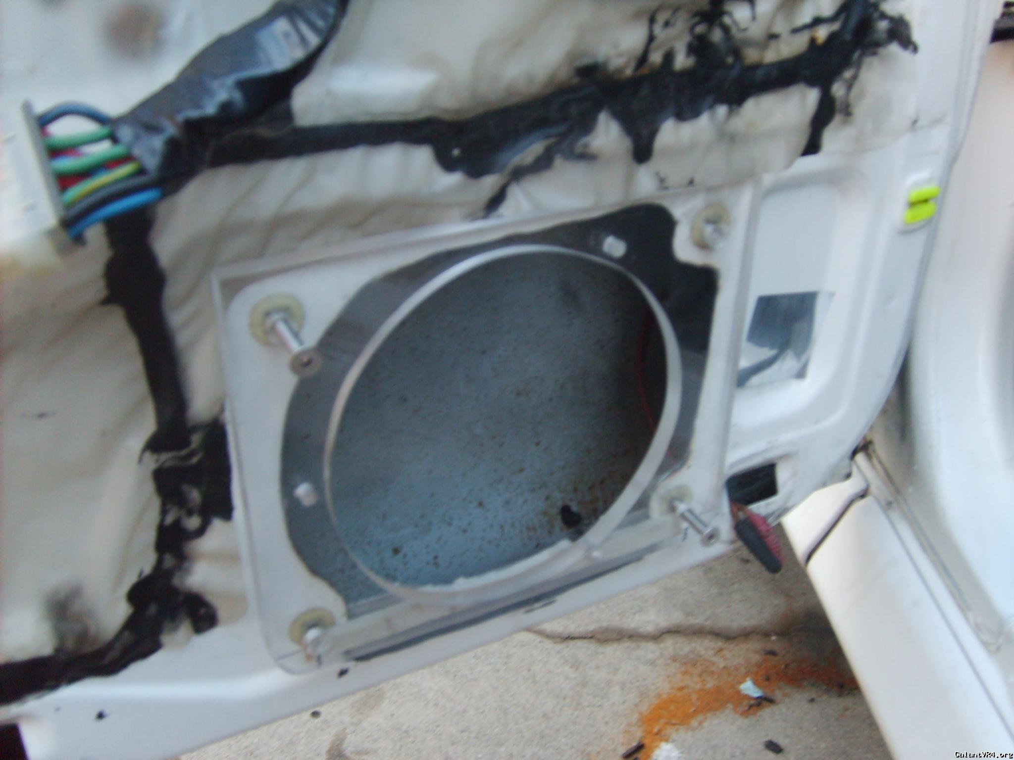

Do you have aftermarket speakers, where the opening was cut larger?
The wise PO did this and failed to address the issue, so when it would rain hard, water would come in...I fixed it by making an alum. plate + a plexiglass 'mount', with some foam tape and such, so that it seals now.
Also, the oem drain holes are sort of small stock, so I opened them up a bit.
No more water in the cabin!
JNR
Apr 23, 2004
9,833
ca
Sorry not the best pics, but hopefully gives a better idea of what I was talking about:
1. The hole that was cut was really crude, so I first cleaned it up.
2. Then made a quick aluminum 'filler' piece to lessen the size at the bottom
3. Piece installed with JB Weld IIRC, but could've been an epoxy of some sort (been a long time)
4. Mounting plate being installed, as a mock-up (the speaker attaches to this piece before fastening assy, to door)
5. All done
Anyhow, I wanted to run the oem door grills and they fit on there, barely...Just don't remember if I had to trim the inside part or not to clear; want to say no, but not 100%.
