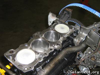

Engine:
JE 8.5:1 Pistons 0.20 over ceramic and moly coated
Manley turbo tuff Rods
Total Seal RIngs
Fel-Pro perma-torque MLS Headgasket
ACL Race Bearings
All ARP Hardware

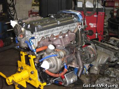

Ported & Polished 2G Head with Ferrara valves and Crower springs and reatainers

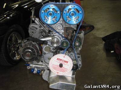

HKS 264 Cams, Fidanza Cam gears
Turbonetics T304E 50 Trim BB turbo w/stg2 Exhaust and Bullseye power housing
Tial mvs Wastegate with MAP O2 Housing
2.5" DP with 3" custom cat back
Extrude Honed Intake and exhaust manifold

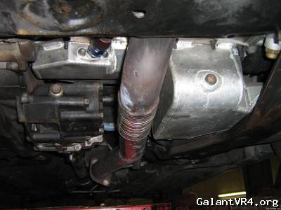

Earls oil cooler
Custom Front mount and piping

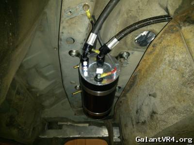

JCS Dual inlet catch can
