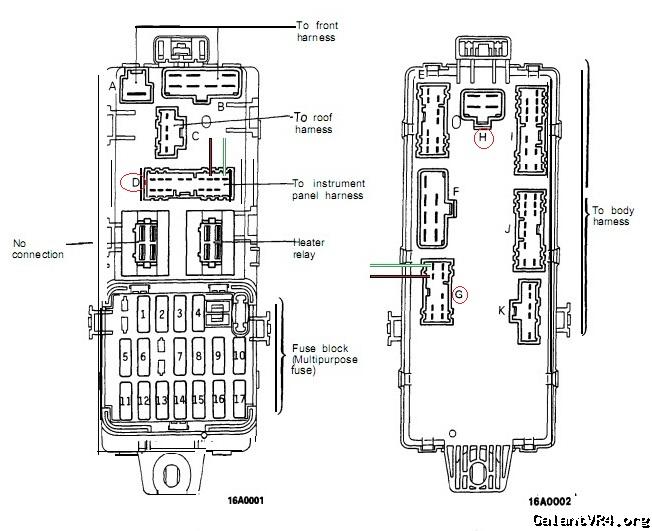

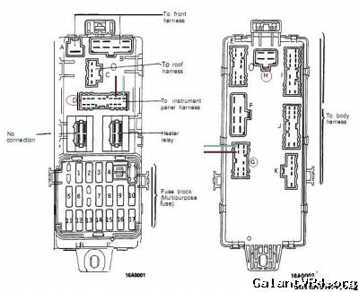

Today again i start to find the exact short circuit and exam and error with ohm meter about 2 hrz and found the short between 3 wires or better to said 2 wires cuz when you remove the clock from the dash , there is 4 wires over there ( Blue , Red/balck strip , black , green/white strip ) and in normal circuit the black wire and green/white strip relating together but Red/Black strip wire ( power source ) must not be in contact with those both wires and here is the problem i have , then i start to trace the wires to find the right connectors on both side of fuse box and the wires from clock goes to instrument panel connector on fuse box and went out from fuse box with (( G )) connector and when i remove the (( G )) Connector from the fuse box the short gone , it means everythings start before the fuse box on G connector ( like i showed in the pics ) and when i check the manual , it said the G connector goes to Body harness and i tried to check wiring from dash to trunk , still no break or anything . again start to check the connectors and insert each connector to fuse box one by one to see when the short comes to circuit , and when i insert the (( H )) connector ( has 3 thick wires , two black wires and one black/red strip ) the short comes to circuit , is this connector comes from outside at fender side ? then i check the wires inside the H connector and one those black wires connected to black/red strip ( i think maybe its not normal ) .
Totally , the wires in this short included : Green/white strip ( it used alot on everywhere that i traced ) , Green/yellow strip , Black , Red/black strip .

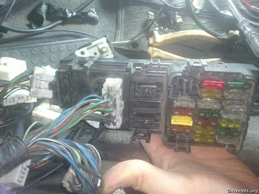

you can see the wires that i showed on instrument panel ( goes to clock , defogger switch , sunroof , dome light , .... ) and G connector ( goes to Body Harness )

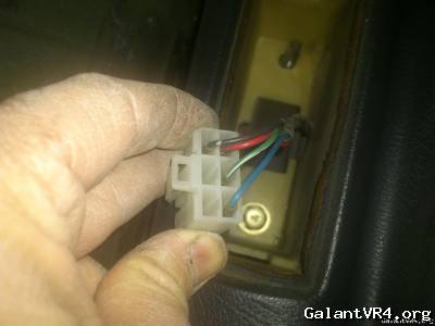

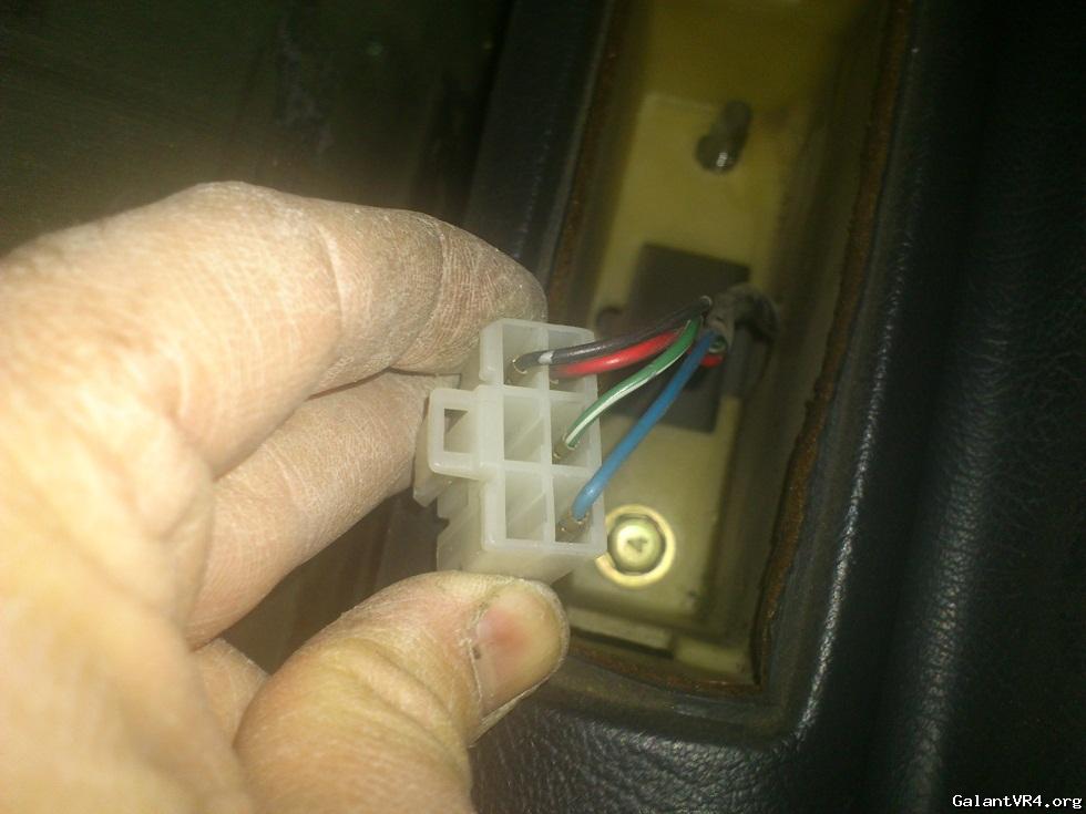

Clock wires like i explained the red wires shorted to green and black

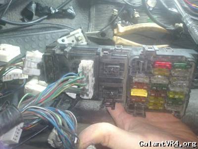

instrument panel connector on the Fuse box

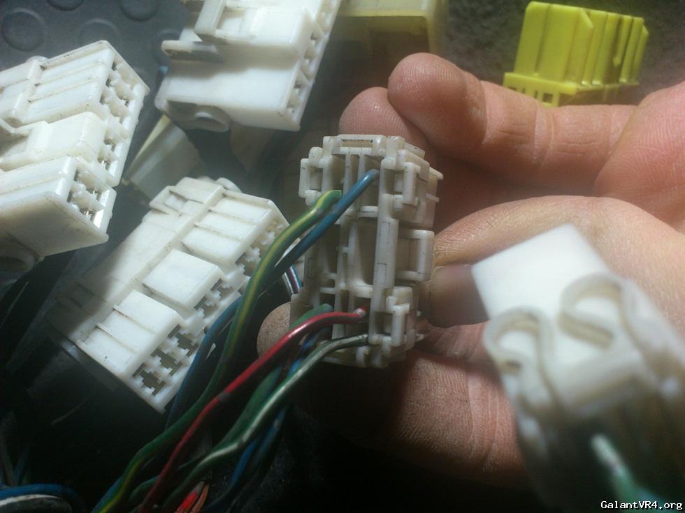

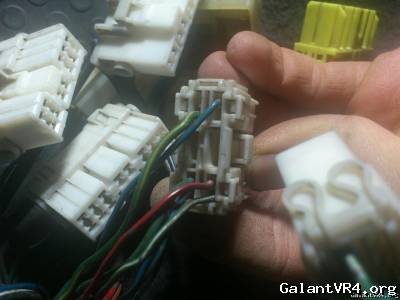

G connector ( short start from here between red/black strip and green/white strip and green/yellow strip )

You have an early car with a late fusebox. The interior ones changed at the sametime. You will have a load of issues with the wrong fusebox.
For the underdash one. there are two things you must consider. Is the car LHD or RHD and then what year is the car?
LHD and RHD are different (for the interior fuseboxes) and the years are also different. the fuse box change was late 1990 for the rhd cars
