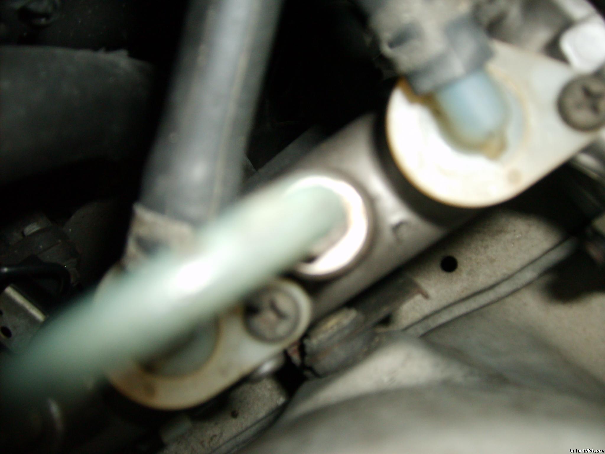

No drilling into the car for me. I'd like to see the one that uses strut mounting. The best way is to mount whatever 'brace' with the MC physically attached to the plate...
Edit: seems there is an existing studmount on side of the strut tower (bad pic, hard to see)
Picture an "L" with a gusset and one side will accept the two MC 'holes' (studs from booster) and the other hole would be fastened at this studmount location. No drilling and probably wouldn't even need to loosen the MC nuts (depending on thickness of 'L' plate). Be creative on the 'L' so that you get the most footprint and me thinks it'd work good.
Hmmm, if there is a benefit, guess it'd be another thing to add to the list. Easy enough to make, at least, and won't be any worse than what;s there now.
