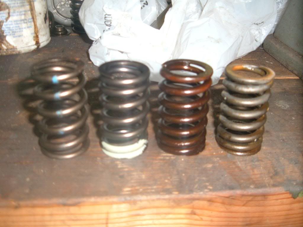

Valve spring comparison
BC1100 HKS Stock
The line up is (L to R)
BC1100 (NIB)
HKS Single appox 10k miles used
Stock 2G appox 140k miles Used
Kia Looked like a 4G mutant Head, ? miles Used

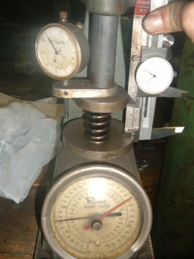

Used Stock 2g spring
55lbs @ 1.530

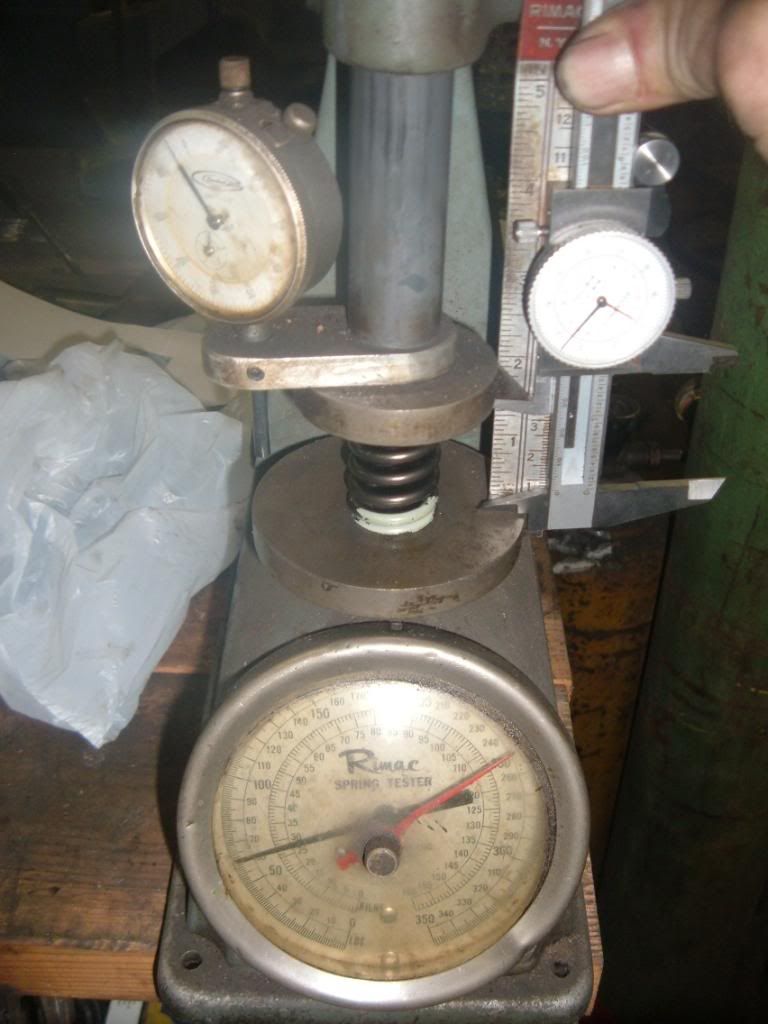

Kia used spring
58lbs @ 1.530

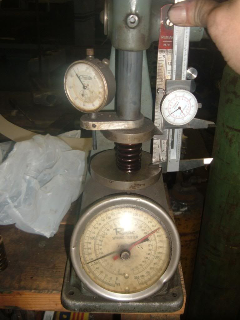

HKS
60LBS @ 1.530

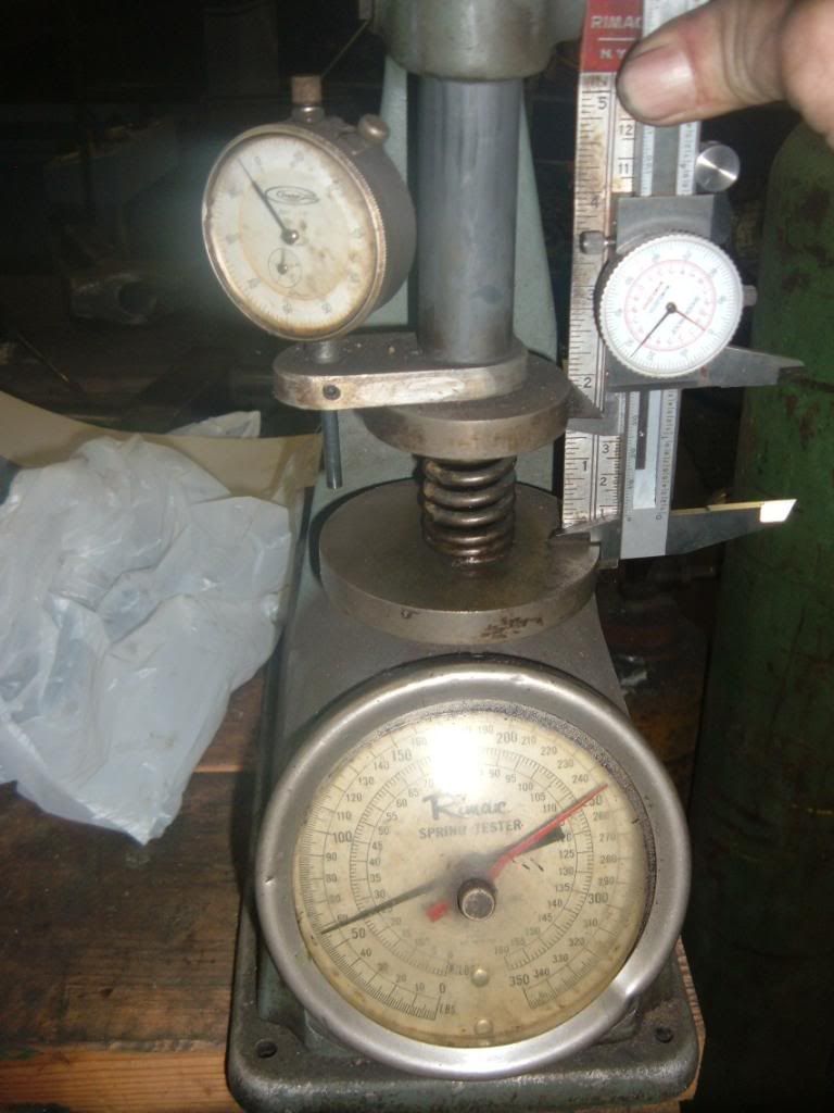

BC1100 New
74 lbs @ 1.530
I know it is a bit unfair to check a new spring against 3 used springs.
But this is what I had on hand at the time.
