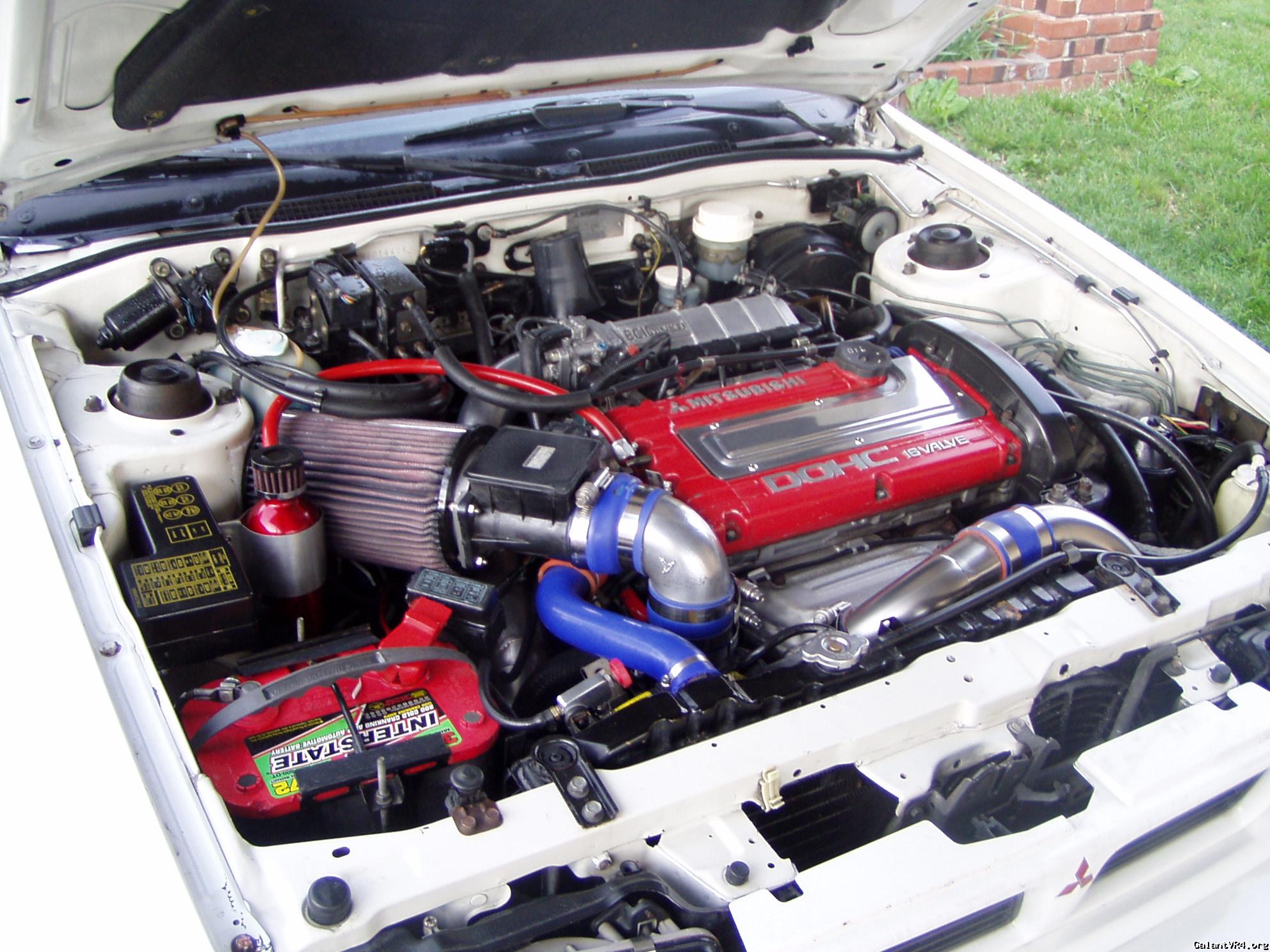

Dont bother polishing your cover if you dont have a lot of spare time and patience. I shaved the letters and polished the cover on my 1g and swore never to do it again. I started to do it on my VR4, then gave up and just painted it with high temp paint. I'll take a picture of it in a bit.

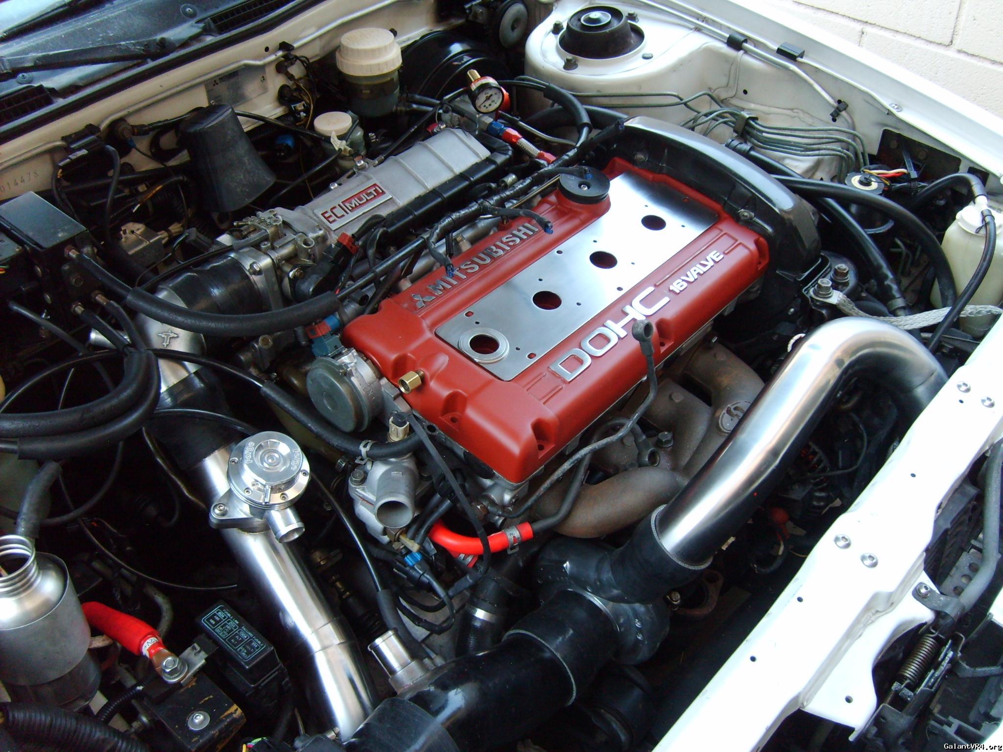

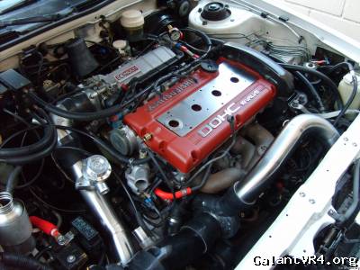

Here's a couple pics I have on this cpu, in regard to the covers I was referring to, for reference.
this is an older pic with the alum. cover (that is the orig. red color, afaik, on the VC):
this is a newer pic with the SS COP plate I made (the VC color is simply red primer, so not the final red I'll be using); making some SS washers to make up the difference of the coil boots and how thin the plate is; I don't like cutting the boot and in my mind like to have things to where I can just put another one in untouched, say I am on the road or something. I did end up pulling those orig. spacers on the coil and replaced with SS tubes instead, but they are not shown:

Thanks, I've since cleaned it up some more (was decent, but not finished enough for my tastes) and going to re-polish it again, although may give it a nice brushed look. I'm into details that people don't necessarily notice what they are, but they know something is different, so hence why I say clean it up some more. Also, there are numerous little things I did to the valve cover that most people will not notice /ubbthreads/images/graemlins/smile.gif
