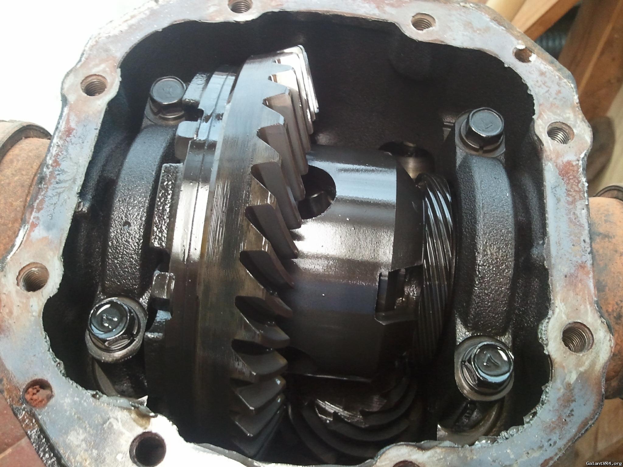

G'day, opened the diff yesterday, it is a plate diff /ubbthreads/images/graemlins/applause.gif and has the gear drive for the 4ws pump in as the car had 4WS.
Cheers
Ross

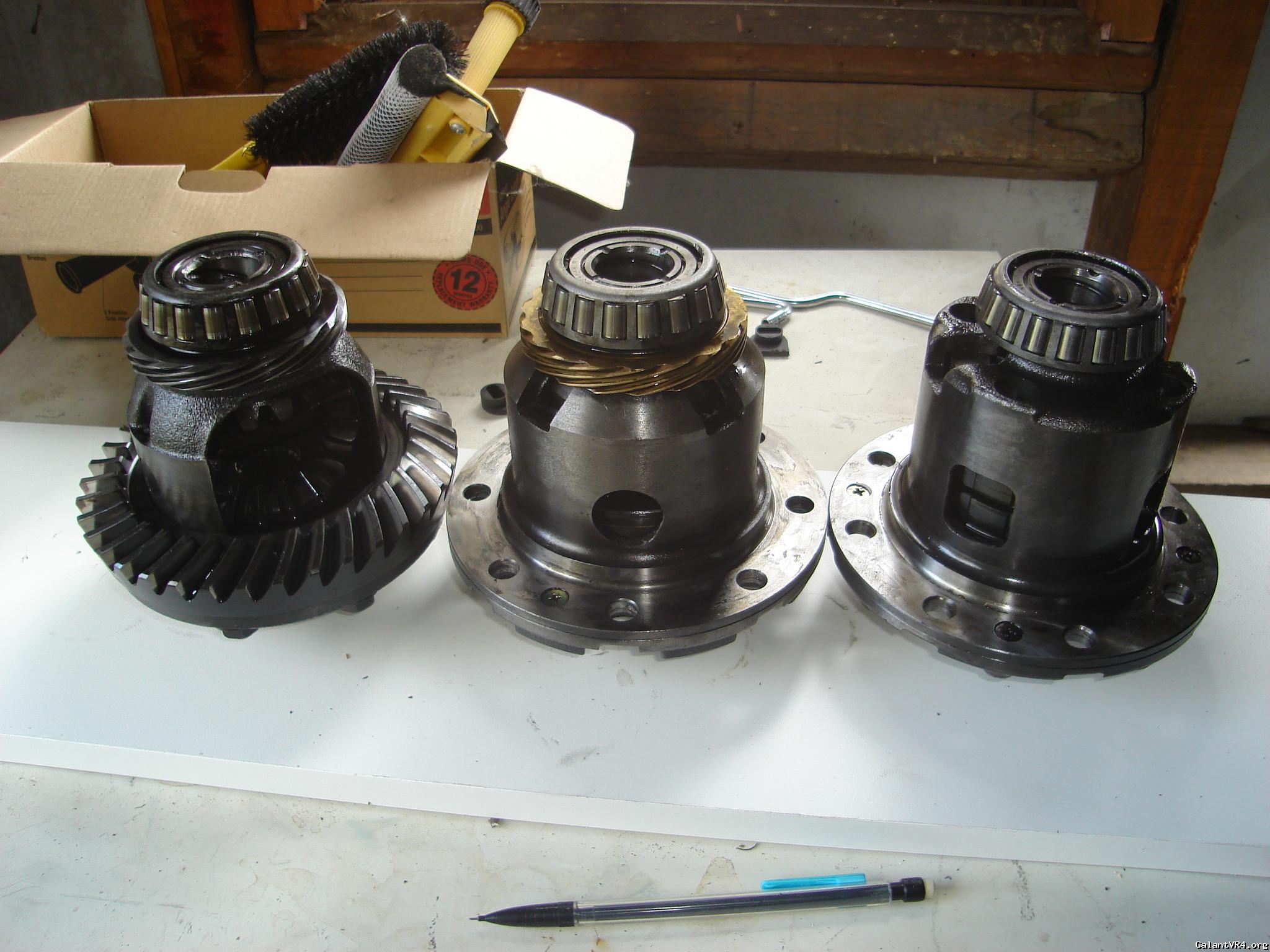

Looks like a viscous LSD diff to me...
From left to right: Open 3 bolt, 4 bolt viscous, 4 bolt mechanical/plate.

G'day, My Bad!!! /ubbthreads/images/graemlins/frown.gif...Learning every day....
So is the viscous coupling in at the ring gear end of the diff?
Cheers
Ross
fuel
Feb 23, 2009
2,166
Toronto, ON, Canada
The 'viscous coupling' between the left and right rear axles is in that center housing you see between the crown wheel and the gear to drive the 4WS pump. As you can see from the pic RedTwo provided, there is physically no room to put the 4WS pump drive gear on a plate LSD diff. Your viscous coupling must either be new or modified somehow so it locks up better.
