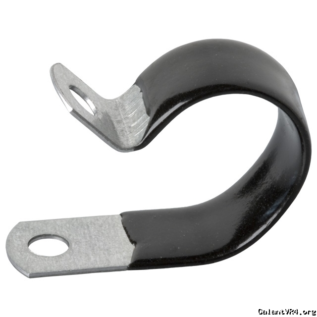

How are you guys mounting the lines on the under body? I've seen zip ties but between debris and winters, I wouldn't use them.

^ They make bolt in (screw in) Insulated clips. I forget the name. CR just picked some up, so maybe he can chime in...If he didn't break anything else already /ubbthreads/images/graemlins/tongue.gif

I used self tapping screws and "isolated clamps" from NAPA. They worked pretty well.

good ole cr up to his normal antics lol. sounds like you got yourself a polan, now just buy it and install it. someone mentioned that extremepsi has the fuel rail adaptor, its like 7 bucks. and they also sell the clamps to mount the fuel line on the underbody.
