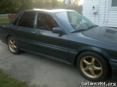

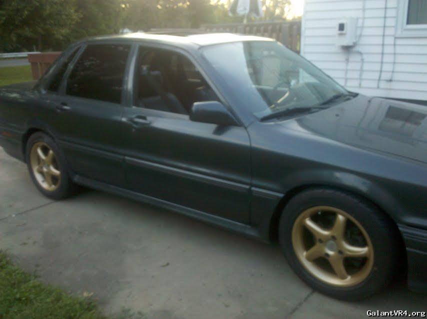

So i know there are a few people on this board who owned my car before me. And i made some posts with the condition of the car when i got it. It was non-running condition and in desperate need of many exterior updates. Keep in mind this is a true DAILY DRIVER i am a salesman at a ford dealer and i drive this to work EVERYDAY with no hiccups. Hopefully hitting the dyno soon and the track. My goal is 450AWHP and low 11's. and with this turbo it shouldn't be a problem.
Here is how it looks now. : ) and yes this was the bright blue one previously. /ubbthreads/images/graemlins/hsugh.gif
