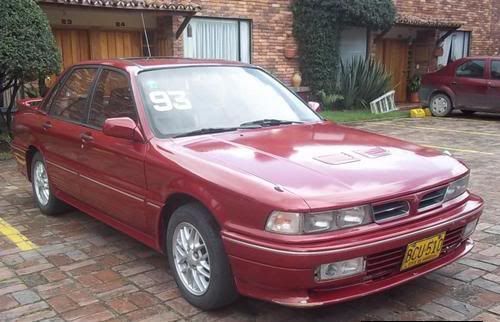

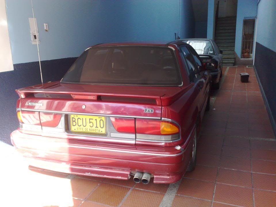

A friend of mine recently bought a 1993 Mitsubishi Galant ZX E33A, it is a South American Spec, a mix of AMG parts and regular ones, might look weird to some of you, I'm posting some pictures for you to look it.
