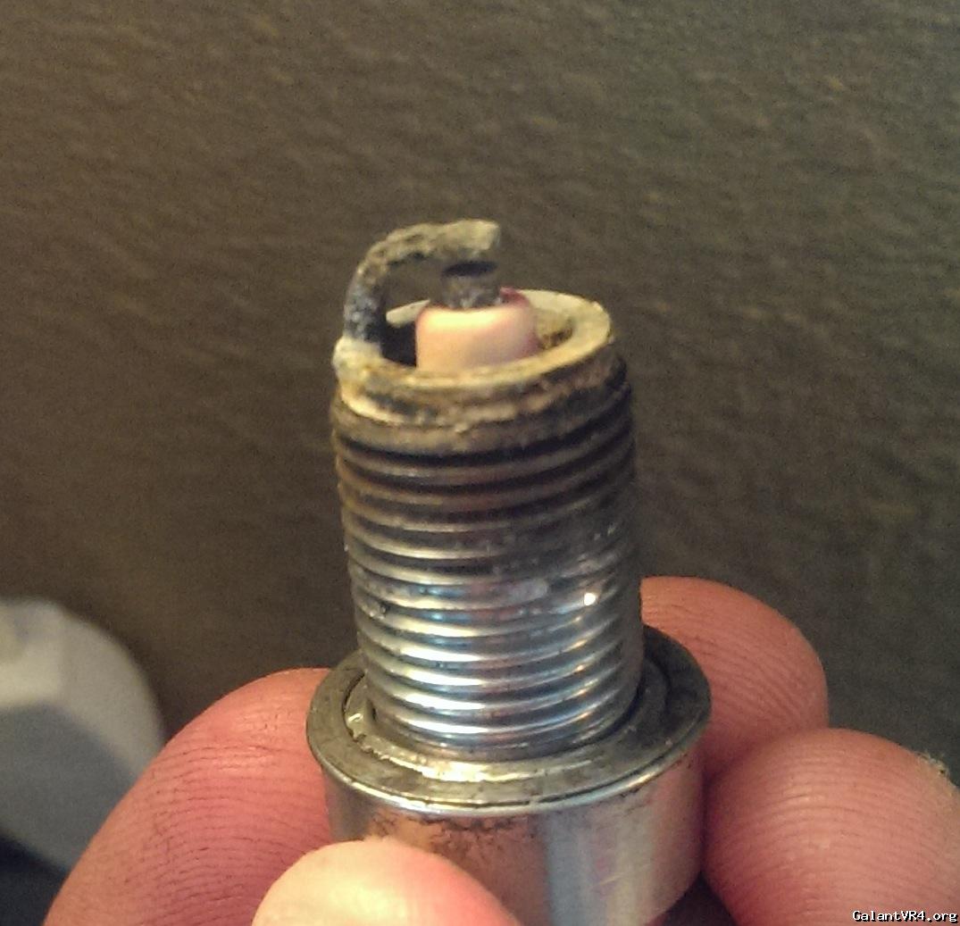

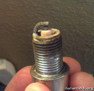

Pull your plugs and check them. Take pics and post them. And don't wait. here's what one of my plugs came out looking like. Bad injector = new motor in my case. Very similar sounding issue. Car was running great, sounding great, unless I tried to put more than 10psi through it. Then it would just sort of breakup.
