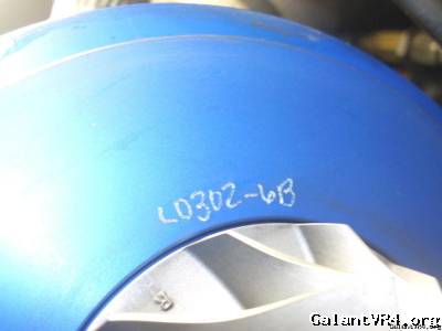

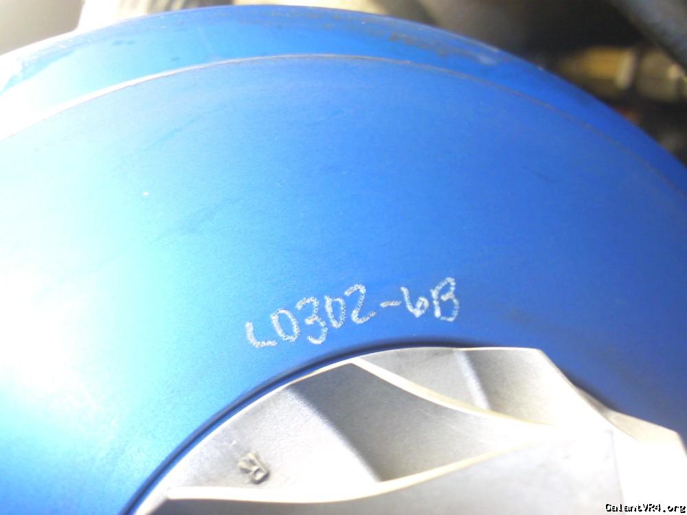

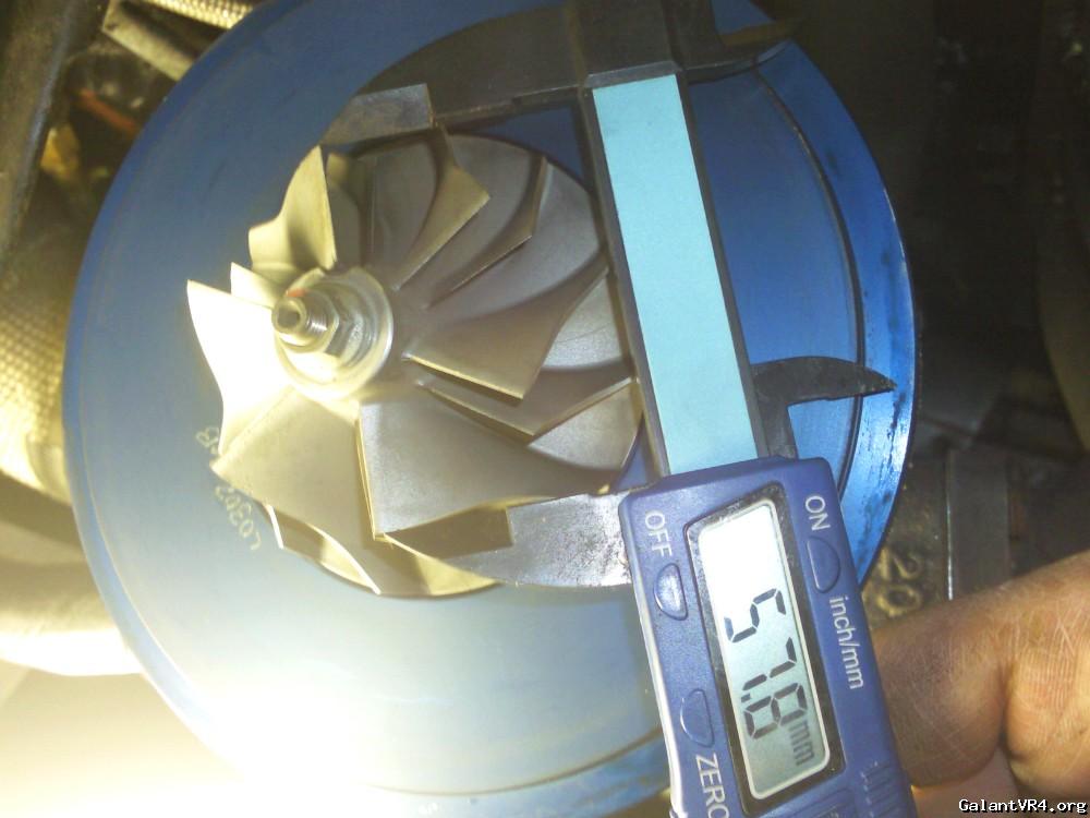

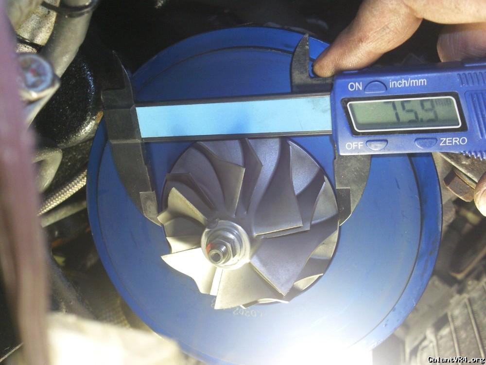

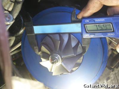

I finally got the time to pull off the compressor housing on my Turbonetics turbo. What I got so far from doing a little research, I would guess it's a TO4E 60 trim.

The turbo is roughly a mid sized GT30 by the measurement of the wheel. The 76mm exducer size is standard for most(If not all, I'll have to check) GT30 frame turbo's. That being said, your injectors are only good up to about 375 Flywheel HP at 85% IDC at base pressure, translating to maybe 275-300 on the ground, at probably somewhere between 10-12 PSI.

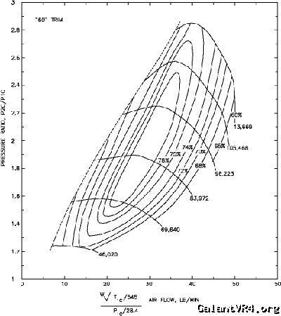

I was looking into getting bigger injectors, but I've been hearing problems people are having to get the car to idle right. So that was the only thing deterring me into going any bigger. But at this point...If that is the only route to go to get the potential out of this turbo, I guess I will have to make that leap. Also, This is the compressor map I dug up from Turbonetics site.
I was doing some reading online on understanding the map, but It's still a little confusing. Care to explain? From what I understand, the big island in the middle is the turbos efficiency range. So is it safe to say that the turbo's efficiency range is between 22-37psi? Feel free to correct me if I am wrong. Thanks...

Roughly, yes. The best way to view a compressor map is like the sweet spot on a baseball bat. But compressor maps really just compare one turbo to the next and give a general idea of what it is capable of. Running a turbo outside it's efficiency limit is pretty much something we have been doing from the beginning.
/brox

That compressor wheel looks like it measures out almost exactly like my gt3076r. My compressor is 59.83mm on the inducer, and 76mm exducer. Mine, however... has seven blades, not six.
