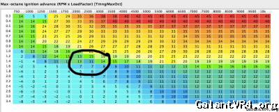

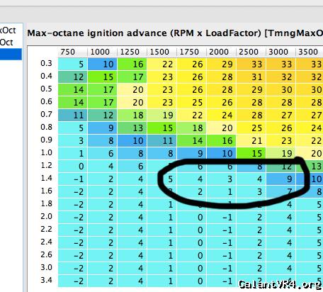

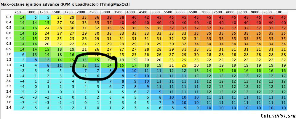

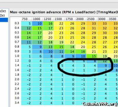

Tuning WOT timing and I noticed something interesting elsewhere in the map...
EfiniX
Oct 18, 2012
647
portland, or
There's this one part of the timing map where the timing dips a few degrees before scaling up again. It's at 2500rpm's at a 1.4 load factor. The minor drop is on both the stock 2g timing map, as well as the timing map that the guys at English Racing setup on my car. Anyone know what is going on at this particular point in acceleration that would be cause for the timing retard?
stock 2g
my map
prove_it
Jul 3, 2008
4,201
Sioux Falls, SD
I need your datalog. I wanna see how the tracking box moves through the map. You might not even be using those cells at all.
Or
Could be there for spool up. No way to know for sure without a corresponding datalog.
EfiniX
Oct 18, 2012
647
portland, or
That was my first thought as well.... Of course if that is the reason, it goes out the window with a bigger turbo...
prove_it
Jul 3, 2008
4,201
Sioux Falls, SD
Yea, it is kinda low in the RPMs so could just be unused cells. I'm pretty anal on my maps, so I edit those odd parts to look nice even if the car never uses them.
EfiniX
Oct 18, 2012
647
portland, or
hmm. An anal timing map doesn't seem like it would be the best. You might leave skid marks on the pavement, but more than likely, it would just blow up in your face.
