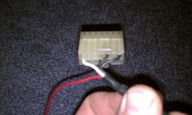

I guess I should start with logging data. Here's what my plug looks like:
Is that all the wires I need? Should the red one be connected to something?

Ok, so first things first you need to get the palm connected to give the group some good data so I will talk about that first.
You need to download "Palm Desktop" I think that can be found on Palm's website. Then you need to download the logger that you want to use. Tunnersteign (not sure on spelling) is what I always used to use but there is another one that I use now but not around my palm to find the name but I think it is PocketLogger. The new one also has an excel connector so you can view everything and graph it in excel. (the excel download is a separate one and is not needed)
Get into Palm desktop and it will have a way to install programs, then sync your palm and you have logging.
