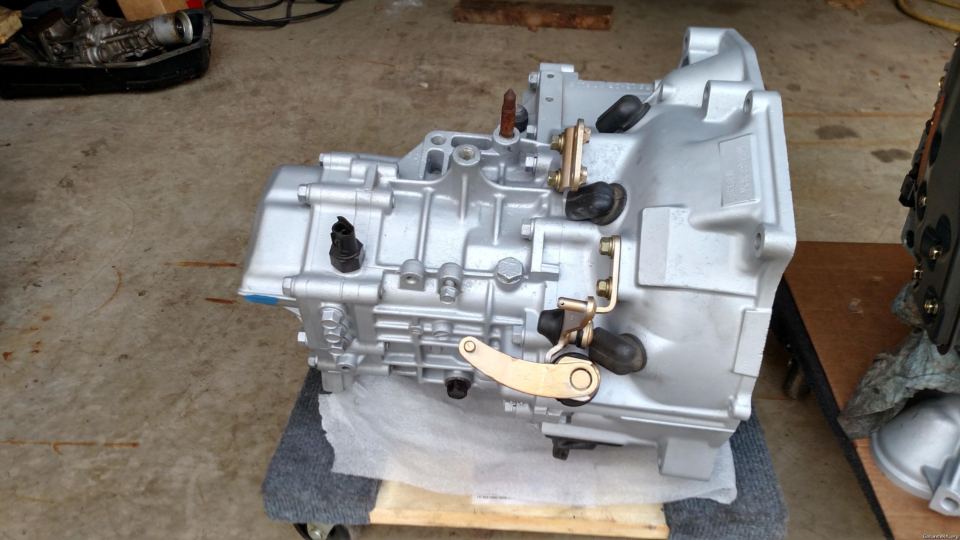

This is what I used a few months back. Think it was around $5 at Walmart.
Straight from the junkyard
After some elbow grease
One can was plenty
New yellow zinc case bolts really pop against the silver and brings it back to looking new again.
New reverse sensor from Rockauto and all the other bits hit lightly with gold.

That looks amazing. Prob the best painted and looking used transmission I've ever seen. Good work. I will do the same if I ever remove mine.

Good God Man that is impressive!
All from a $5 can from CrapMart???
Adding another to-do on my Winter list for the used transmission in the garage that will go in the Galant :p
Thank you and Well-done!

Thanks guys! The bolts were around $45 I think. Probably barely notice them once its back in the car but I'll know they're there. Reminds me of my youth detailing models. /ubbthreads/images/graemlins/grin.gif

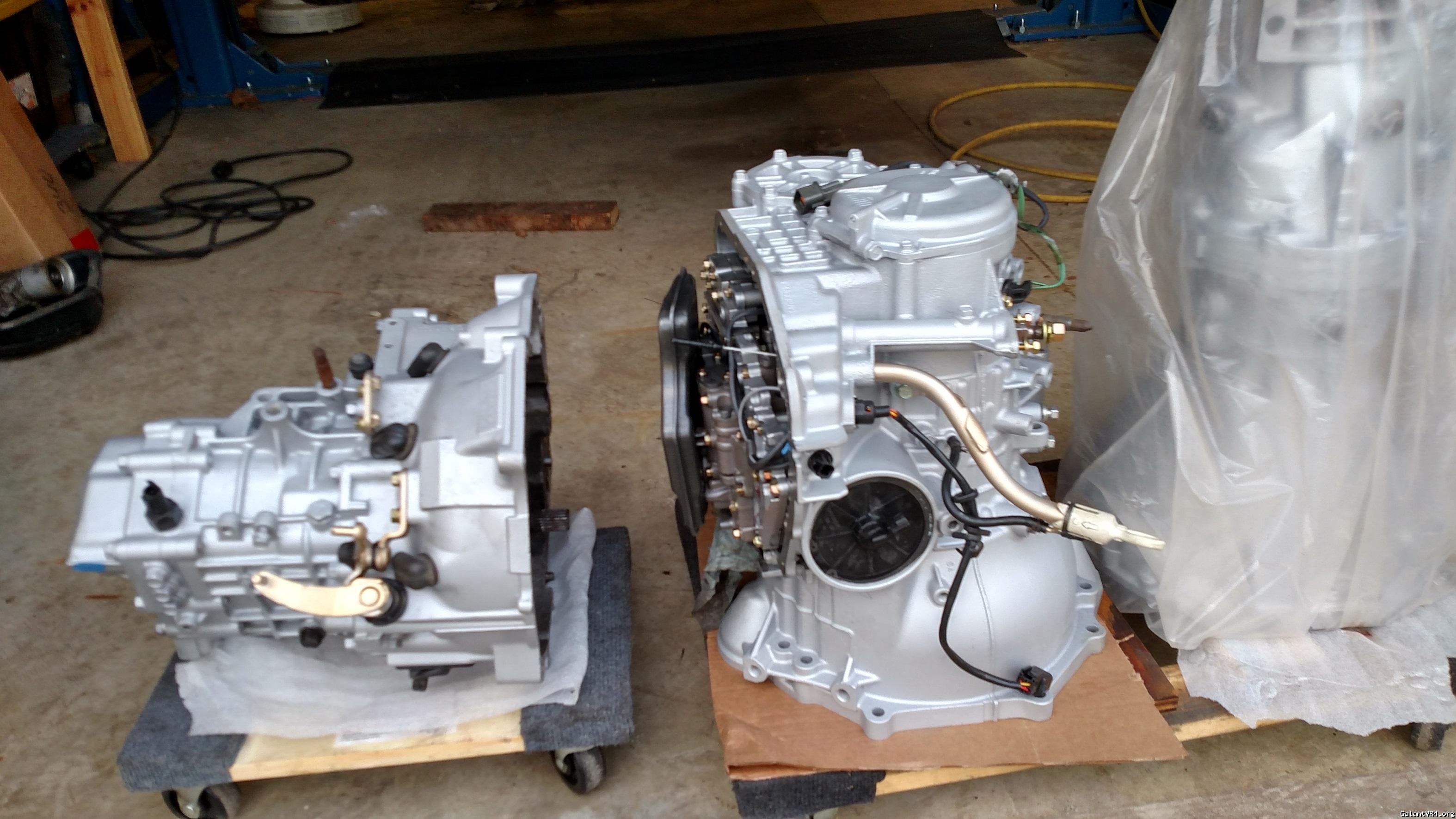

Well a few weeks ago I spent the time scrubbing, cleaning and painting my trans. Then continued on a did a couple more.
Used some of the VHT and the Rustoleum too. Will see how they hold up.
