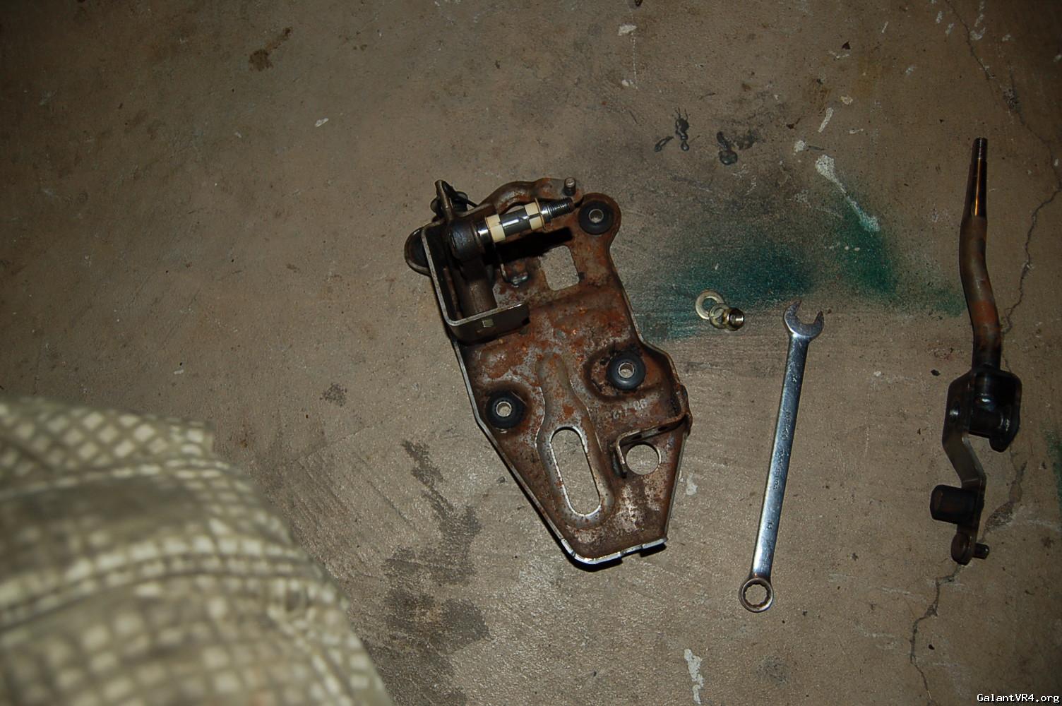

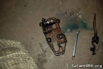

Ok so here is a picture of the plastic peices im looking for. these are the last things i think i need to finish up my car. can anyone please tell me what they are called or even better yet there part numbers so i can get them.

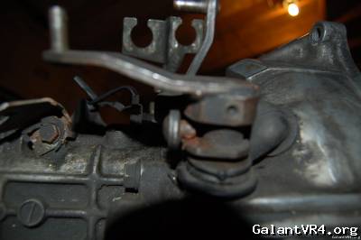

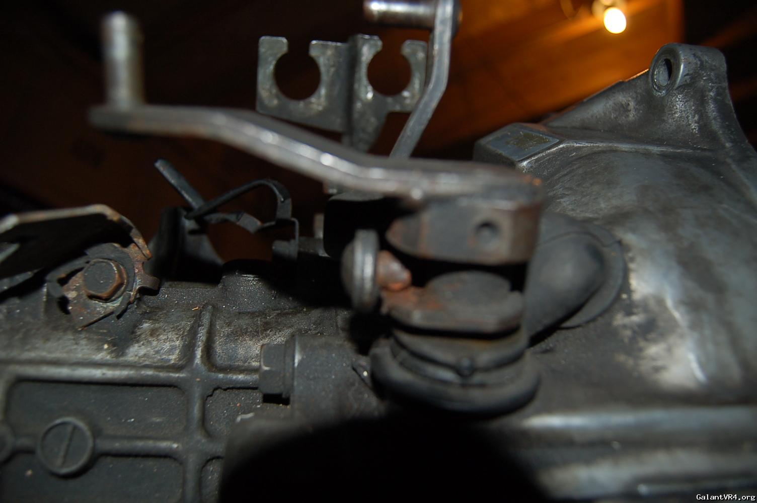

this is the transmission plastic peice im in need of.
part number MD712919

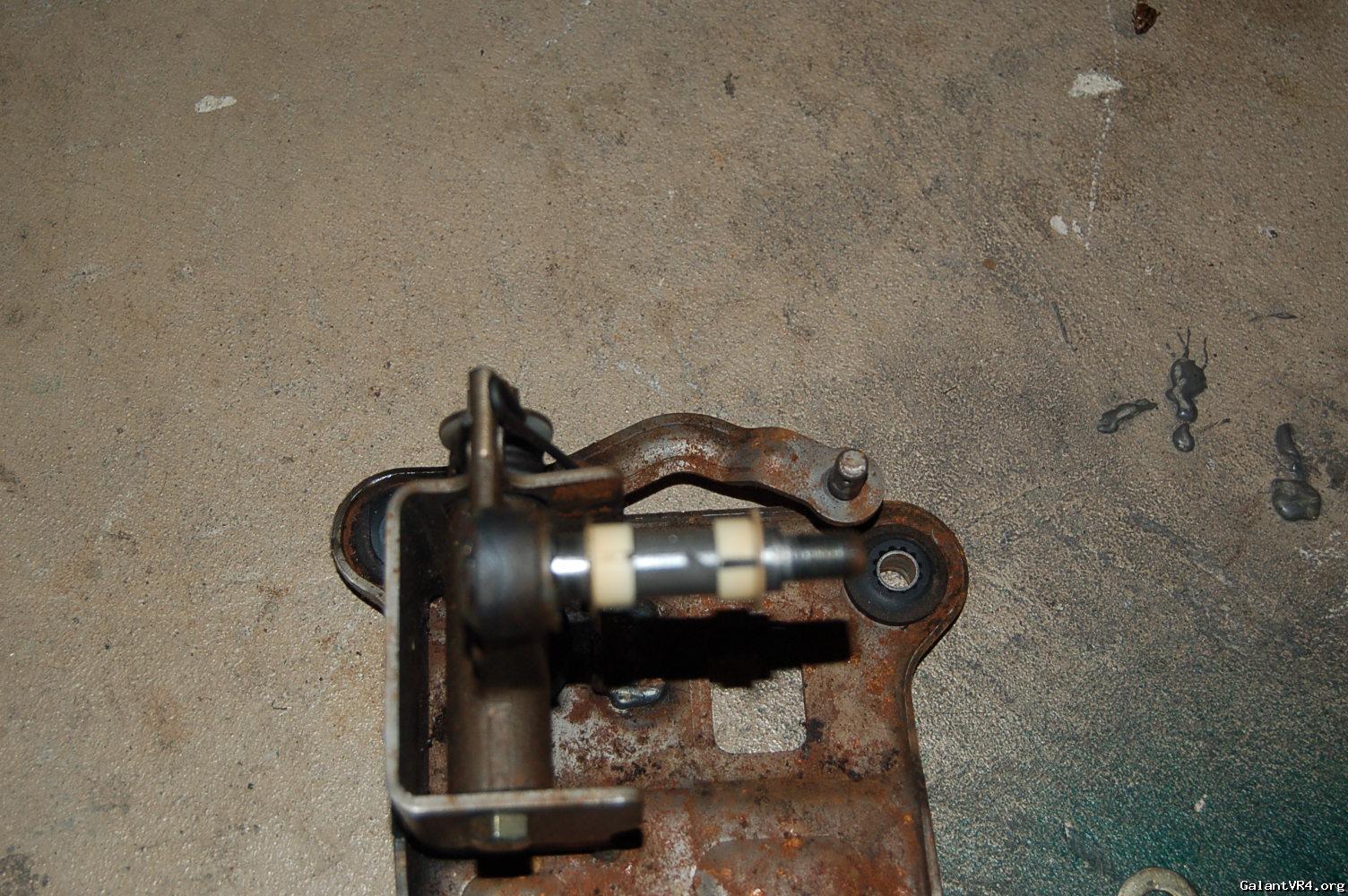

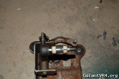

this is the shifter plastic piece im in need of.
part number MB580253
i also found out that you can take your whole shifter apart and take a 2 liter bottle of soda cut thin strips of it and wrap them around till it tightens up the shifter to your liking. make sure to grease all moving parts good. im thinking about doing this mod today and may do a write up on it.
dmj
Feb 2, 2008
673
orlando FL
JNZ has what you need . order the shifter rebuild kit. The piece for the trans shifter you can get in the junkyard from any 89 and later manual trans dsm.
transparentdsm
Jul 27, 2011
3,690
Cherry Hill, NJ
i want them both to be brand new, i have an old one i took it out because it felt all washy and i would rather pay the money and have all brand new. if someone has the part numbers, i own a shop and get good deals from dealers and the local autoparts store.
ok found the part number i think. MD712919 its called the plastic shift pad apparently. and MB580253 gear shift bushing
