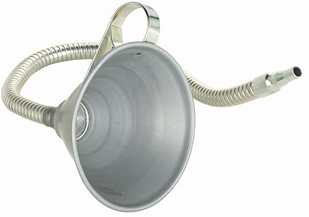

Pro tip for filling the trans: remove the speedo gear and get one of those long transmission fluid funnels. Stick the long transmission funnel (or a typical funnel with a hose attached) into the speedo hole, and then dump in exactly 2 1/2 quarts of MT-90 (spec is 2.4 qts). It will save you the hassle of pumping it in.
You still have to pump it in the rear diff and xfer case, but they have small capacities compared to the trans.

sweet deal on the speed sensor, I have that funnel I use to fill my Honda's the same way.
