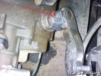

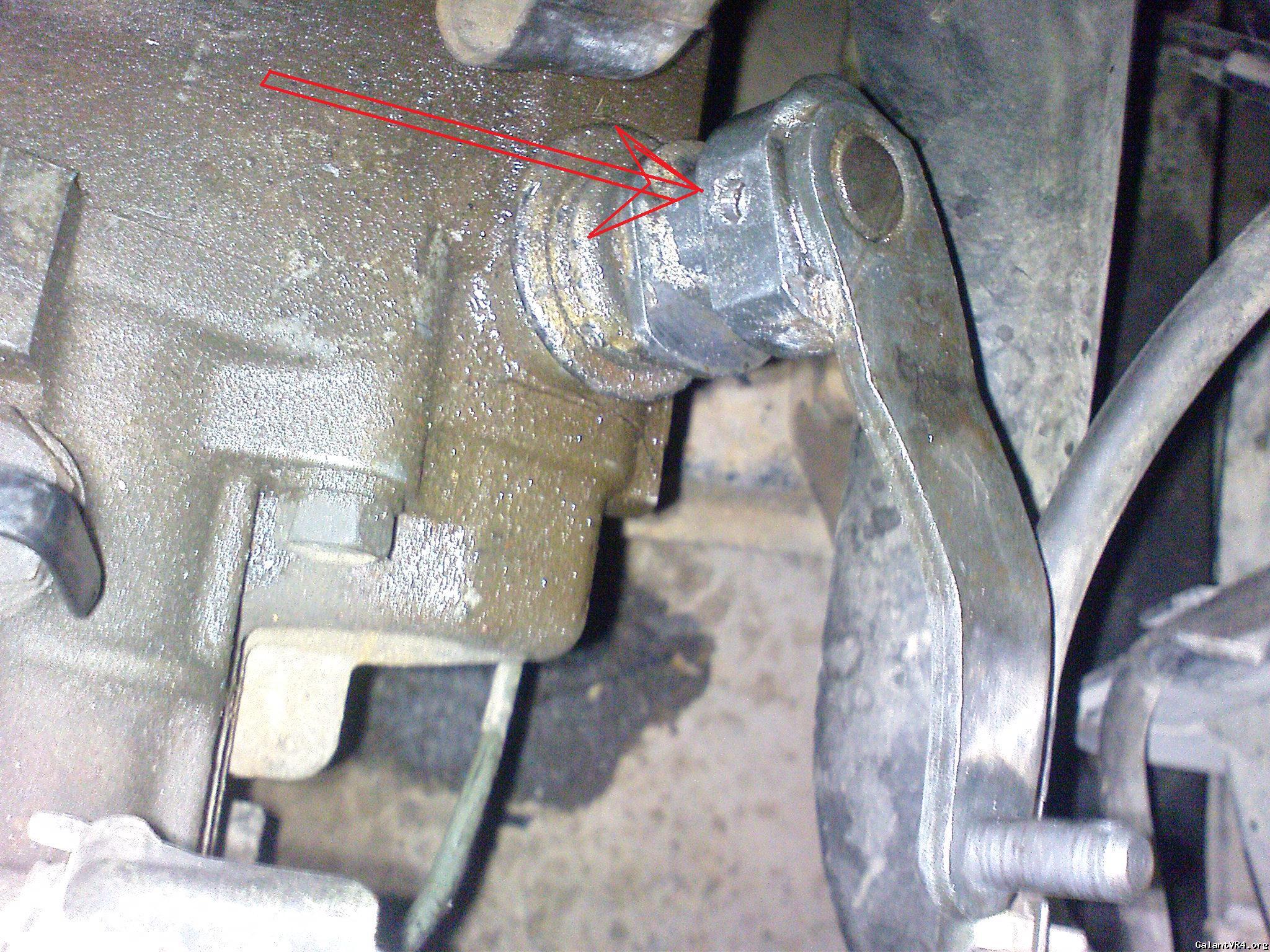

Any one could get out the pin of the lever? Any idea please.
I keep hitting the pin but it did not move.

Air chisel and a lot of luck.
Be very careful removing it as the shaft can be bent if you use too much force.

I dont have Air chisel' If you mean cut the lever it self. Then may be I can use dremel!

I will change it. this lever little longer than the GVR4 one. Which causing shifting issue.

Yeah good luck with that. It's a tapered pin. I tried one time so I could change the seal. No go. Later I decideded to see how bad it was and cut the shaft off a junk bellhousing. 20ton press wouldn't get it.

Quoting Nabeel:
If you just need to shorten the throw of the arm, just drill a hole in the distance off pivot that you want, and you can use a bolt and a nut to create a second post. Center drill the bolt the right depth then you can use a cotter pin to secure the linkage.
