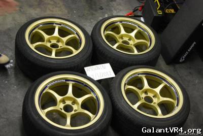

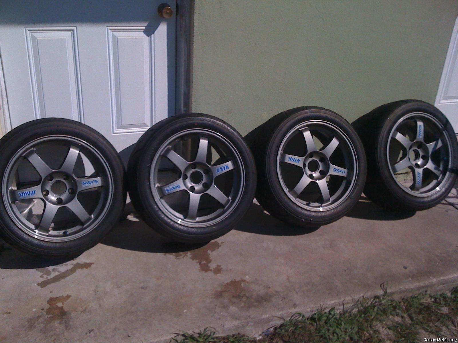

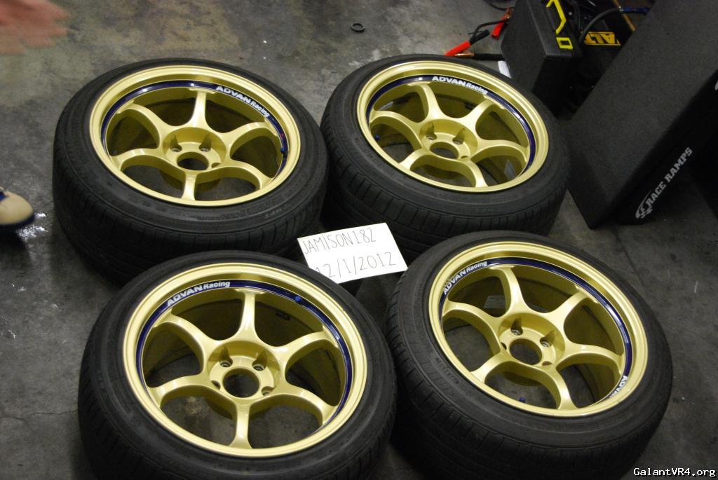

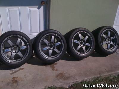

i want to trade my volks for this ones
volks 17 x 9 et35
advans 17 x 9.5 et 14
What u guys think??????

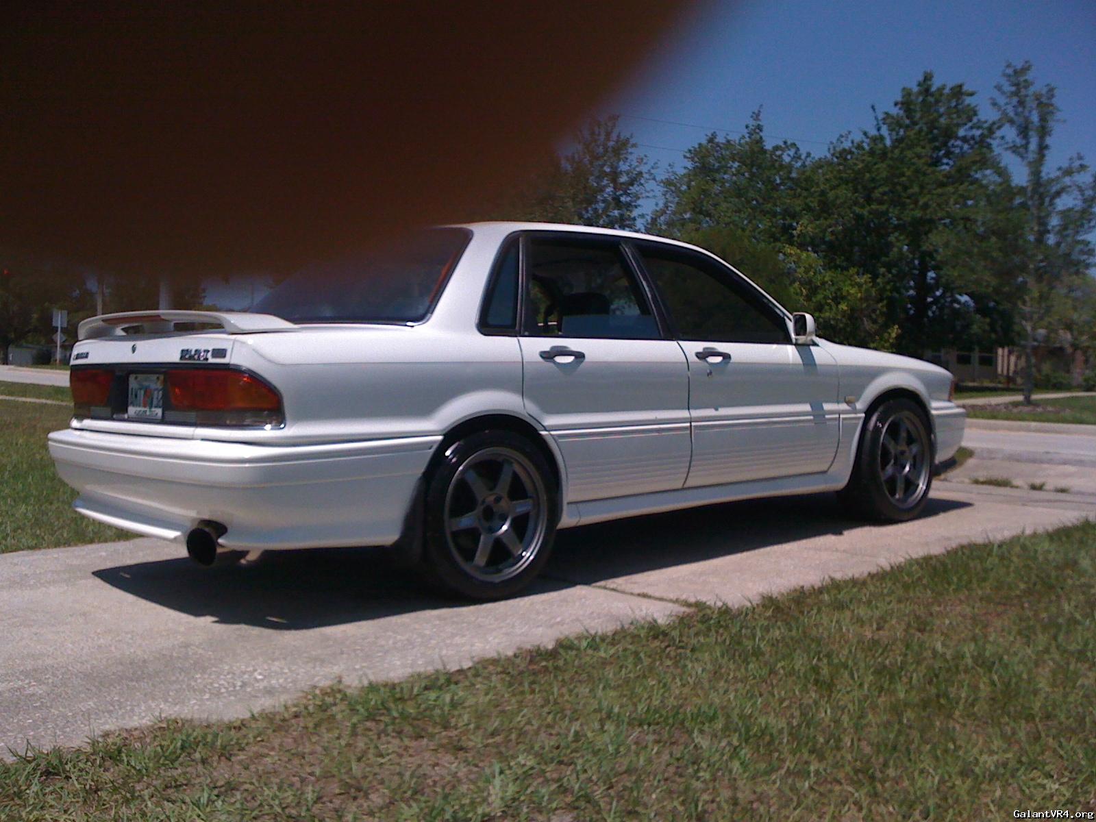

I love TE37's, but you green GVR4 would sick on the Advans (if they fit)
Here is a pic of his car for those that can't search

I love TE's but those Advan's would look sick on your car.
blacksheep
May 1, 2002
15,485
Urbandale, Iowa 50323
Yikes, is the offset really +14 on the Advans - I don't think the gvr4 is cut out (no pun intended) for that sort of offset. That's aggressive even on an Evo X, more for 370z and such...

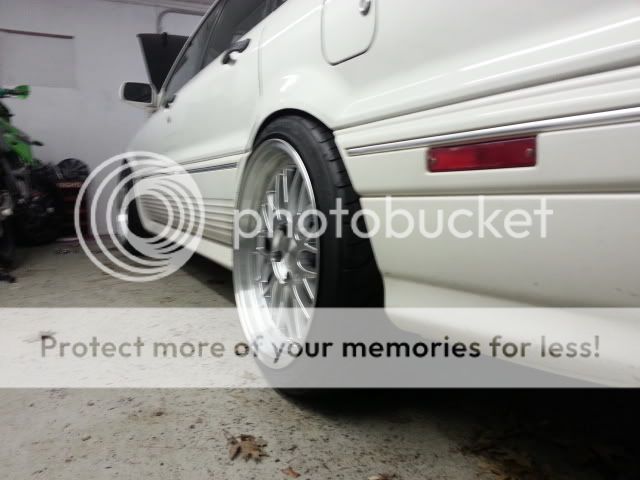

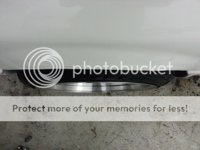

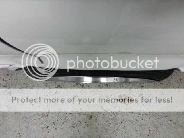

I posted in the other thread FCR started, but here's just in case anyone missed it.
Test fit off a buddies car while I was putting a clutch in it. 18x9.5 22mm offset. Still retaining the 8mm spacer in the rear of my car. 225/40R18 tire. You will be further out by about 5/16". Camber on my setup is about -1.5*F -2.5*R.
EMX5636
Jun 28, 2008
1,631
Bucks County, PA
Quoting SleepinGVR4:
Like the wheels. Hate the stretched tires.
Hater. /ubbthreads/images/graemlins/wink.gif P.S.- Knock of Varrstoen's. You probably thought they were CCW's like the other set I tried on!
I don't mind a little stretch, I think a 235 would be slightly better, but then the car would need to come up to clear. SORRY to FCR as well! I forgot to mention that I have all 4 fenders rolled/pulled about 3/4". So stock body Galant would be an extra 1/2-3/4" less coverage.

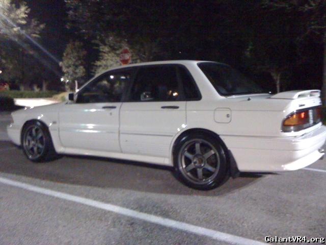

Actually the only thing that stop me right now is the thing about the offset so i don't know if i'm gonna do it or not

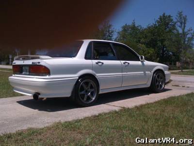

This is my car now with the volks
