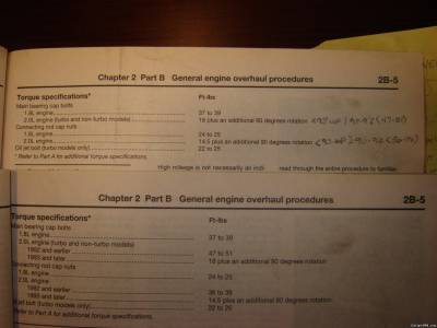

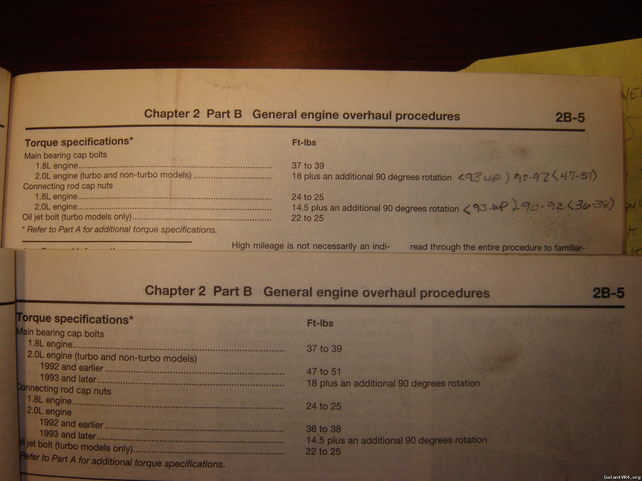

Ok...So do you think I can sue haynes manual's for faulty information??
This is what I found:
As you can see, these are both haynes manuals, both have the same part# on the manual, with no difference in the print date.
The one shows torque specs, the other shows them for 92 and earlier, and 93 and later.
Why the hell would they do this??
Anyway, I checked all my bolts and they are still with in spec, so I did not stretch them luckily.
Everything is back to the norm now, I think. /ubbthreads/images/graemlins/banghead.gif

Ok, a 6-bolt does not have the 1/4 turn torque at the end on either the head or main bolts. You just torque them to factory specs. The part about checking the bolts for stretch does not apply to a 6 bolt either.
The Haynes manual (or whoever you are referencing) lists 92 and earlier (6 bolt) and 93 and later (7 bolt) for specifically that reason. The 7 bolt engines use the torque to stretch (I prefer that over calling them torque-to-yield) that require the additional 90* turn on the mains, and two 90* turns on the head bolts.
Torquing sequence on a 6-bolt main is not so critical. I would work each group (of 4 bolts for each joint cap, 2 bolts for the center and ends) at the same time, and work from the center out. I would have to check my factory engine manual to see if it says anything, as I can't remember.

As for the manual, I posted a pic above that was the lead contributer to my confusion, that and the cleaner fumes and lack of sleep. the 2 manuals are the exact same ones, but one has the correct info for the 6 bolt, and the other only has it listed for the 7 bolt.. Go figure.

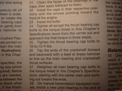

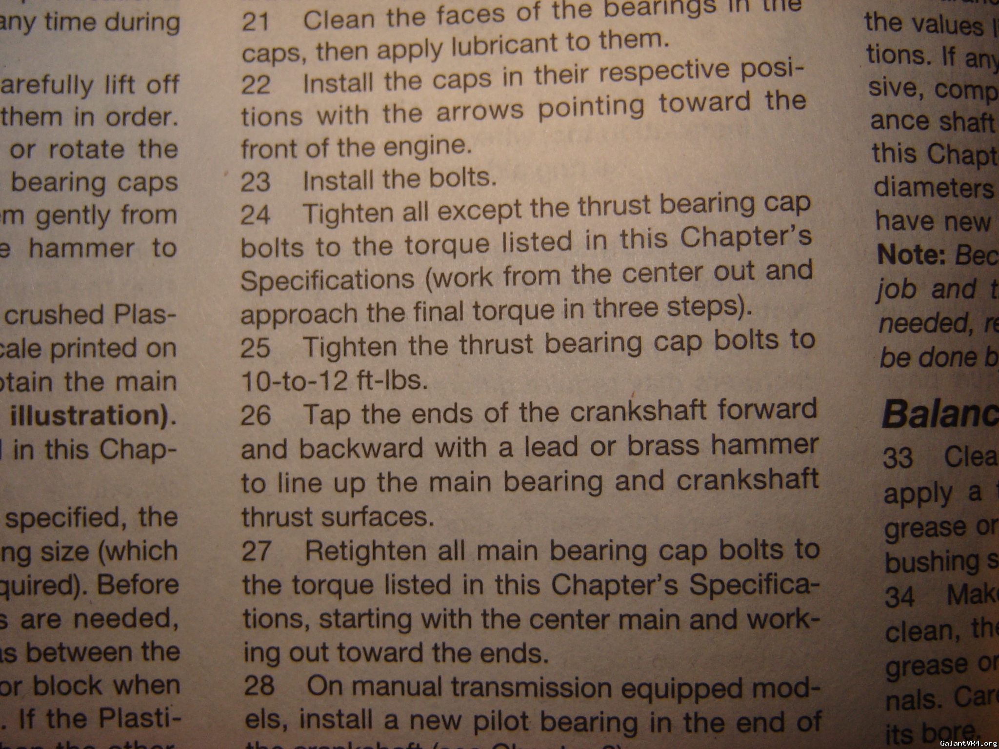

As for the pattern, again, I was just confusing my self in the discription, It does say to work from the center out, as mentioned in the second pic that I posted up.
