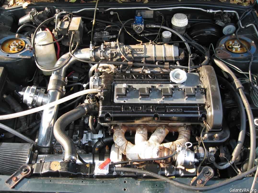

Engine
Hyundai Sonata G4CS 2.4L 6 bolt
Eagle Rods
9:1 Wiseco Pistons
Bored .020 Over
Fully balanced And Blue Printed Crank
No Balance Shafts
ARP Hardware
Custom Oil cooler
Buschur damper
Full Race ported Head, Nitrate Coated 1mm over Valves
Comp 200's Cams
AEM Adjustable Cam Gears
Cometic Metal Head Gasket
Turbo/Exhaust
Full AGP T3/T4 Kit
GT35R non bb
SFP Manifold
Tial 38mm Wastegate
Buschur 3in stainless Downpipe
Tial BOV
Custom Garrett Core 24 x 12 x 3.5 custom end tanks and short route 2.5in IC Aluminum Piping
