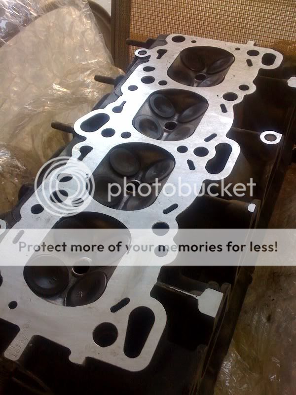

Goodies that rmontalvo23 collected while its been parked.
ARP's
.20 over pistons and reconditioned rods
complete
ACT flywheel and clutch kit.
box of random goods that need to be cleaned
reconditioned crank
.20 over block.

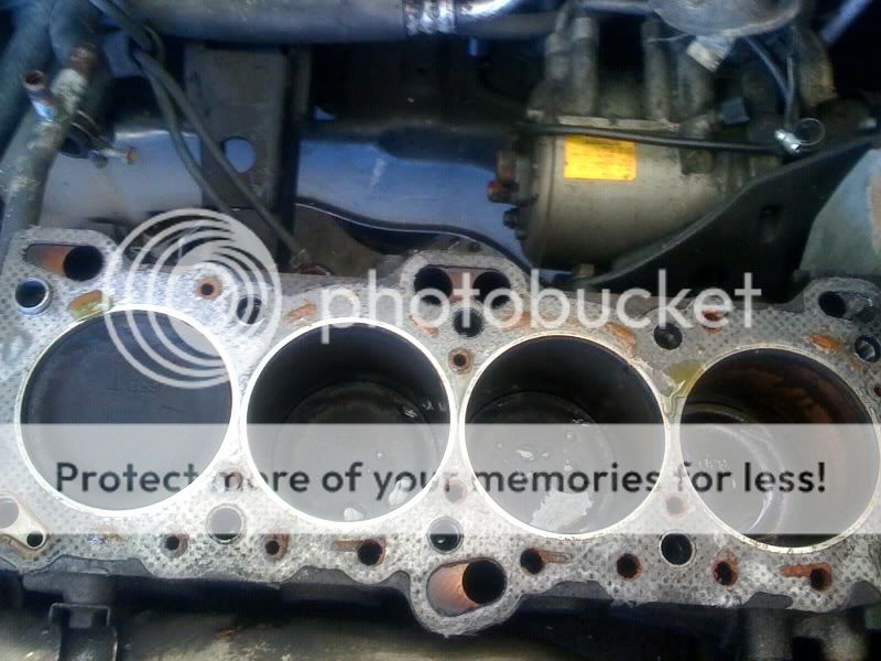

Update: got the transmission and head off the car, sucks not having a engine lifter lol. I got the block and crank cleaned at the machine shop and just got it back. Starting to assemble everything to put together /ubbthreads/images/graemlins/smile.gif California weather is making me take a while to get everything done, so f#@king hot, even worse in the garage.
Found that cylinder 1 blew a rod and punched a hole in the back of the block.
The hole I found behind the ac compressor.
