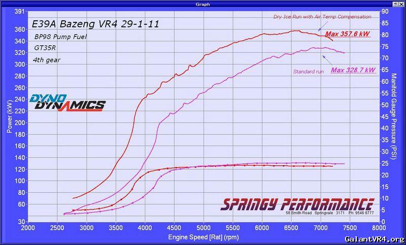

It ran a 10.9 @ 135mph with the dog box. 1.98 60 ft (no launch).
The run after i launched and broke the drive shaft at the uni joint.
That was the old setup.
360kw at the wheels. 482hp at the wheels.
New setup makes significantly more power.
425kw at the wheels. 569hp at the wheels. 24psi boost.
I have further plans for nos and more boost. 30+ psi boost.
Also now run a DSS drive shaft and DSS axles. Only missing a transfer case.

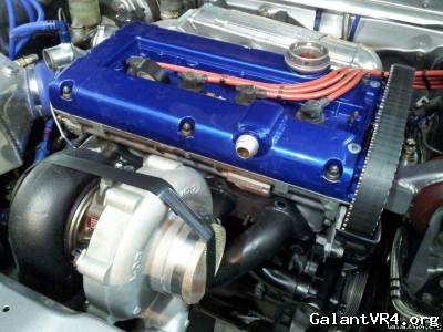

This is what i currently have:

You trapped 135mph with 482whp? How in the hell? How much does the car weigh?
And it trapped 135 with no launch! Id bet with a WOT/Full boost launch it picks up 3-4mph by not having to spool the turbo through first gear and putting down full power for another 100ft of track.
go look what kind of dyno...there is the answer to 135 with "only482". Bet on a USA dynojet that's a 595-635whp car to trap 135 without a leave.

11,982
Does a DynoDynamics really rate WHP that much lower than a Dynojet? I thought that was a Mustang dyno thing?
This is why I like to use trap speed and weight to measure performance.
bazeng
Feb 6, 2003
2,520
Melbourne, Australia
Hi Mark,
I an honestly say that the dyno it gets tuned on is known to be the heart breaker dyno.
Although it is rather consistent across all dyno dynamics dynos.
