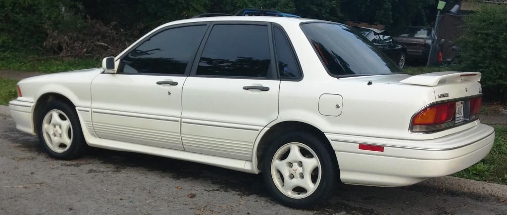

Anybody have suggestions as to what tires I could run on my stock rims? I want something fairly aggressive with a lower sidewall than stock. Harder and harder to find sporty small diameter tires these days as everybody is moving to 17" and bigger. I was looking at 205/50/15 but wondered if there were better options and I don't really want to spend hours checking different sizes on tire rack haha. Thanks guys.

My stock 15" have 205/55/15 and looked pretty good. I just did the five lug swap to run 17" and slicks for the track later on! /ubbthreads/images/graemlins/smile.gif
10,992
205/50/15 are too short. They look dinky in the wheel wells. I bought 115/1000 with that size on, and went back to stock size. The 205/55/1 mentioned would be better. Slightly lower profile, but greater width than stock.

I used to run 205/55 and it looked slightly more aggressive, but if the groves on the HWY are bad, I thought they tracked a little funny. Last time I went with the stock size Yokohama YK580 (discount tire only model) and the side walls look very clean to other stock size tires I've seen. They don't look thick and bulky at all.

I liked the 205/55 but they were way more spendy than 205/60. I really didn't notice a different and if I had stock rims, I would go with the 205/60r15. Just because it's a more common size and a little cheaper.
It really depends on what your expecting the tires to do. Do you just need replacements or are you looking for performance.
Also 205/50 is short. It works and will perform great, but yea, it will look funny. Kinda like the cars with small rims and tires with hydraulics.

Thanks for the suggestions, guess I'll be looking at 205/60's. I'm not going to be doing anything extreme on the tires, I only drive the car about once a week when it's nice out and I don't have any plans to track the car or anything like that.

So I looked and looked at TireRack. Couldn't find anything I liked in the sizes suggested. Ended up ordering a set of General G-Max's. Only size I could use was 195/55. I'm dropping the car a bit using H&R's so hopefully they will fill out the wheel well enough. Thanks for all the suggestions and I'll post some pics up when I get them installed.
