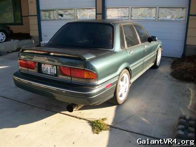

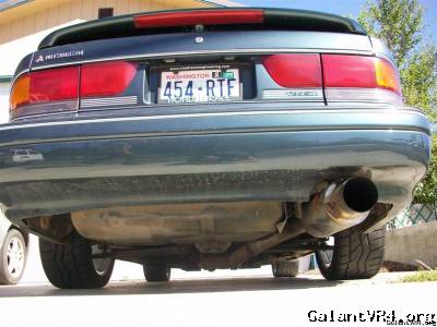

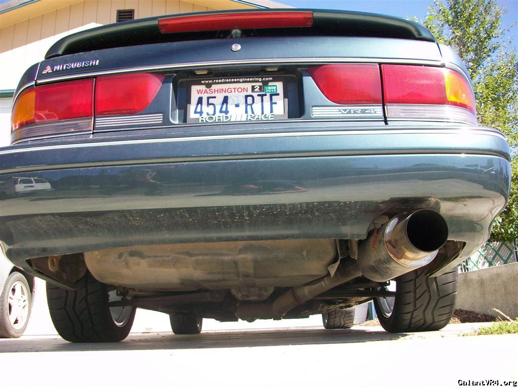

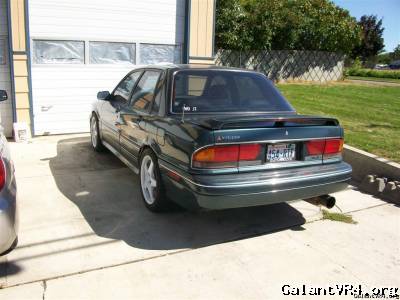

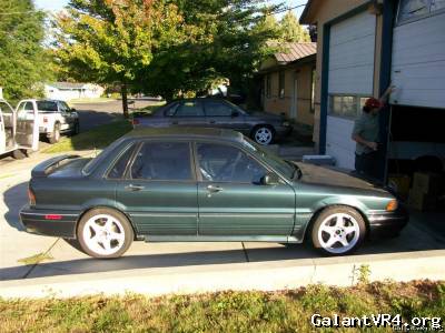

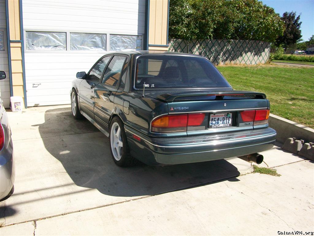

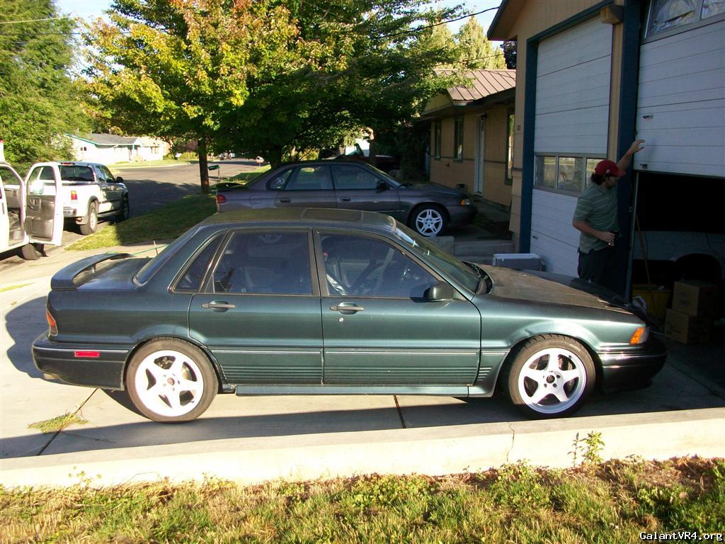

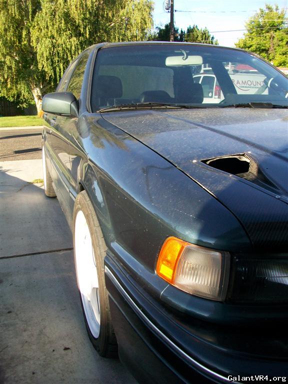

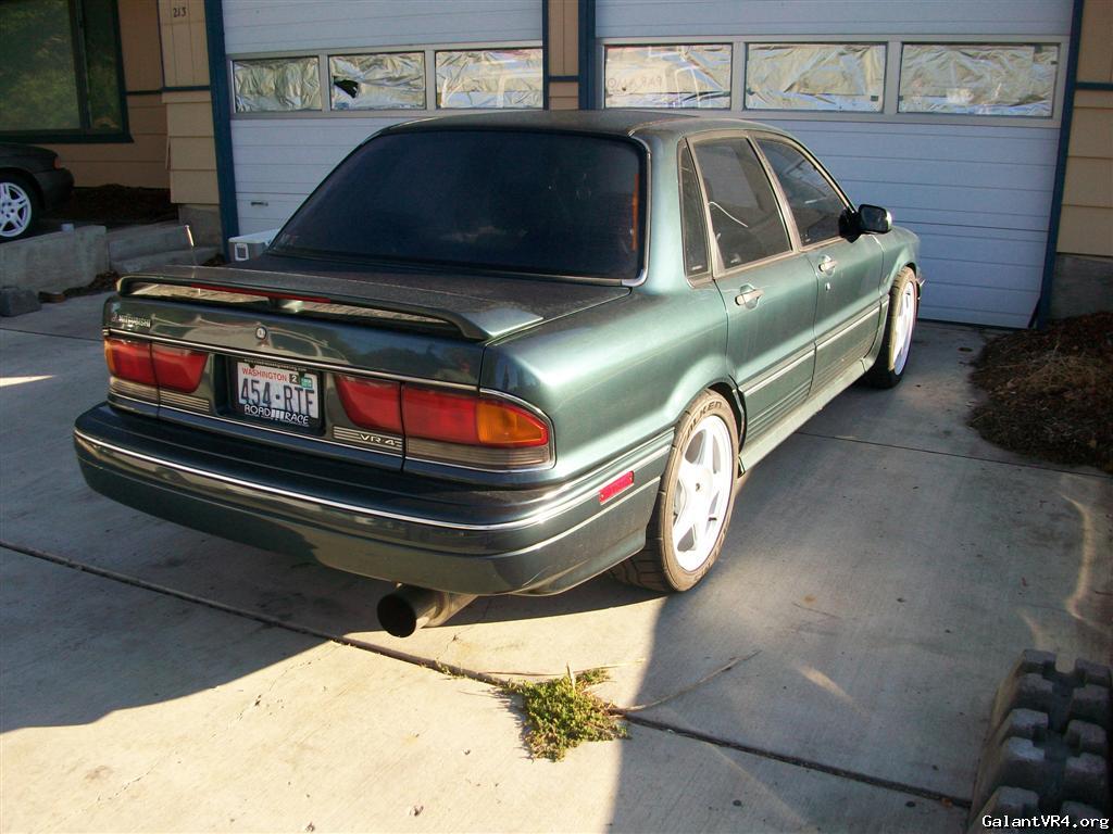

Quoting turbowop:
Karter runs 255's on his 8.5" wide wheels. I don't remember all the details, but he had to do some grinding in the rear and some fanagaling with the front coilovers and camber angles to keep the from rubbing on the springs. Once you go wider than a 245 on these cars, the tires become progressively harder to fit if you're trying to keep it all under the fenders.
Sadly my car looks almost exactly the same /ubbthreads/images/graemlins/frown.gif I can say that the dirt on it in those pictures isn't the same dirt that's on her now /ubbthreads/images/graemlins/grin.gif
With a +25 you might not have to grind the rear arm.

Oh, it might be worth noting that the passenger side looks like it sticks out a bit more because that fender is bent /ubbthreads/images/graemlins/frown.gif
