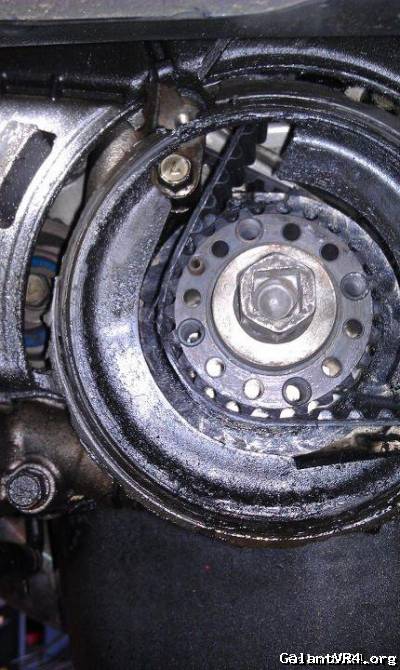

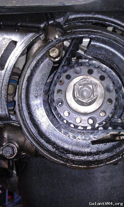

Couple possible causes. You'll probably find out after you pull the timing cover and t-belt. My first suspect would be oil because I see a lot of oiliness. Also, your timing cover is really messed up. There is no telling what could have gotten at your timing belt with such a gaping hole.

yea i shoulda added that the timing cover was all messed up, the crank pully had been rubbing on it and it was hella worn out, also there is alot of oil leaking but could that really strip a belt like that. it litterally happened in like 5 minutes.

Yup..... if the belt gets soaked long enough it will get soft/strip the teeth. A bad coolant leak could also cause it. Now there is a possibility that you didn't bend valves. I had the same thing happen to a friend of mine while his was sitting at idle. Now to our surprise when we pulled the head no valves were bent. But most likely if you were driving while it died like that you bent valves.
