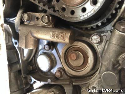

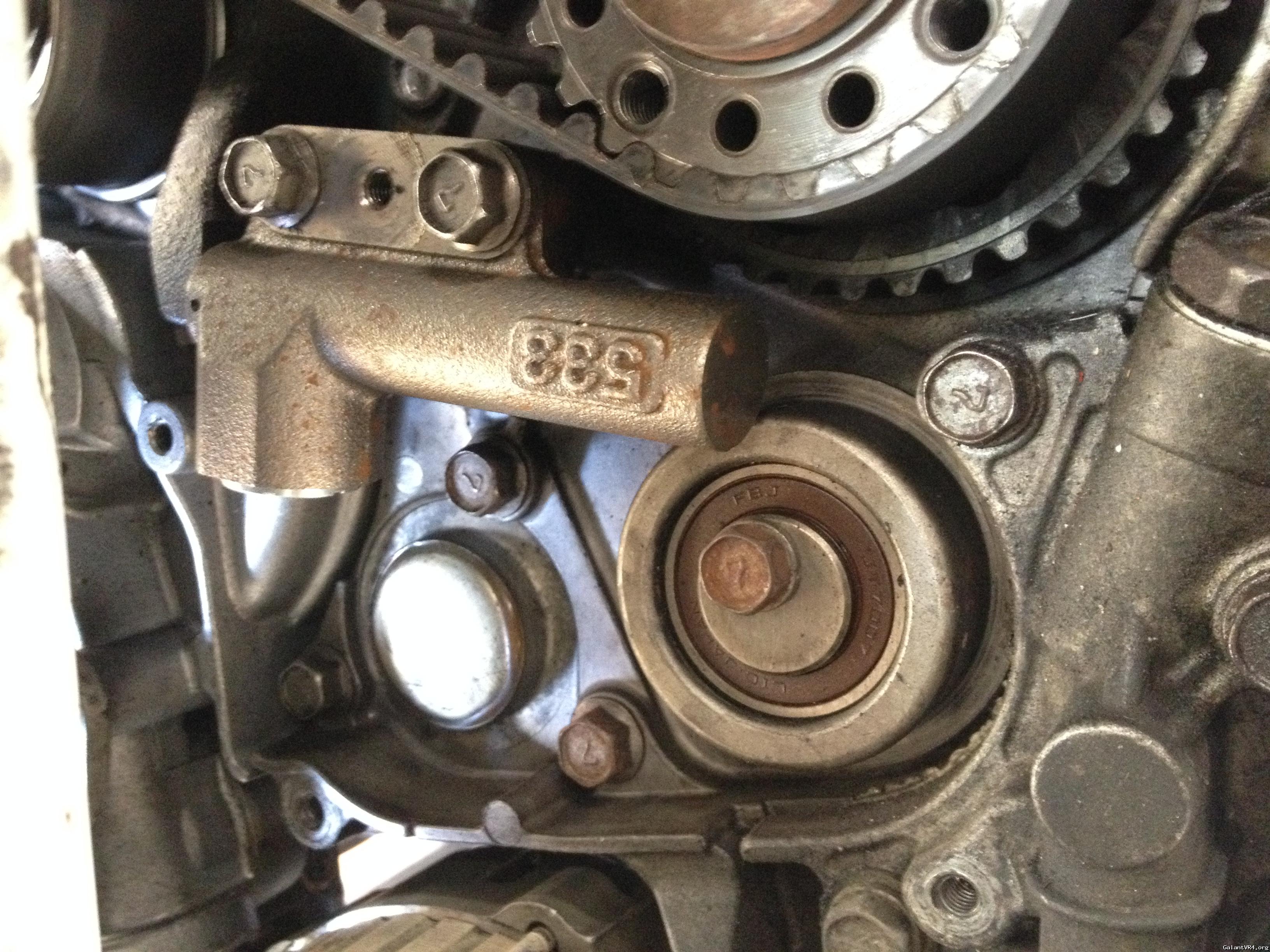

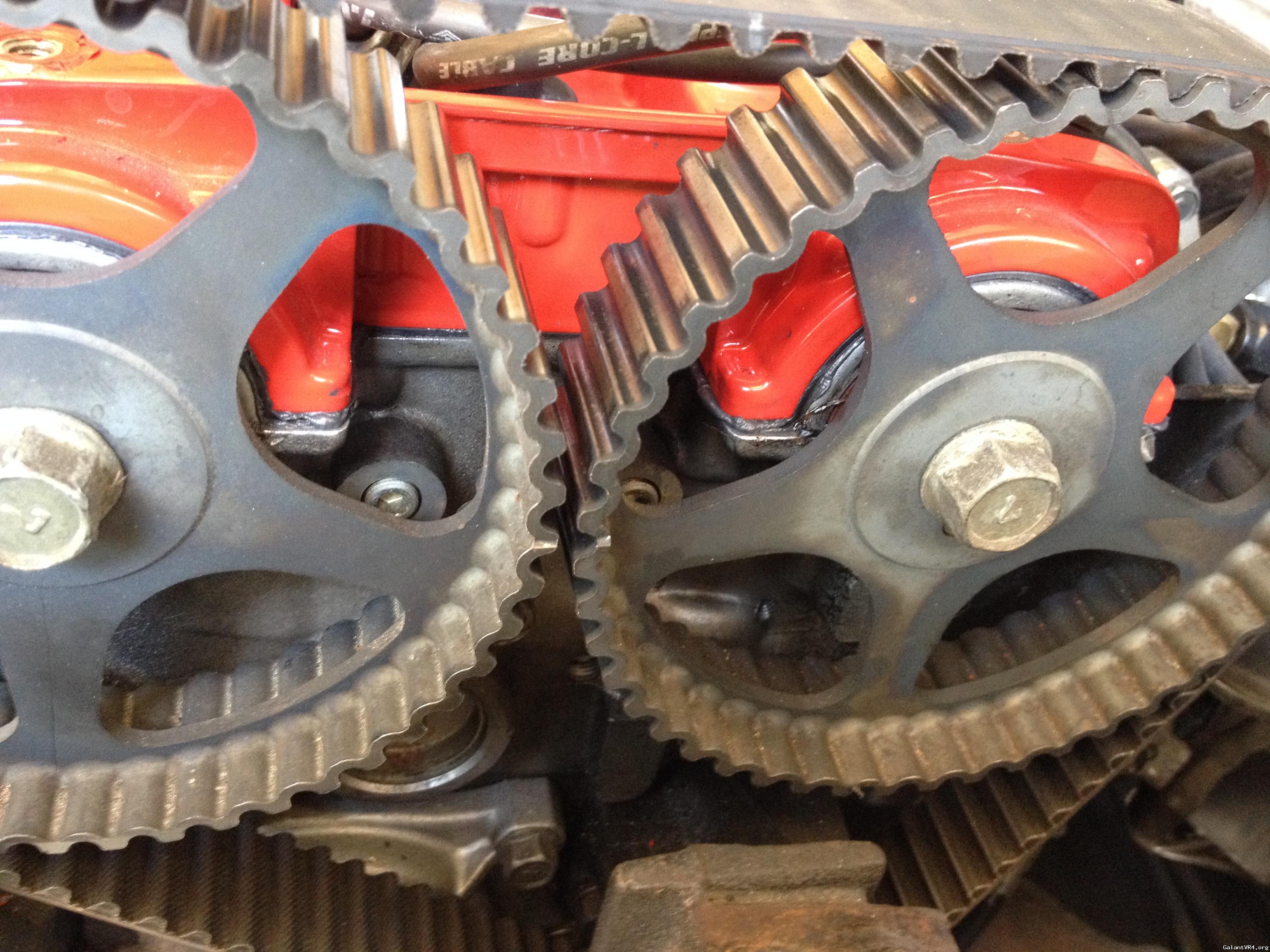

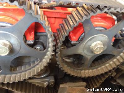

so pulled off the lower timing cover and set crank on the mark. the oil pump matches and the cams line up nicely so its in time, as for the tensioner it appears in good condition, no oil seeping or leaking brand unkwown check the pic to see if its oem, i flooded the engine yesterday after i turned it over a few times to see if the timing belt stiffened up, which it did but now the car will not start i got fuel, spark and it coughs and pops but dont start. where to go from here im not sure, this time of the year im always short on money so to go and splash out on all new parts isnt possible yet, luckily it aint needed for driving duties at the moment so i think i may bite the bullet and strip it, start rebuilding the subframes. i want to freshin up the engine, i have noise, checked the sump and its clear of metal flakes or grindings but im not convinced, not sure on what BSE kit was used in this car and ive heard not so great things about most other methods of doing this so i think im going to join the J.S.B club.

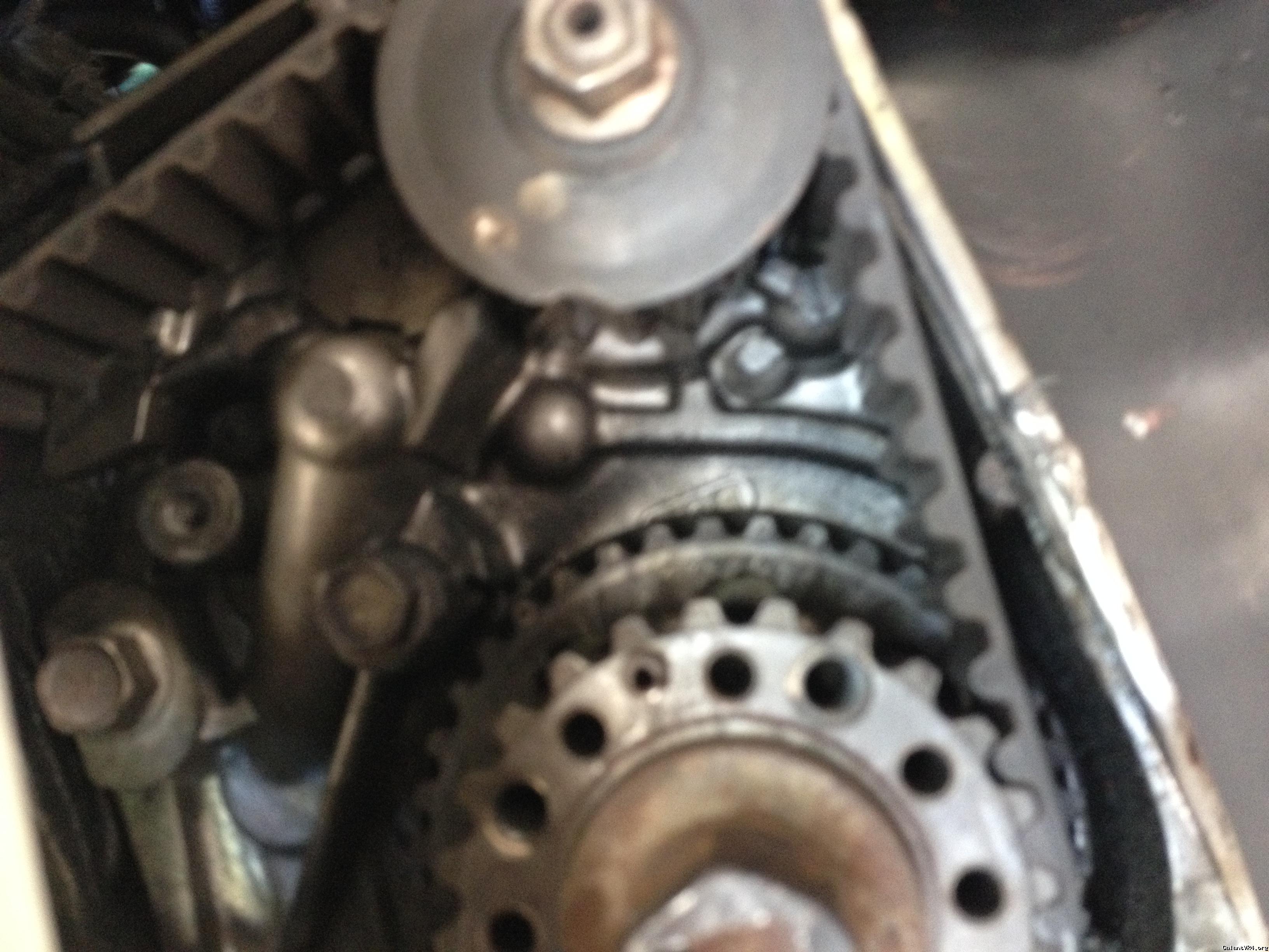

The OEM Mitsubishi timing tensioner assembly shows you the last 3 numbers of it's full part make-up, as embossed on the parts exterior; in your case a 533 which is a standard part for 6 bolt 4G6X motors, 4g61/63/67/64. This is part MD164533. So, you are good to go in that department.
Thought the teeth on the oil spacer/slinger behind the crank pulley was actually a balance shaft belt sitting loose there! Had to do a double take and look at both crank pictures!!
