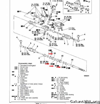

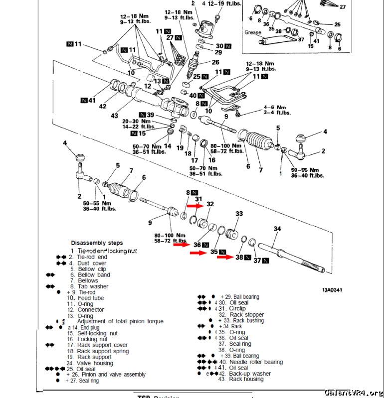

I had the rack and pinion out when I took off my inner tie rods, and they unscrew lefty loosy righty tighty tighty. There is just a metal piece at the end with flat spots on each side for a wrench or vise, to turn the rod in either direction.
Quick view of the front rack.
