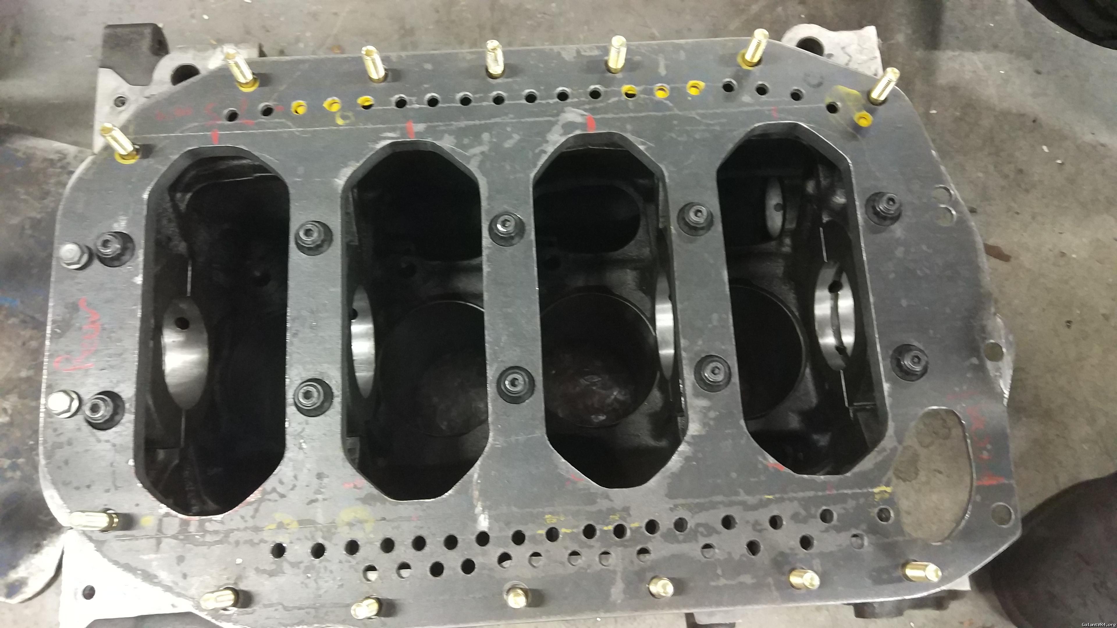

Seen this but don't like the idea of using the main bolts. I'm probably going to make one out of aluminum that bolts to the oil pan ring. Then weld an arched mesh windage tray over the top. I'll post when done.

wow. thats impressive.
