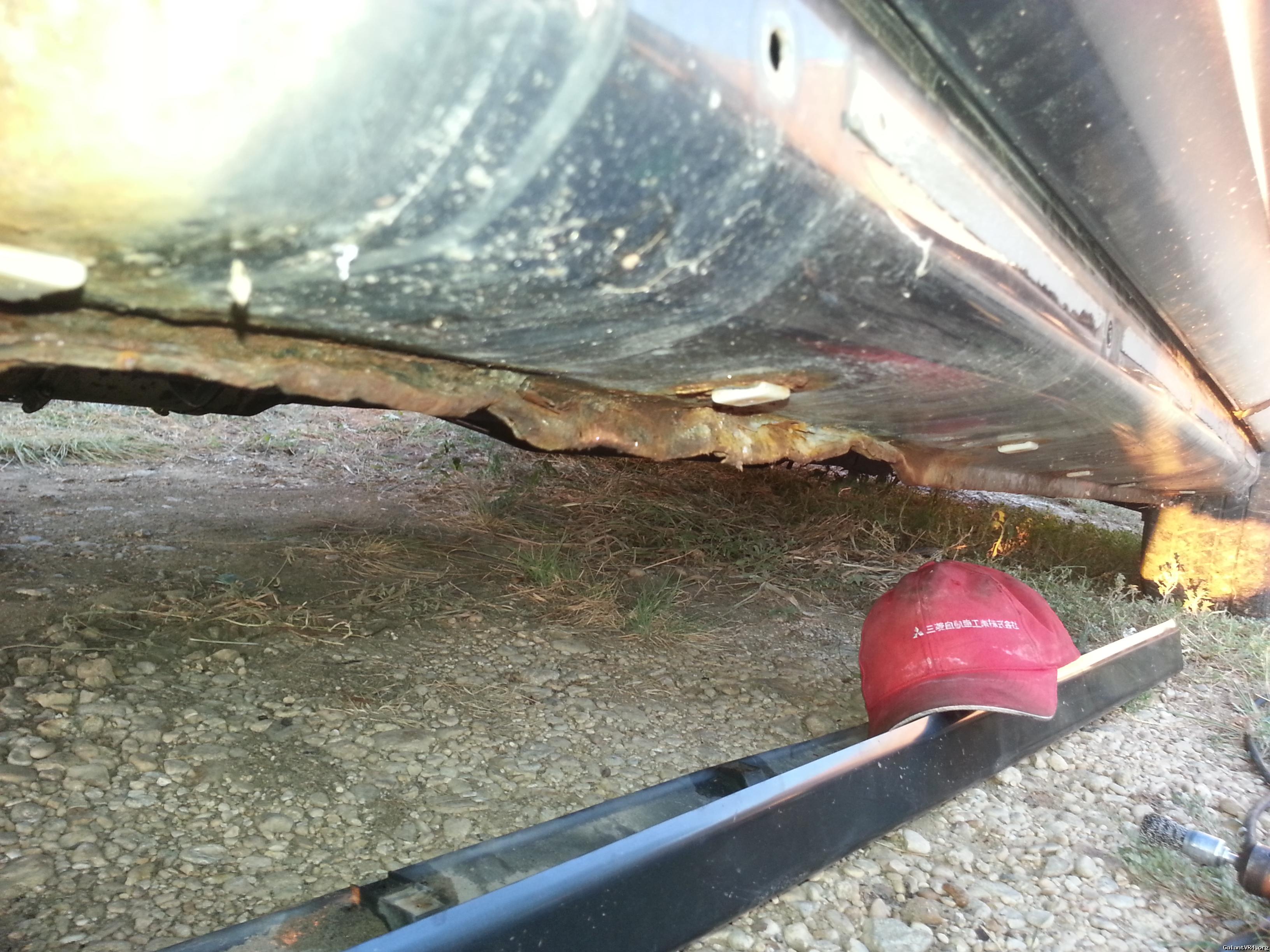

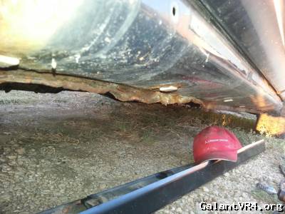

This is what looked like before I used pliers to straighten them out a bit.
They are by no means perfect, but still much better than they were and Im not done with them yet. This took about 10-15 mins per side with some robogrip like channel lock pliers

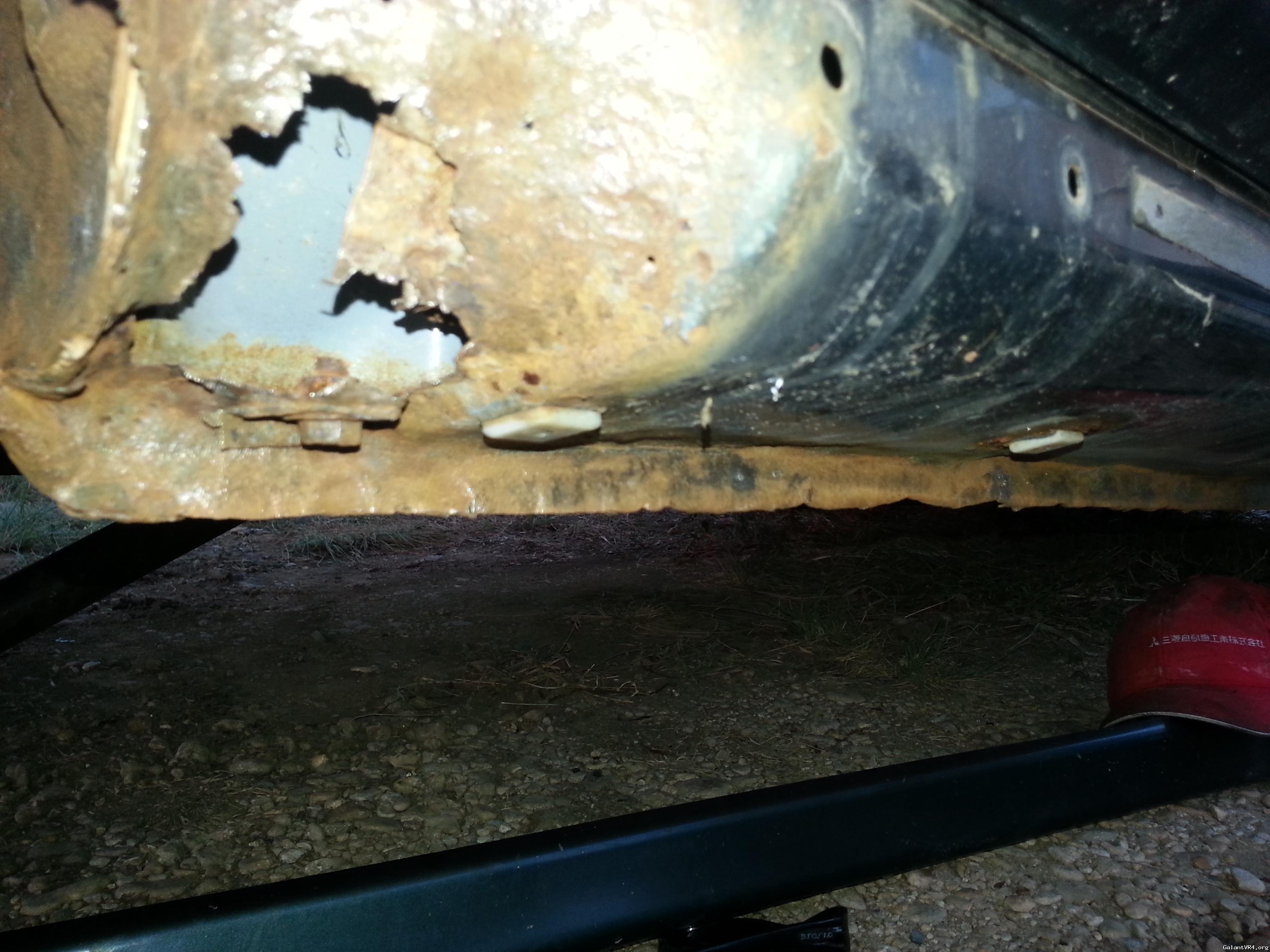

How did you make out with your repair? I recently noticed the jack damage to my frame rails was more extensive then I thought. Both rails are almost entirely severed in spots from previous owners mistakes. It looks like the head of a sisor jack went right through it. I'd really like to strengthen up the floor for stability and handling as well.
I am weighing my options. I considered subframe connectors like Curtis made. I consider cutting out the top and droping in a 2x2 square tube in and closing it back up.
Or maybe the same thing but doing it from the bottom.
It would be nice to tie in the seat rails too but that's an after thought.
Or maybe I just drop it off at a body shop
