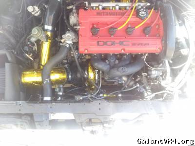

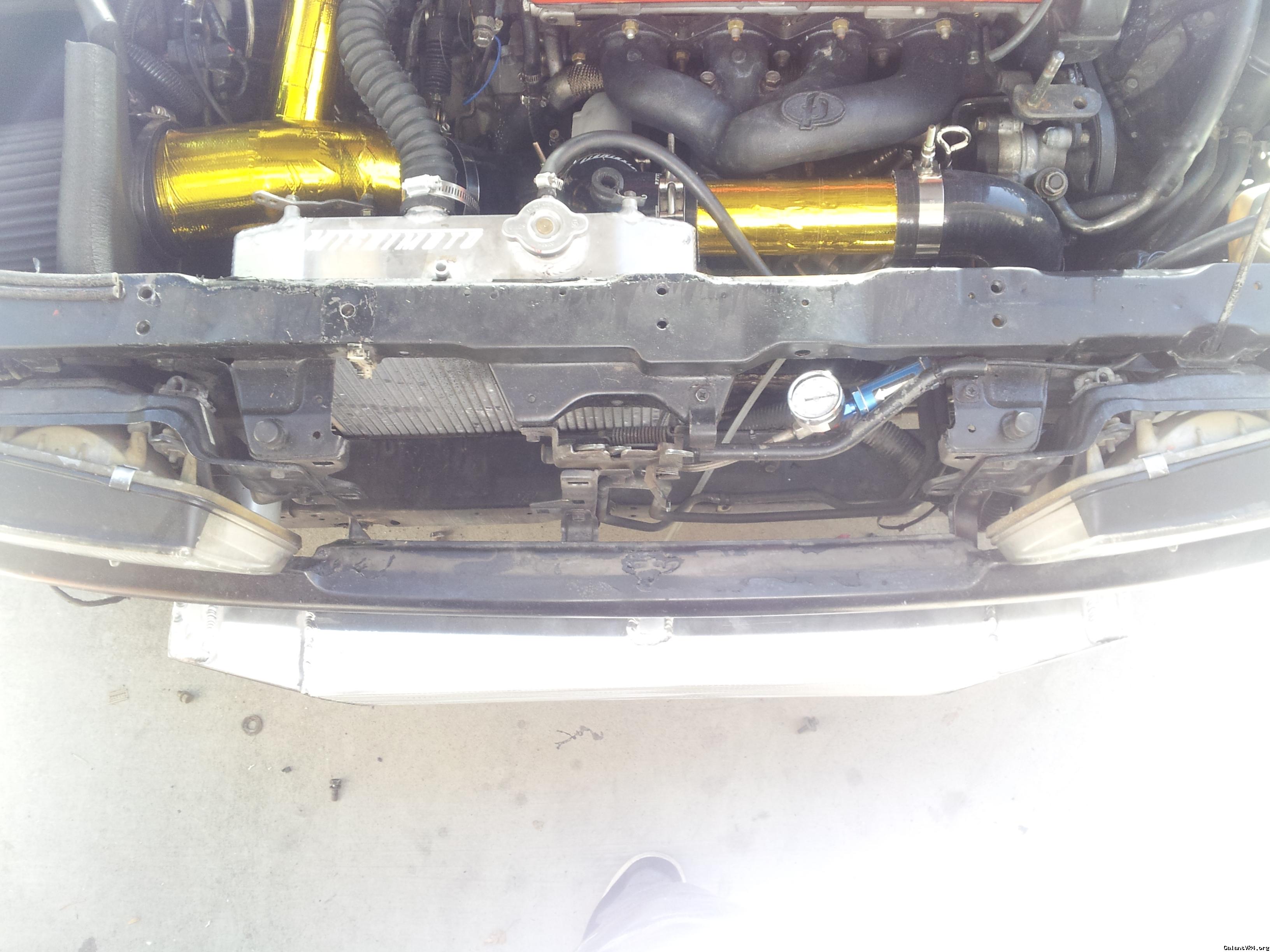

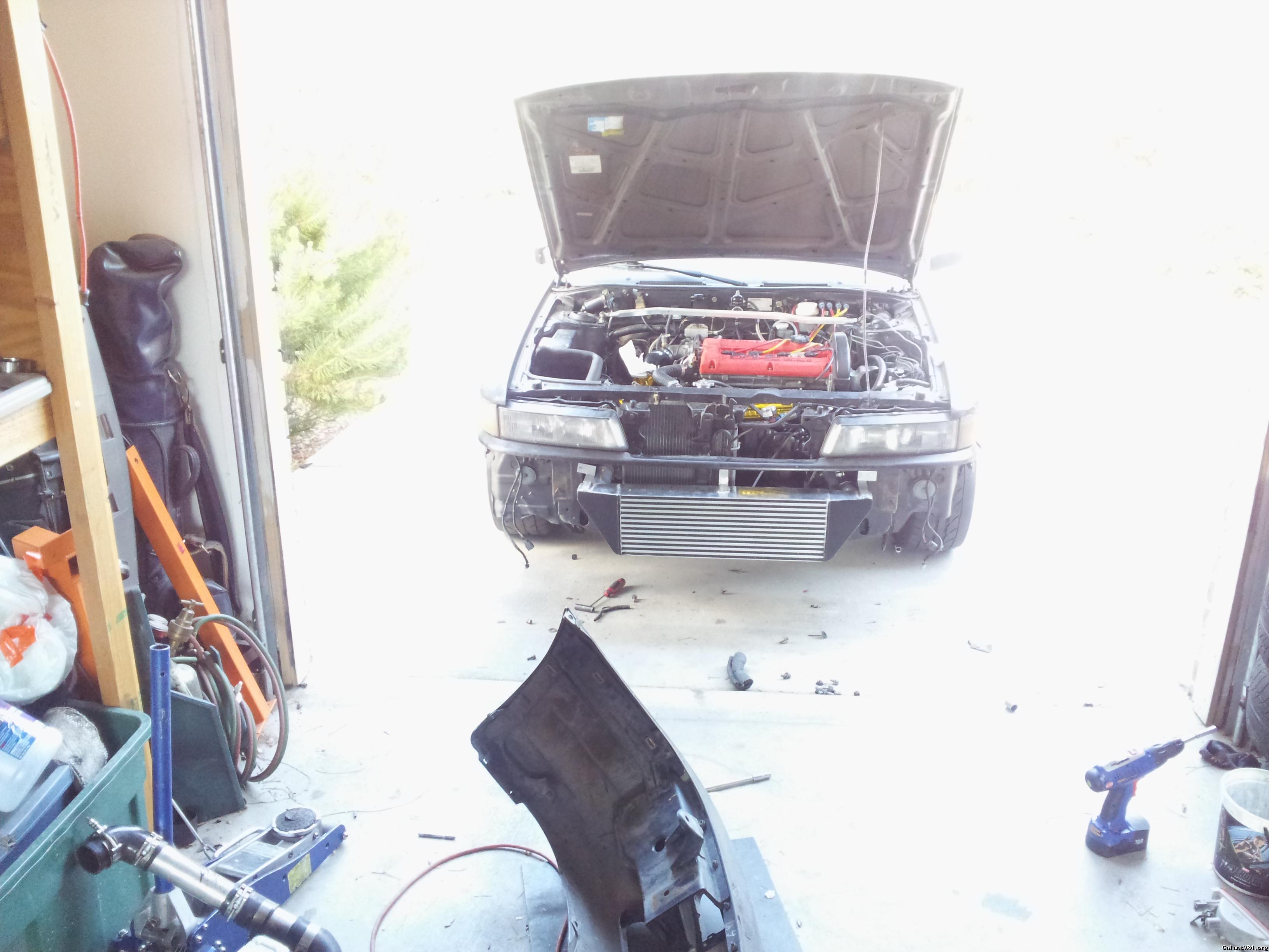

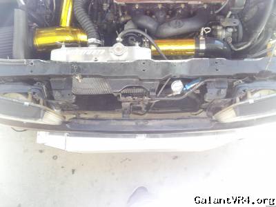

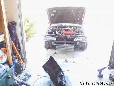

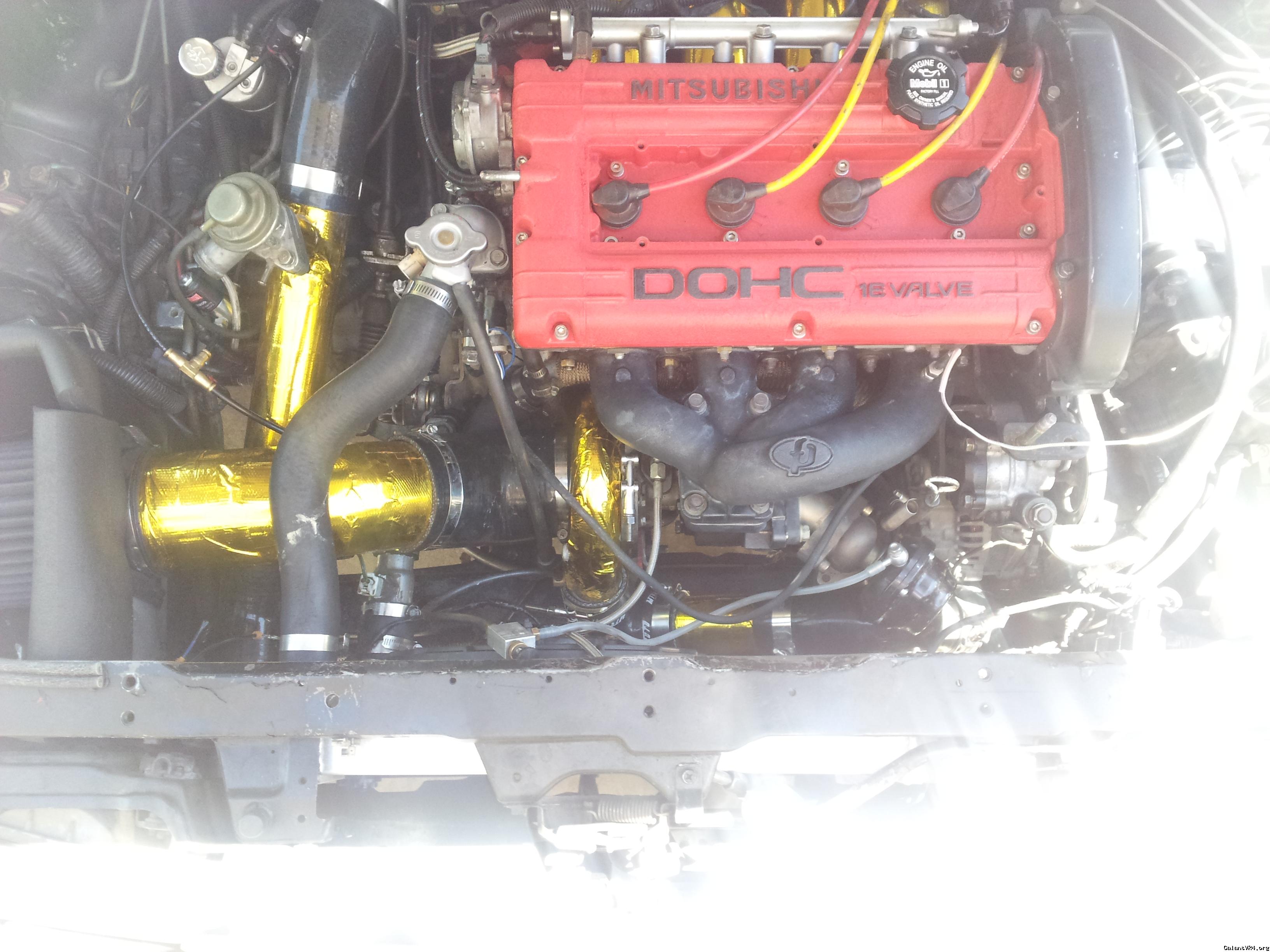

I bought a 1g VRSF kit. I haven't installed it yet, but several others have
bmxr152
Jul 31, 2010
231
Lake tahoe, NV
No a/c but i do have p/s. I just had to get another 45* 2.5" coupler and use a peice of 2.5" pipe to hump over my p/s lines when i did the downfire. I like how the piping is super short with minimal bends unlike the punishment or ets Gvr4s kit
