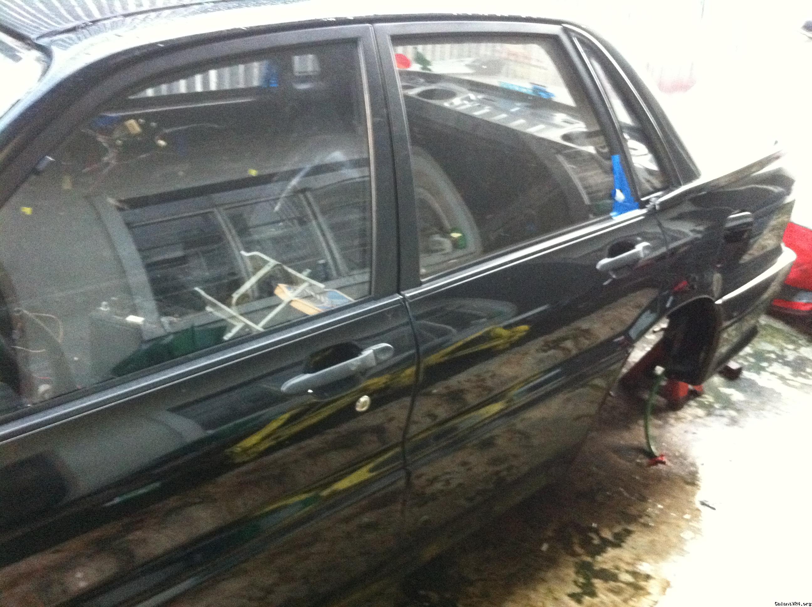

had this vr4 shell sitting in our house waiting for paint for the past 2 years.finally got her out and painted as ive been missing driving an awd galant.
here it was before paint
here it is after the paint.ill post as i go along,shes been home 2 weeks already.

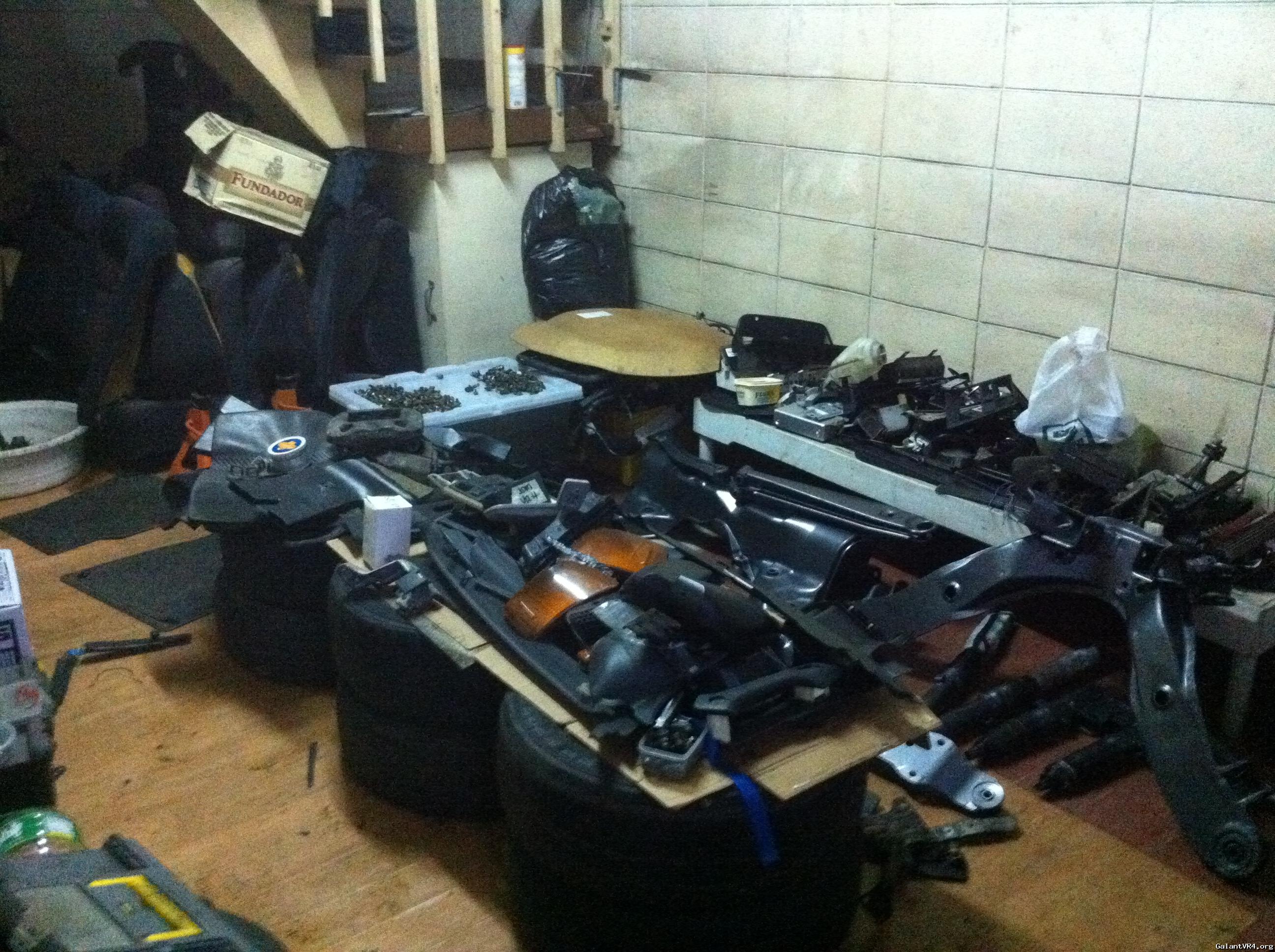

parts waiting to get on

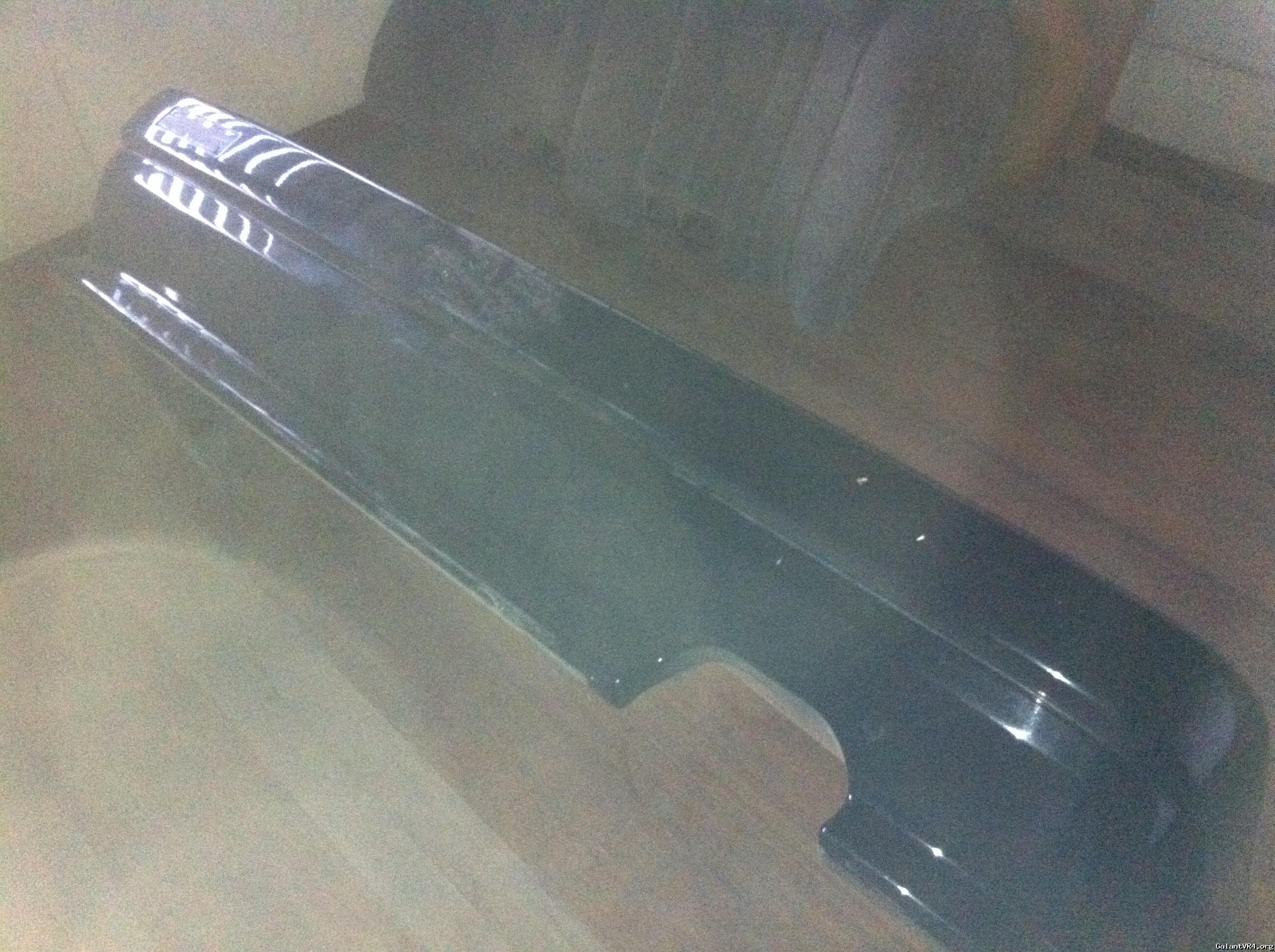

amg parts are rare here too,thats my spare rear amg bumper my friend found.
i have another rear bumper here in black.

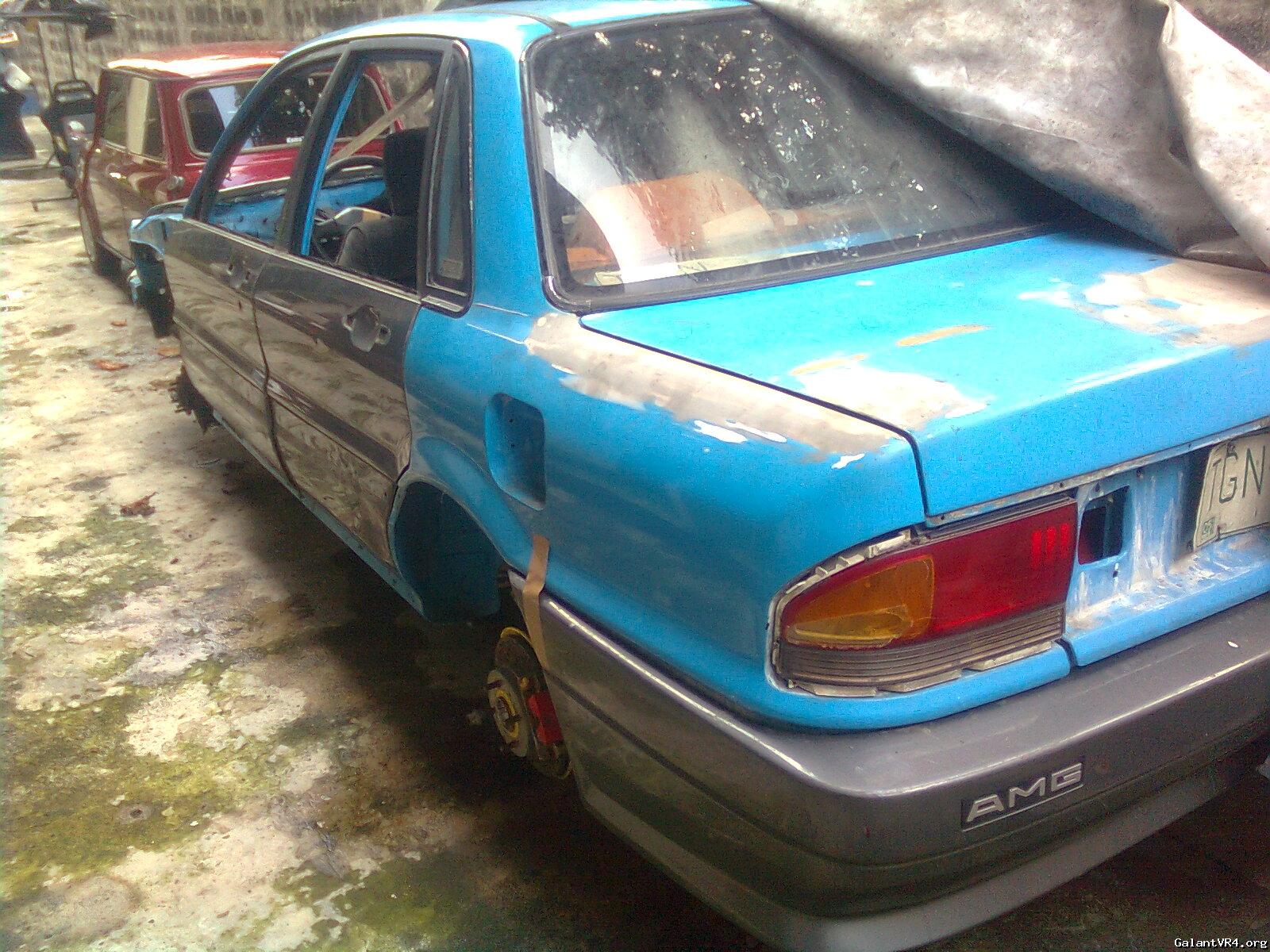

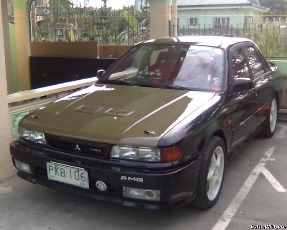

heres a pic of the converted to vr4 shes replacing
should turn out same just cleaner and all black

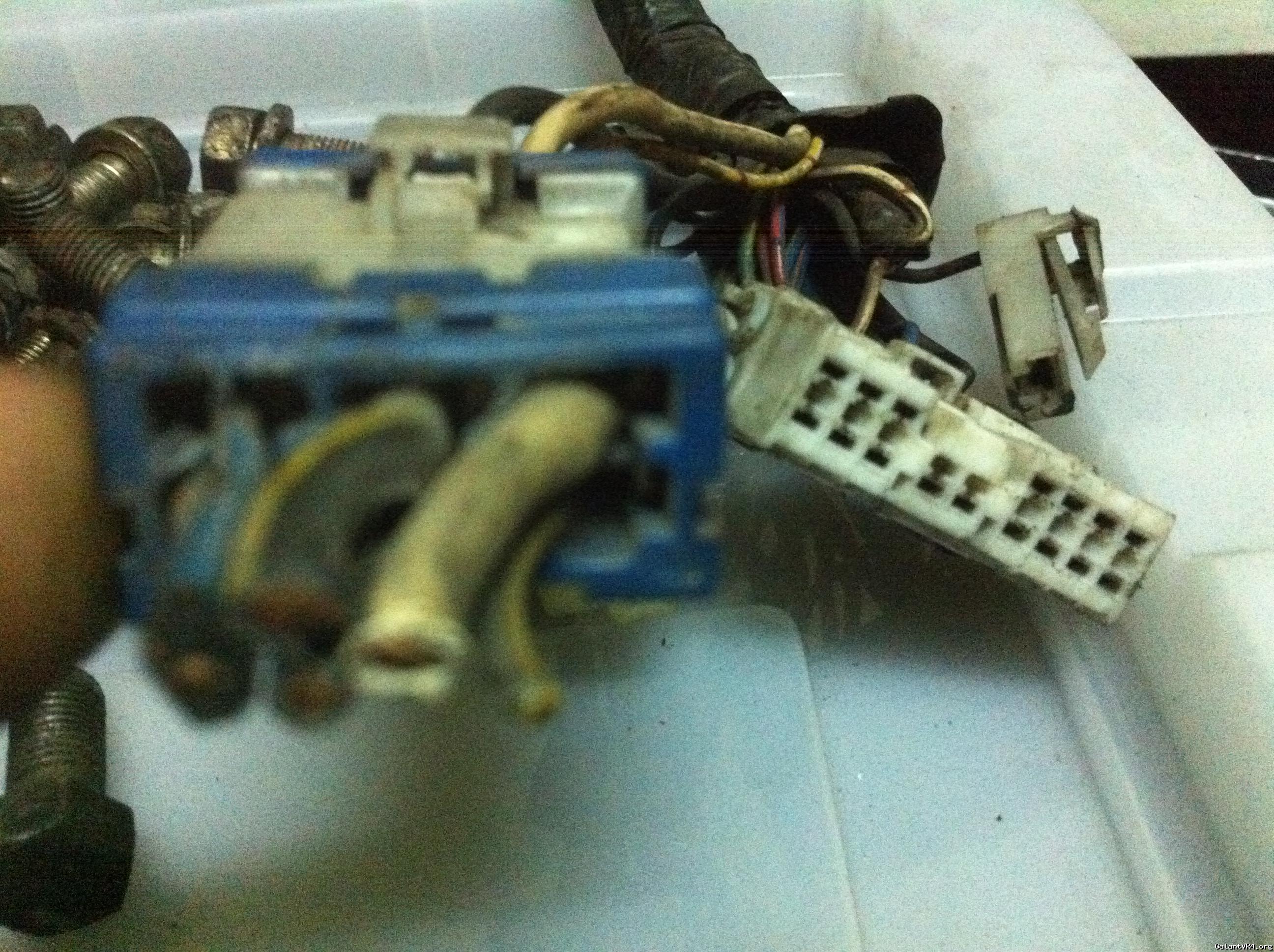

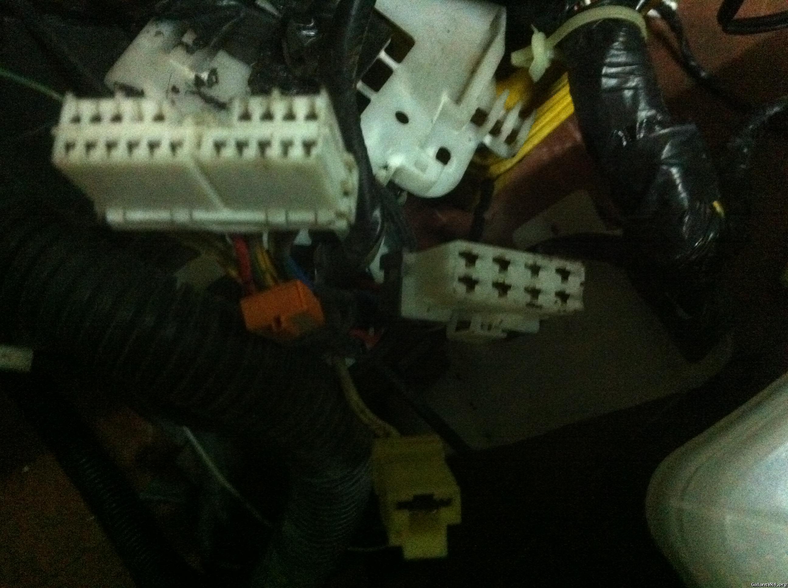

i did run into a problem,this vr4 didnt have a wiring harness,i did salvage the engine to ecu harness(1g dsm) from the old vr4(body harness is toasted) and got myself a jdm body and engine bay harness(engine harness was sold with engine).anyone know if and how i might be able to adapt the dsm engine harness to the jdm vr4 harness?adapting the jdm to left hand drive is easy but the connector to the engine harness is different from the dsm connector.
here are some pics of the problem,they go to the upper passenger side(LHD) of the dash
DSM
JDM converted to LHD

thanks man,but its not what i was looking for.
ive searched around but im not getting definite answers.
in the mean time im just wishing to get which wire is for what and ill go from there.

i think that 8 pin wire is the one for the ignition, it looks like when i put my turbo timer in, but i could be wrong and it could be a 6 pin for the ignition.
transparentdsm
Jul 27, 2011
3,690
Cherry Hill, NJ
ok ok, i was wrong about the 8 pin. i know what those wires are for kinda. that single wire is the o2 sensor wire. here is another link to show what i mean.... click ... now ill look more into it and see if i can figure the rest out.

Well life goes on,the wiring problem is being resolved by a local guy who did my converted vr4.a little steep on price but all the wires will be new.

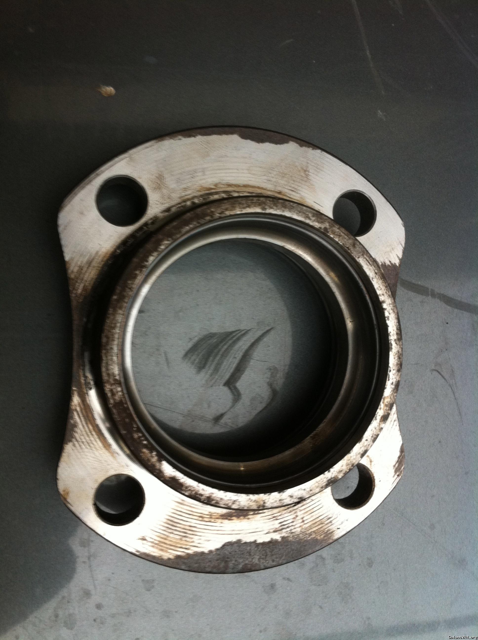

Gto/3000gt spindle had its bearing removed a while ago,looks promising as ive found a hub that looks same as the gto and has the same spline count of the 6g.problem is the diameter of the part that goes in the bearing is a tad smaller.im gonna hit up the local stores and see if i can find a match for it.

Im not sure if the jdm gto front spindles are different from the usdm 3000gt (dont even know if i got 1g or 2g,the rotor diameter is 296mm with my old tape measure.rears i got from someone else so i know its a 1g rear with a single piston)
but heres what ive found out.
The gto spindle does not fit the galant shocks,its a tad bit wider.need to have it trimmed.not a problem if your running evo shocks.
Ball joint is bigger,same visually but a tad bigger.will use the gto balljoint in the galant as it has the same diameter ang mounting style.
And of course the bearing that im trying to figure out.

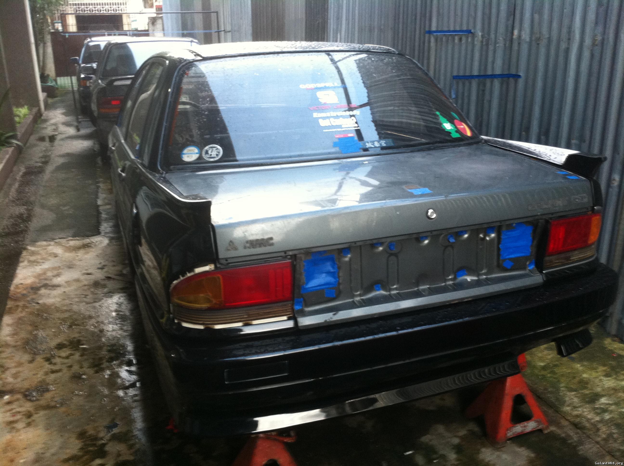

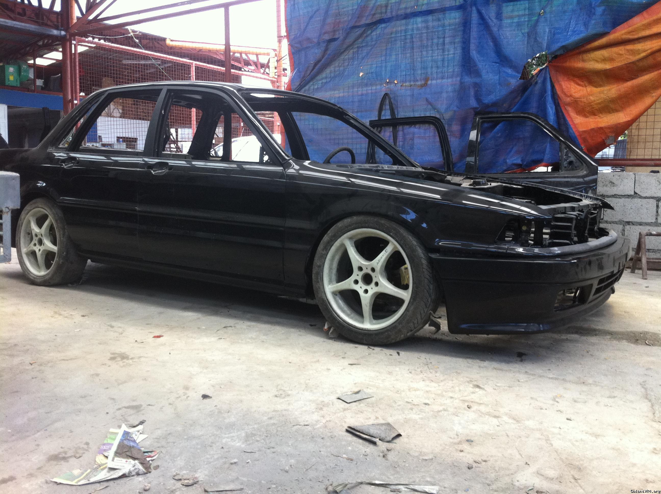

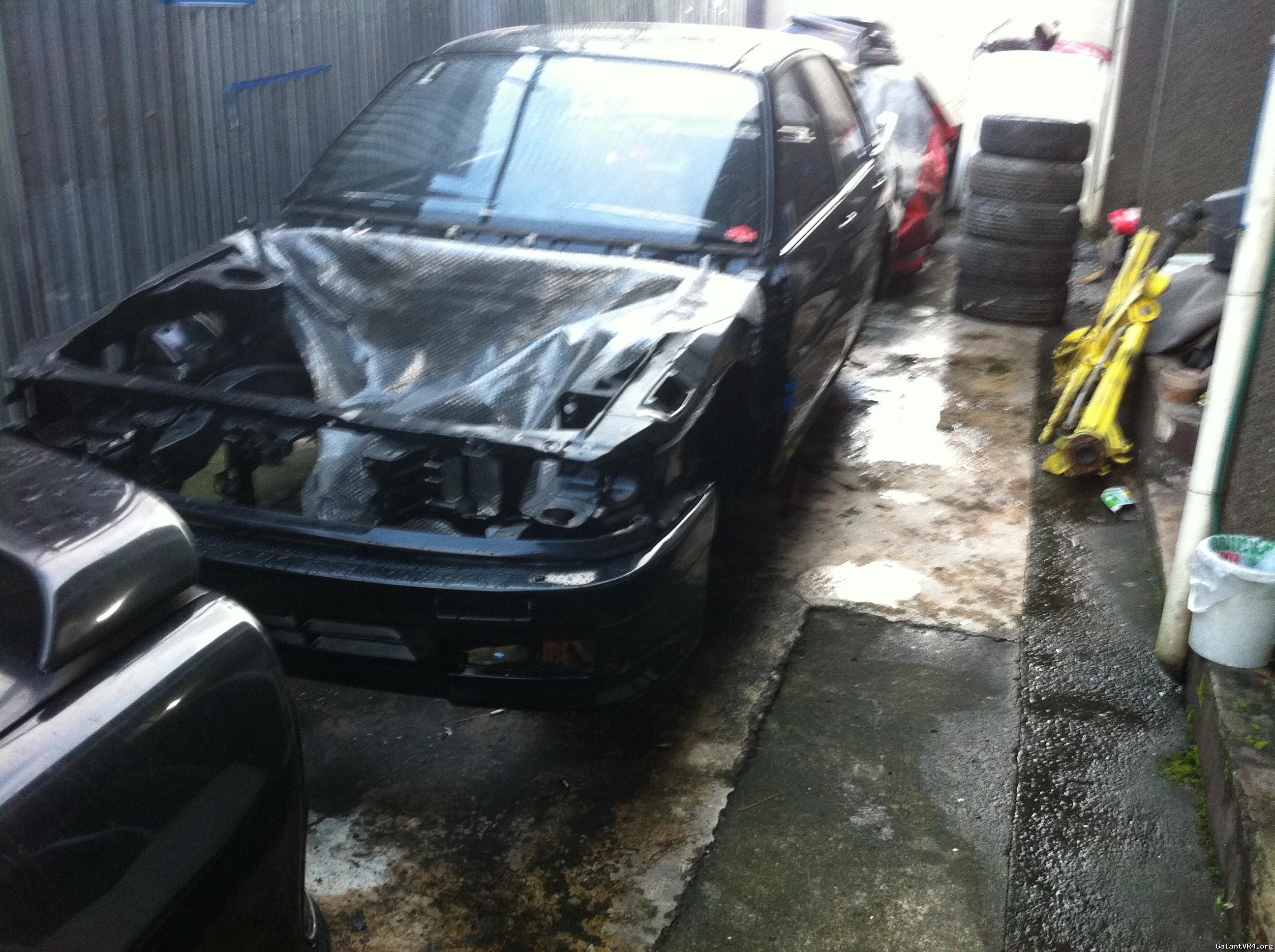

a little update
a pic of the dd
a few pics of progress
subframes are out and is on jackstands
temporary trunk

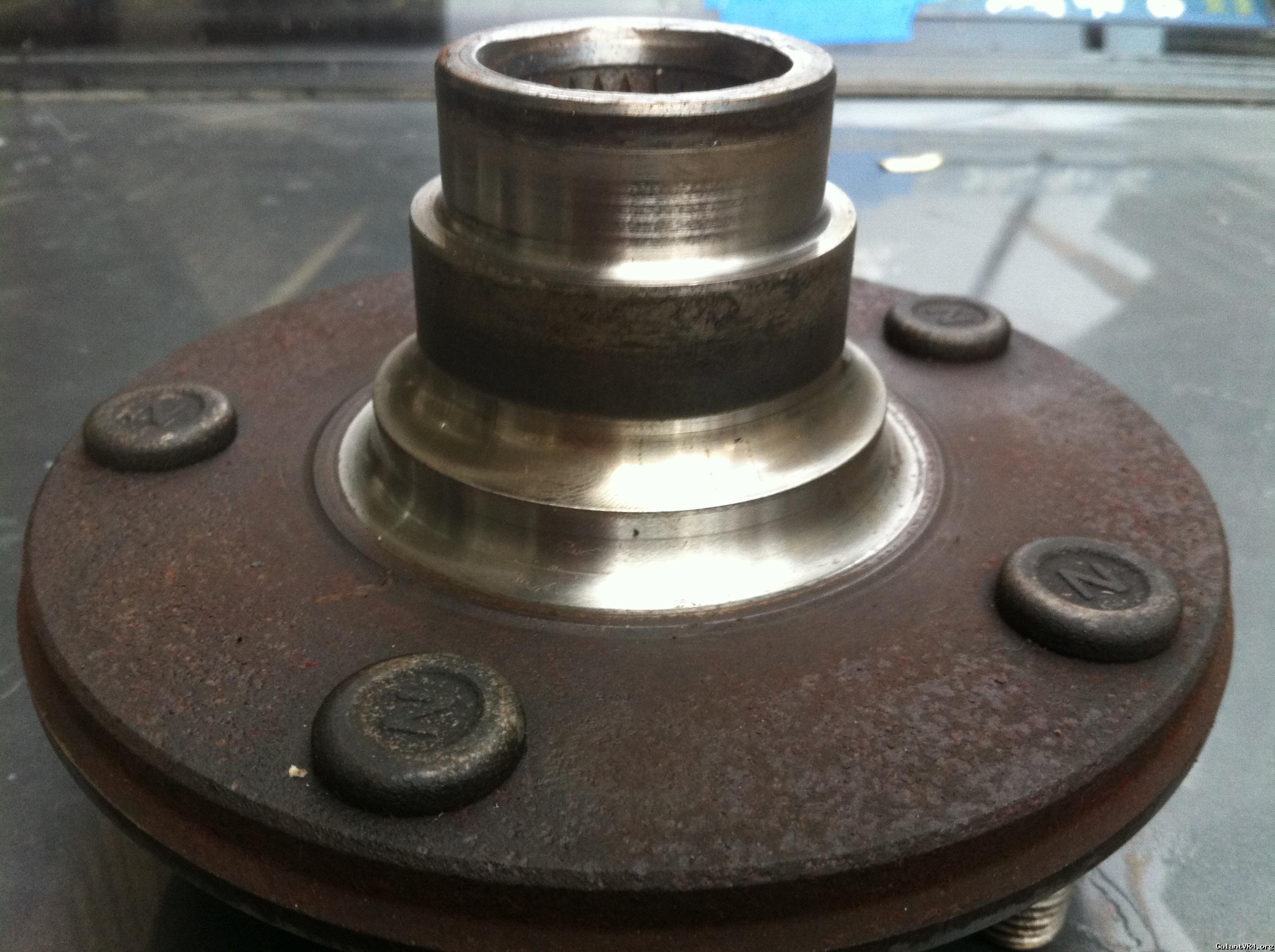

3000gt/gto project
hub and bearing removed
was thinking of having this part machined to accept a new bearing since theres bearing material left from the 3000gt/gto or keep looking for something else that fits

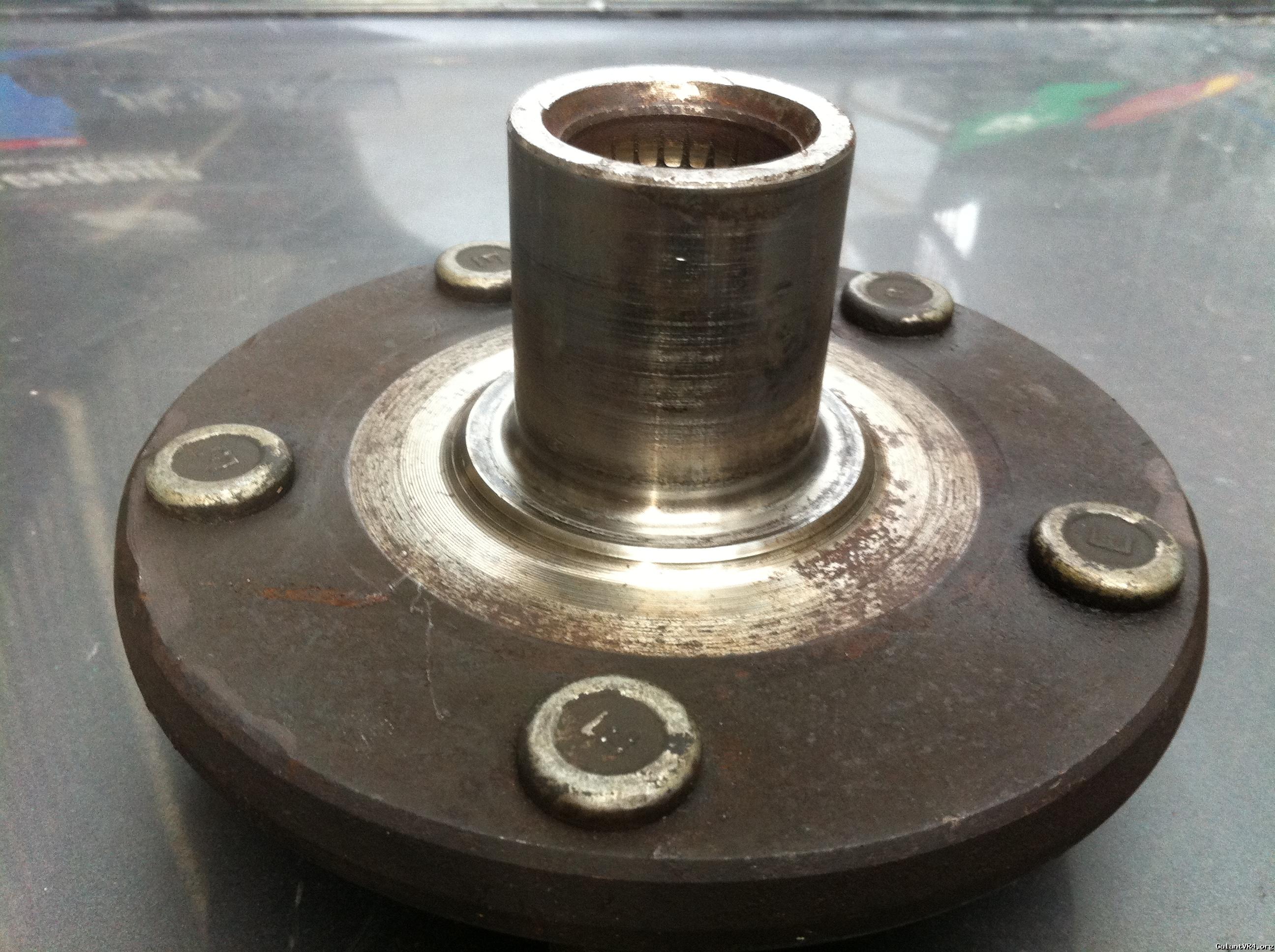

gto hub with the larger shaft
8g vr4 hub im gonna try to use.same shaft and spline for the 6g vr4.
not sure if other models have these type also.
i just had these laying around so no $$ spent.a little different at the base since theres no bearing left over and about a mm or 2 shorter.(not sure since i lost my caliper)
really hoping this works out,if not im gonna make brackets.
very hesitant to put the 3000gt/gto spindle in the trash pile.
*6g vr4 ball joints do fit the 3000gt/gto spindle,was probably just lazy the other day.
im open to suggestions guys so pls feel free to add anything you guys think off.

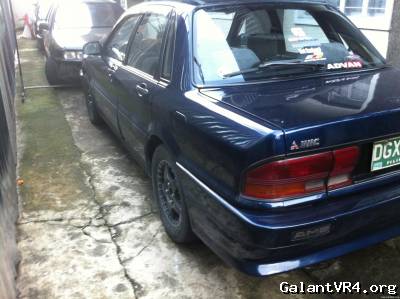

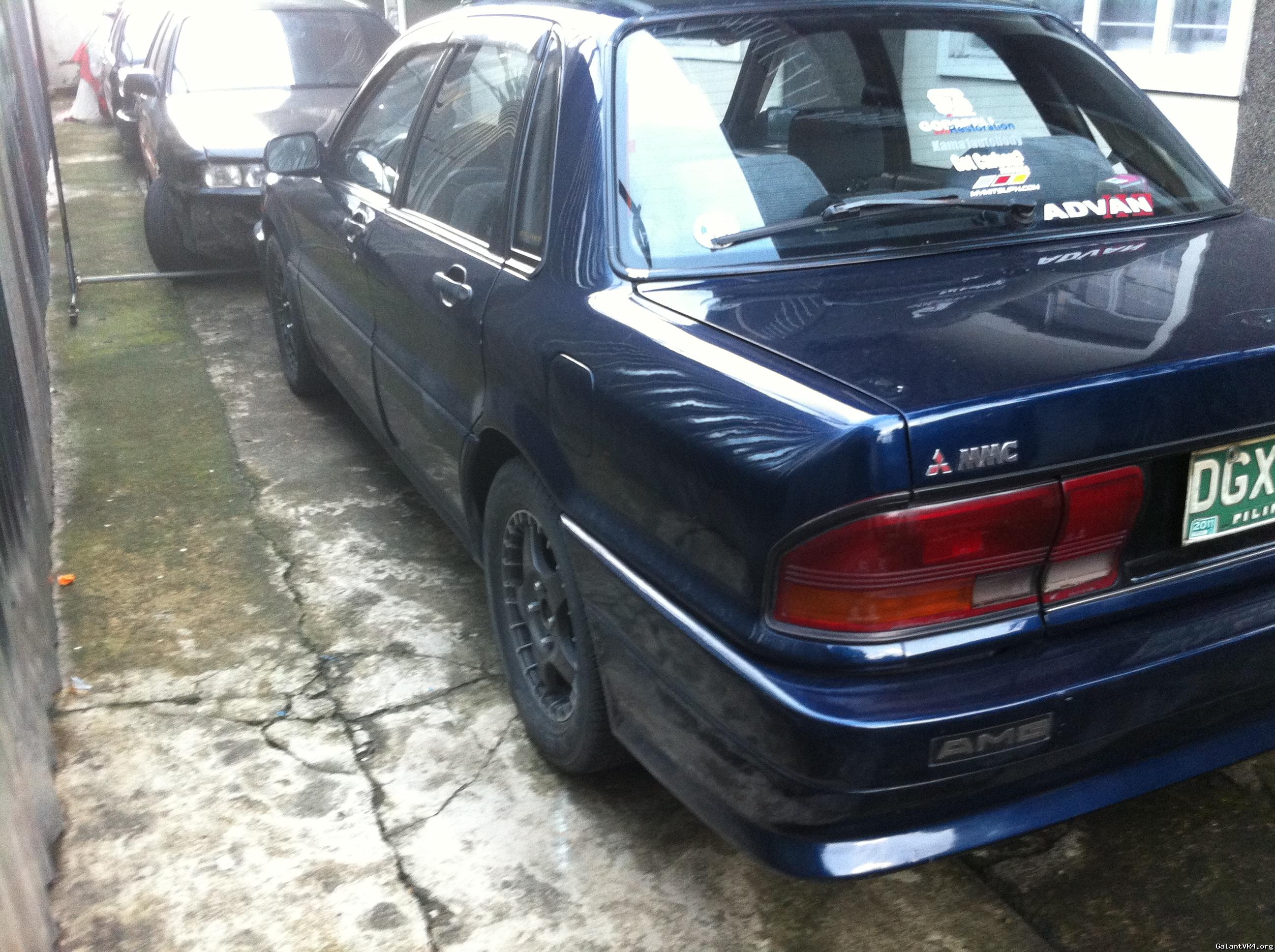

oh and heres the spare rear amg bumper as requested
