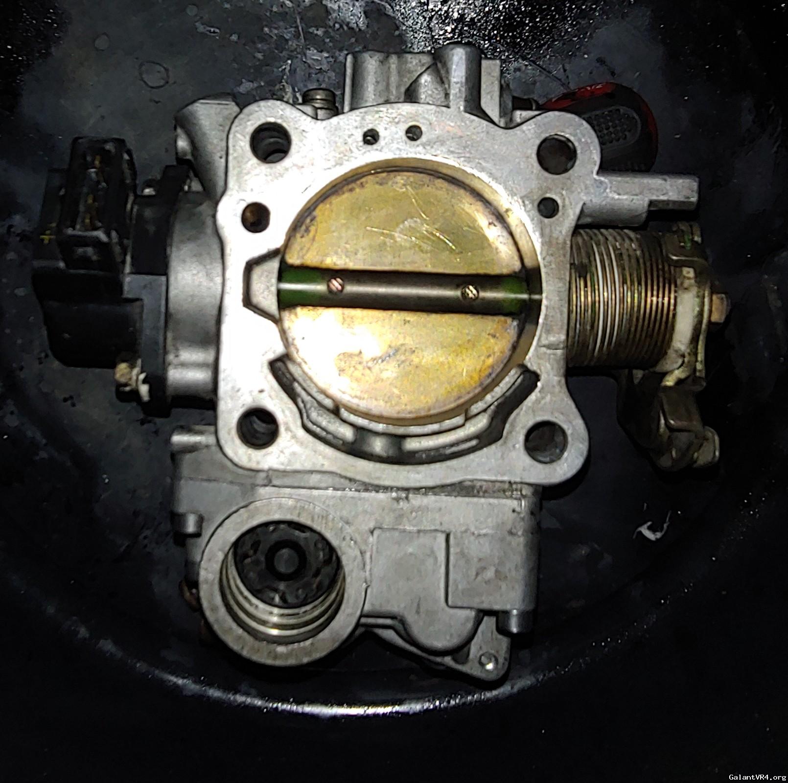

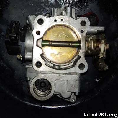

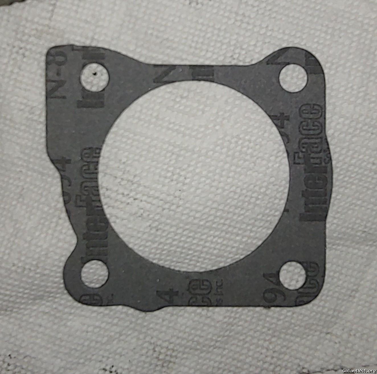

The intake manifold to TB gasket only has the mounting holes in it, but it looks like the TB has holes at the 12, 2, and 10 o clock position that I assume go ... somewhere. Is this the right gasket? What's tripping me out is that the manifold itself doesn't have any small ports.

yes that is the correct gasket. the holes are for various things that may be used or not used on the same throttle body casting. The gasket and inlet manifold will block off the holes which aren't needed.
