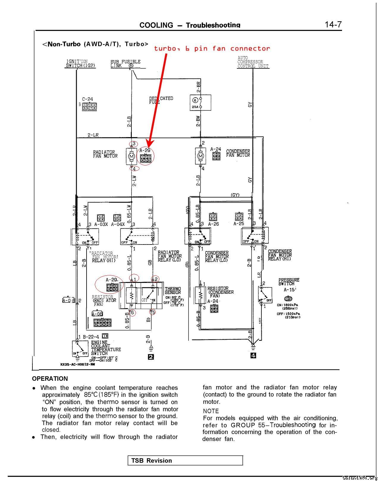

Check out the circuit diagrams located in the factory service manual for the Turbo fan harness. Actually, here it is, along with the wire color chart:
Connector A-29 is the one you're interested in. It has 6 pins. From the diagram, you can see the pin designations as follows:
Pin 1--------Blue{L}-----------------From Fan LOW relay to Resistor
Pin 2--------Green&Black{GB}---------From Fan LOW relay trigger to Thermosensor
Pin 3--------Blue&Black{LB}----------From subfuse panel to Fan
Pin 4--------Blue&White{LW}----------From Fan Relays to Fan
Pin 5--------Black{B}----------------From Thermosensor to GROUND
Pin 6--------Black{B}----------------From Resistor to GROUND
Somebody should check that over to make sure, but I'm pretty sure I read the diagram right. The sensors just control which path the fan current takes to Ground using relays. If the Thermosensor (the one in the radiator, I think) is on, the relay that routes current through the resistor (slower fan speed) is switched on. If the Engine Coolant temp. switch (the one at the thermostat housing) is on, another relay that routes directly to ground is switched on, totally bypassing the resistor (regardless of the state of the Thermosensor), resulting in a faster fan speed.

Since I would think the increase in fan speed is achieved by increasing voltage across the motor, I can understand how it works fundamentally. A given is that the low speed relay would already be active (at 85c), allowing path to ground, with an further increase in temp (to 97c), measured by the thermostat sensor which would also allow a path to ground. The low speed relay activates at 85c, stays on until it drops below that temp and the extra voltage is achieved with activation of the high speed relay at 97c. Since it is wired in an "or" configuration(Both relays share a common positive and ground in parallel) rather than an "and"(Single positive and ground in series), even if the low speed relay is not working, the high speed relay will kick on at 97c regardless of the low speed relay.
What I don't see on that diagram is the fan itself. I see how power is reduced going through the resistor after activation of the low speed relay and full voltage through the high speed, but where is the fan? It would seem that the fan would need two inputs for this to work.
/brox
cspetros
Jul 19, 2008
512
Port Norfolk, VA
This is turning into my circuits class.... /ubbthreads/images/graemlins/wink.gif
You've got it /ubbthreads/images/graemlins/smile.gif. A voltage drop occurs across any resistor with current flowing through it, so lack of one in a circuit increases voltage across the said motor. Definitely nice to see the OR and AND analogy to this.
The key is that the fan only has 2 pins; the high pin {3} (12 volts), and the low pin {4}(The GND pin). Pin 4 can either be totally grounded (High speed), grounded with resistance (low speed), or no ground (OFF), depending on the state of the 2 sensors.
This is correct. A semi-common issue found in these cars is a bad resistor. The result is that the fan only comes on when the condition for the high speed relay is met (97degC). Many people simply remove the resistor.
To finalize: the fan motor is across pins 3 and 4. Pin 4 can be at 1 of the 3 states listed above (High{zero resistance}, Partial{resistance}, Off{infinite resistance, or open circuit /ubbthreads/images/graemlins/hsugh.gif}).
Oh, and one important note I forgot to mention above: current always takes the path of LEAST RESISTANCE. So, even though the High speed and Low speed relays share Pin 4 of the fan (the Low speed relay will always be On when the High speed relay is On; the Low relay is On for any temps 85degC and above), the current will flow totally through the High speed relay, because it's a straight, non-resistant path to ground.....
Hope that makes sense. It's hard to pick the correct way to order all of this in writing sometimes... but it's all good /ubbthreads/images/graemlins/hsugh.gif

The manual defines the "Thermosensor" as the one inserted into the base of the radiator (Manual Group 14, Page 9), and the "Engine Coolant Temperature Switch" as the one inserted into the thermostat housing (Manual Group 14, Page 31)
Your summary is correct. It's important to note that Pin 4 has 2 branches, one to the low speed relay, and one to the high speed relay. But, essentially, 3 is Fan High, 4 is Fan Low....
Also, think of all the components on the A-29 connector as being on the "fan side"... this helps you get your head around how the connector is oriented. You will notice that the Fan motor, the resistor, and the radiator thermosensor, are all part of the same little harness..... this harness plugs into the main control harness (the one you're interested in getting the pinouts of) so, you'll see that:
Between pins 3 and 4 (of the fan side connector) is the fan motor. When plugged into the main control harness, Pin 3 links the fan motor to the subfuse link. Pin 4 links the fan motor to the poles of the high speed and low speed relays.
Between pins 1 and 6 (of the fan side connector) is the resistor. When plugged into the main control harness, Pin 1 links the resistor to the low speed relay pole. Pin 6 links the resistor to ground.
Between pins 2 and 5 (of the fan side connector) is the radiator Thermosensor. When plugged into the main control harness, Pin 2 links the thermosensor to the low speed relay trigger. Pin 5 links the thermosensor to Ground.
By connecting A-29 (fan side and control side) together, you're just making all of these links.

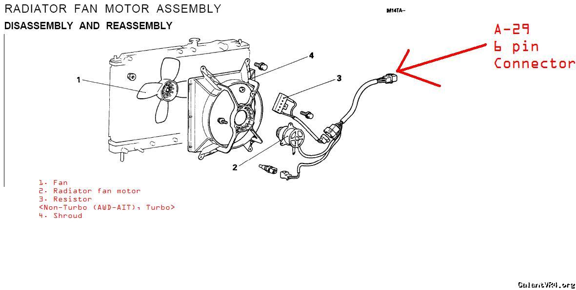

Hey, I found this. This is the little harness I mentioned, containing the fan motor, the resistor, and the thermosensor.
This connector connects to the main control harness, joining these three items to where I mentioned above. I guess I'll wait till you use MSPaint...

So tonight I got the bug to figure the entire thing out. I have been able to get the fan working by grounding out the sensor plug. I learned one thing in the process. Onto the definitive answer.
The image of the clip from the schematic above is from the HARNESS SIDE.
