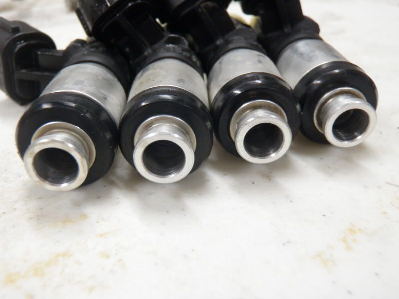

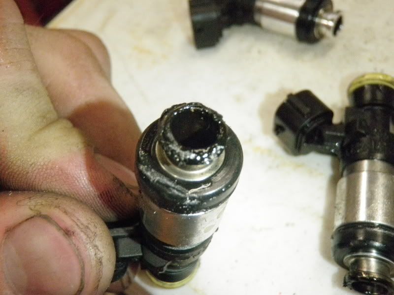

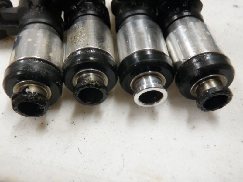

so i dont know if its discussed much on this forum but the black goo strikes again /ubbthreads/images/graemlins/smile.gif
Its caused from some additive they put in E85, some areas have it some dont, but its when the E atomizes out of the end of the injector some of the additive stays behind as this black goo / tar like substance.
here is what mine looked like after less then 2k miles. (ones cleaned for reference)

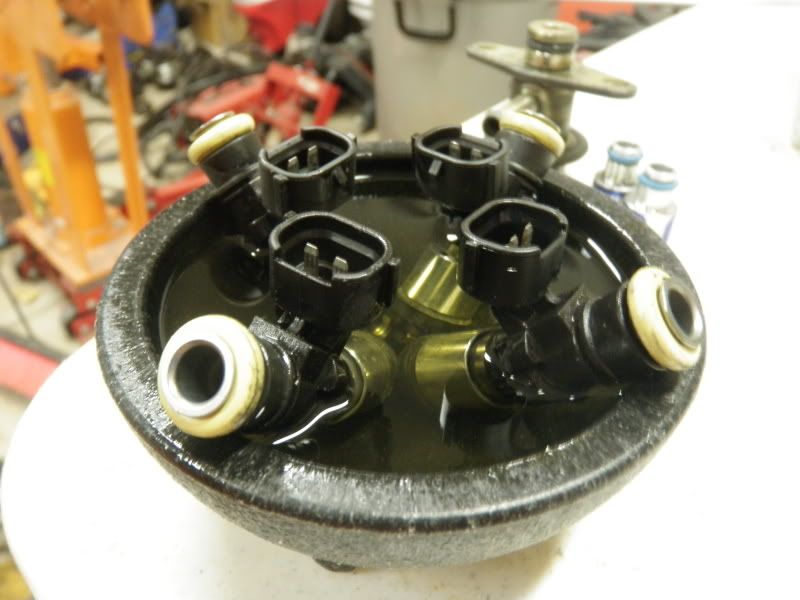

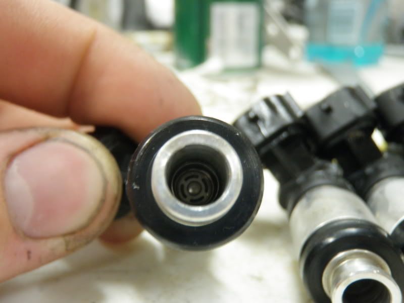

Gave em a little bath in some race gas
and good as new

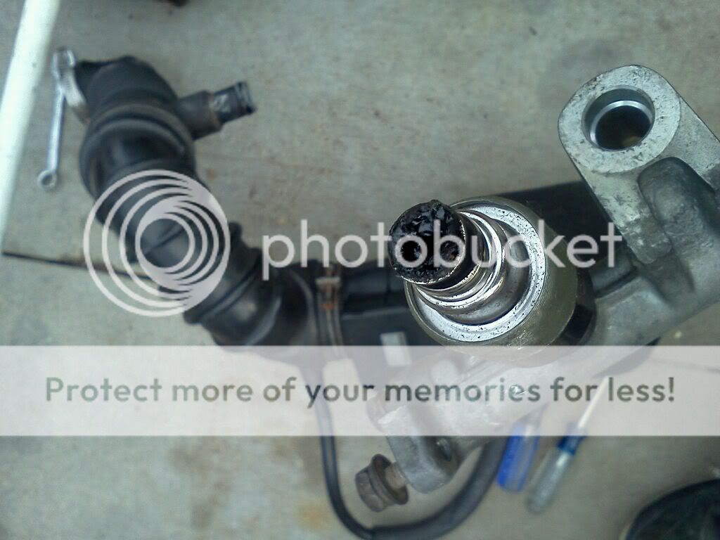

I've pulled my injectors to clean the "black tar" after running e-85 in my galant. Everybody says to run a tank of 91/93 pump gas every 3-4 tank fulls of e85 to clean out the injectors. I had a little studder at about 2500-3k rpms under regular driving. So anybody that has a little missfire and is running e85 I would clean the injectors.

do a google search for e85 blackbeard. First I saw of this was a sti that came into my buddies shop. The intake manifold had this crap built up in streaks after posting it here and getting some replies was able to research more.
