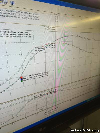

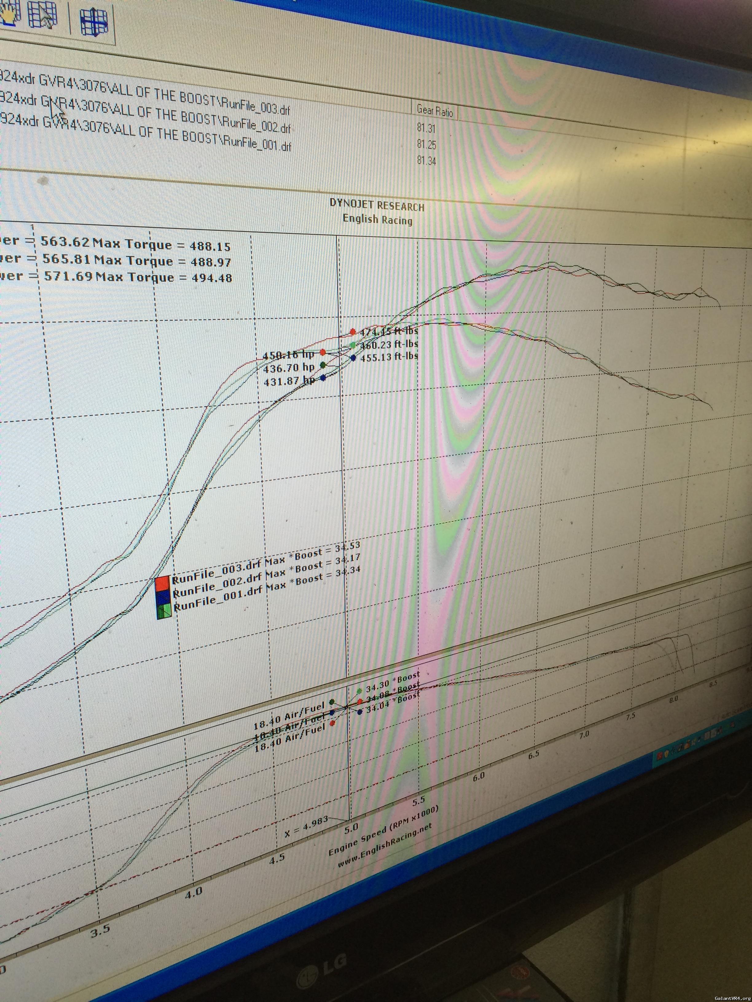

The result wasn't exactly what I was looking for, but it still did pretty well. Long story short, 571awhp, 495wtq, 40psi around 4,400RPM, peak torque around 5,600RPM.
FP says the HTA compressor is good for 40psi, so since I spent the time and money to get the car to where it would support that kind of power and fuel consumption, I wanted to see what the turbo would do.
The turbo is the DSM76, which is the HTA/billet version of the beloved 3052.
5 years ago, the car made 557awhpand 445ftlbs at 34psi. Since then, the only thing that has changed is I added a recirculated catch can, redid my intercooler piping, changed to high impedance fuel injectors, and put a ton of miles on the car with a couple near complete loss dissasters.
The turbo spooled just a hair later than before but made produced a better torque/power curve, but the power fell off on top more this time around. Like it did 5 years ago, it dropped to 29psi or so out past 8,000RPM.
Also, the highest HP pull came from what I though was an overly rich AFR at 11.5:1. I leaned it out to around 12:1 and power dropped a little. The car is on E98.
What's most impressive to me is the torque curve. It made 495ftlbs at 5,600RPM. 40psi came on around 4,400RPM.
This is a basic Eagle/Mahle 9:1 motor with a small plenum JMF intake manifold, FP turbo manifold, and ETS 4" intercooler, and ported head. The motor now has around 45k miles on it where the pulls I made 5 years ago had around 5k miles on it. I feel that the age, wear, and tear on the motor play a role in the lower than expected numbers for an added 6psi (or, the turbo was near maxed out 5 years ago at 34psi, which isn't exactly unbelievable), but 571awhp is pretty decent for a bolt on 30R in my opinion.

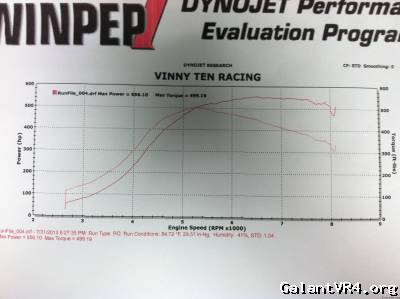

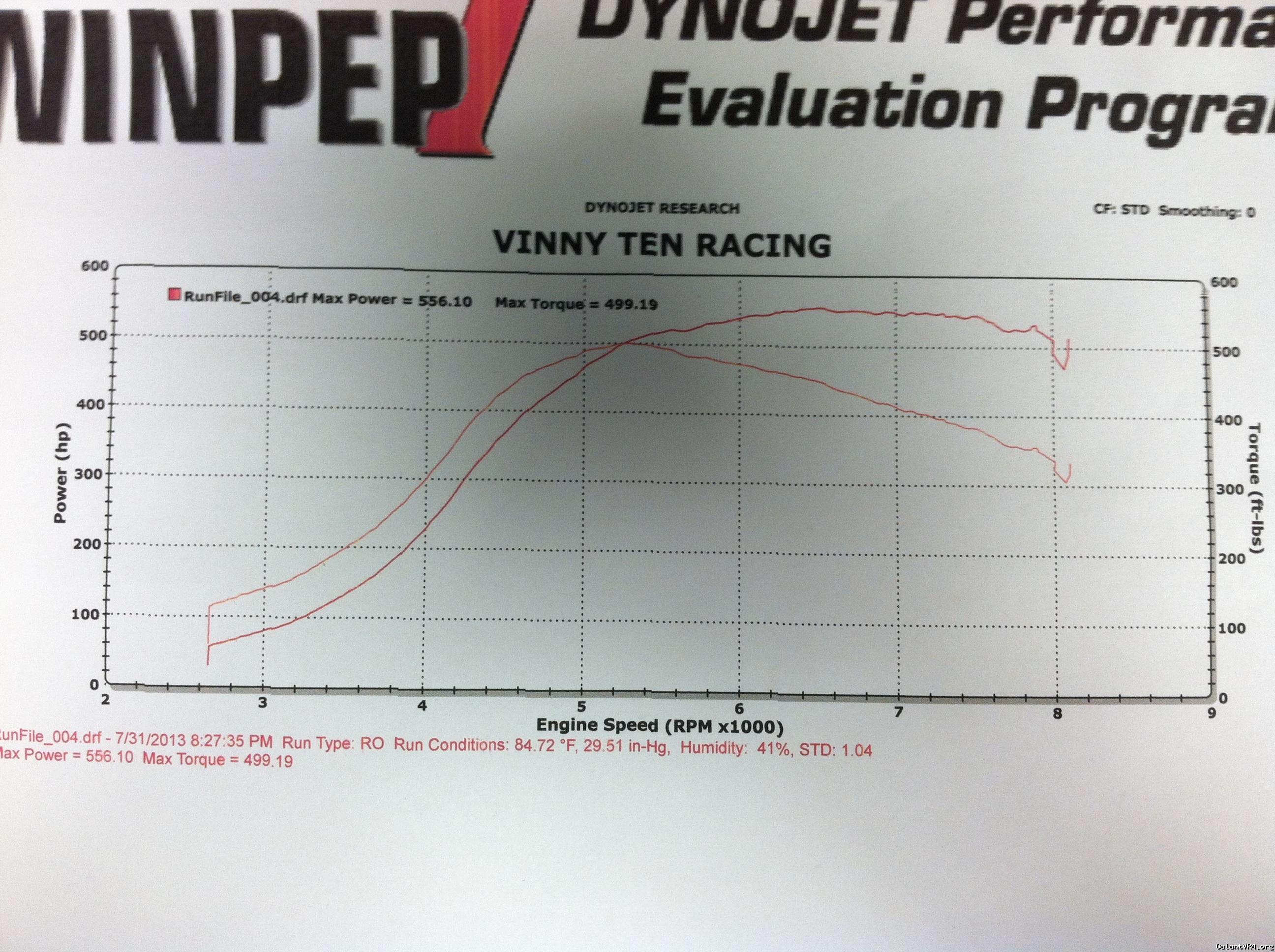

Good numbers !! Now let's see how it does on the track /ubbthreads/images/graemlins/devil.gif !! Just as a comparison my gray car has a simular setup - 9:1 Ross Pistons - eagle rods - 272/264 cams . The car has an old school fp3052 turbo running on e85 . Made 556whp / 499 torque at 30psi .
These little turbos can put down some power!!! In my opinion 30r turbos are awesome for everyday street fun- weekend warrior cars !!

Great numbers for a 3076 HTA I wonder if you could break 600 awhp with a .82 turbine housing. That turbo has to be fun on the streets if you ever go v band I have a Tial .82 ar housing for sale it might get you over 600, it'll be interesting to see.
I'm also curious what an HTA 3082 would do on your setup you'll probably lose some midrange power but you'll gain for top end. Very nice setup you have thanks for posting your results.

These runs were made with the tune I put together off the street. Based on how the motor responded to 1* of timing at 5,000RPM, I could probably get a better curve out of it.
I really do feel like the bolt on housing is choking it up top and a vband or T3 housing would make the 600hp.
556hp and 499tq from the 3052 at 30psi doesn't make me feel quite as good about my results.
I have a feeling that the half mile shift sector roll race would kill the car. I've already pushed my luck and want to keep the car together for the winter. I would be a very small fish in a big pond down in Coalinga. I'm thinking about going since the ETS GTR will be down there with its new forward facing big turbo setup, I believe its going on the rollers today.
I appreciate the offers, but I'm not all that confident a 3082 or 3065 would get me as far as I want. From what I've seen, the 3076 provides a better curve, although I would probably make that 600awhp I was chasing.

What are your goals if your just trying to reach 600 it "may" be possible with a housing and manifold change? If you want to autocross or track the car you have the perfect turbo for it.
If you want to pursue low quarter mile times you will probably have to step up to a bigger turbo. It all depends on what your goals are or you could just drive it as is and be content your making some good power. The number comparison from your setup and gizmos setup does leave some unanswered questions though. The housing and manifold seem like there working against you considering the boost level your at.
There was a thread on Link forums about when a 3065 stop making more power in its bolt on housing, I believe the number was around 34psi or so. Keep in mind it has a bigger compressor wheel than yours. Maybe you're also on a conservative tune.

I think your car makes great power. Nearly 600whp is awesome for a street car ! ! For the street these turbos are fast spooling responsive and fun !!Nate had my fp3052 on his 1g and went 10.7x with it in the 1/4 mile .... 431/1000 at full weight went 11.3@123 back in 2011and 584/1000 went 11.60@125 with a crappy launch. I think 584 if we put the effort in could go 10.9x on this turbo.
As for 30psi vs 40psi - we didn't push the turbo past 30psi because we felt the turbo was likely not going to make much more power - judging by how the power was starting to drop off after 7k rpm .
